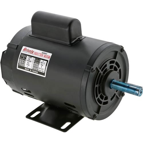

Grizzly G2901 - Motor 1/2 HP Single-Phase 1725 RPM Open 110V/220V
4.5 (24)
$235.00
G2901 1/2 HP Single-Phase 1725 RPM Open 110V/220V Motor
We are very pleased to offer this exceptionally high-quality replacement motor at a discount price.
Is your 1/2 HP motor tired and limping on its last legs? No need to buy an entire new woodworking machine, replace the motor!
Made to demanding specifications, these motors offer the same quality as the motors we install on our heavy-duty machines.
This Open Drip Proof motor (ODP) is for use in relatively clean environments.
This 1725 RPM motor has a NEMA 56 frame and is not for air compressor use.
The G2901 instruction sheet was written by our U.S.-based Technical Documentation Department and is packed with useful information.
  • Power: 1/2 HP
  • Type: ODP
  • Cycle: 60 Hz
  • Voltage: 110V/220V
  • Prewired: 110V
  • Amperage: 8A/4A
  • Phase: Single-phase
  • Speed: 1725 RPM
  • Class: E
  • Start capacitor: 200MFD 125VAC
  • Rotation: Reversible
  • U: 5/8"
  • N: 2.16"
  • Key: 3/16"
  • C: 10.68"
  • O: 7.49"
  • D: 3.15"
  • F: 2.95"
  • E: 4.92"
  • Open vent ODP motor
  • Reversible rotation
  • 1-year limited warranty
Note: See second photo with motor schematic breakdown.
