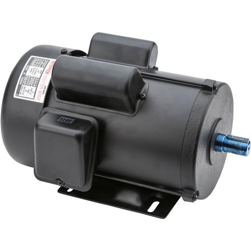

H5385 2 HP Single-Phase 3450 RPM TEFC 110V/220V Motor
We are very pleased to offer this heavy-duty single-phase replacement motor at a discount price.
Is your 2 HP motor tired and limping on its last legs? No need to buy an entire new woodworking machine, replace the motor!
If you have applications where dust, oil, chips, or other foreign particles are the norm rather than the exception, you should use a Totally Enclosed Fan-Cooled motor (TEFC).
This 3450 RPM motor has a NEMA 56 frame and is not for air compressor use.
The H5385 instruction sheet was written by our U.S.-based Technical Documentation Department and is packed with useful information.
  • Power: 2 HP
  • Type: TEFC
  • Cycle: 60 Hz
  • Voltage: 110V/220V
  • Prewired: 110V
  • Phase: Single-phase
  • Speed: 3450 RPM
  • Class: B
  • Rotation: Clockwise
  • U: 22mm
  • N: 1.30"
  • Key: 7mm
  • C: 15.68"
  • O: 13.43"
  • D: 3.50"
  • F: 4.88"
  • E: 5.00"
  • Totally Enclosed Fan-Cooled motor (TEFC)
  • Clockwise rotation
  • 1-year limited warranty
Note: See second photo with motor schematic breakdown.
