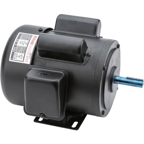

H5377 3/4 HP Single-Phase 1725 RPM TEFC 110V/220V Motor
We are very pleased to offer this exceptionally high-quality replacement motor at a discount price.
Is your motor tired and limping on its last legs? No need to buy an entire new woodworking machine, replace the motor!
If you have applications where dust, oil, chips, or other foreign particles are the norm rather than the exception, you should use a Totally Enclosed Fan-Cooled motor (TEFC).
This 1725 RPM motor has a NEMA 56 frame and is not for air compressor use.
The H5377 instruction sheet was written by our U.S.-based Technical Documentation Department and is packed with useful information.
  • Power: 3/4 HP
  • Type: TEFC
  • Cycle: 60 Hz
  • Voltage: 110V/220V
  • Prewired: 110V
  • Amperage: 9A/4.5A
  • Phase: Single-phase
  • Speed: 1725 RPM
  • Class: B
  • Start capacitor: 200MFD 125VAC
  • Run capacitor: 30MFD 125VAC
  • Rotation: Reversible
  • U: 5/8"
  • N: 1.94"
  • Key: 3/16"
  • C: 10.50"
  • O: 8.62"
  • D: 3.50"
  • F: 3.00"
  • E: 5.00"
  • Totally Enclosed Fan-Cooled motor (TEFC)
  • Reversible rotation
  • 1-year limited warranty
Note: See second photo with motor schematic breakdown.
