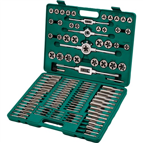

T34080 110-Piece SAE/Metric Combination Tap & Die Set
An economical steel alloy tap & die set.
Revive or create threads affordably with the T34080 Inch/Metric Combo set, crafted from a durable steel alloy. This budget-friendly alternative offers reliable performance while keeping costs in check.
The steel alloy has been treated for durability and resistance to wear, ensuring long-lasting sharpness. Its precision and versatility make this set a cost-effective choice for various threading applications, where dependable tool performance and value are paramount.
This 110-piece tap and die set includes popular SAE, metric, machine, and NPT sizes to achieve precision threading requirements for both internal and external threads. It includes both bottoming and plug taps, as well as the corresponding dies of the same size.
Plug taps feature a notable taper at the end, designed for a gradual entry into thread cutting, typically encompassing 3 to 5 tapered threads.
Bottoming taps have minimal taper at the end, as they are engineered to thread all the way to the bottom of their reach, with typically only 2 to 3 tapered threads.
The Dies come in two diameter sizes and have a 2 to 3 thread chamfer for threading on both sides.
For safekeeping and organization, this combination SAE/metric tap & die set comes in a convenient carrying case.
INCLUDES:
  • (35) Bottoming taps
  • (35) Plug taps
  • (22) 1" OD dies
  • (13) 1-1/2" OD dies
  • (1) 1/8"–1/2" (M3-M12) adjustable tap wrench
  • (1) 1/4"–3/4" (M6-M20) adjustable tap wrench
  • (1) 1" OD die stock
  • (1) 1-1/2" OD die stock
  • (1) T-handle tap wrench
  • Blow molded plastic carrying case
SIZES:
  • Standard: #4-40, #6-32, #8-32, #10-24, #10-32, #12-24, 1/4-20, 1/4-24, 1/4-28, 1/4-32, 5/16-18, 5/16-24, 3/8-16, 3/8-24, 7/16-14, 7/16-20, 1/2-13, 1/2-20, 9/16-12, 9/16-18, 5/8-11, 5/8-18, 3/4-10, 3/4-16
  • Metric: 6 x 1.0, 8 x 1.25, 10 x 1.0, 10 x 1.5, 11 x 1.5, 12 x 1.25, 12 x 1.75, 14 x 1.25, 18 x 1.5
  • Pipe thread: NPT 1/8-27, NPT 1/4-18
Standard: 1/4NC20, 1/4NS24, 1/4NS28, 1/4NF32 or 1/4-20 NC, 1/4-24 NS, 1/4-28 NS, 1/4-32NF
