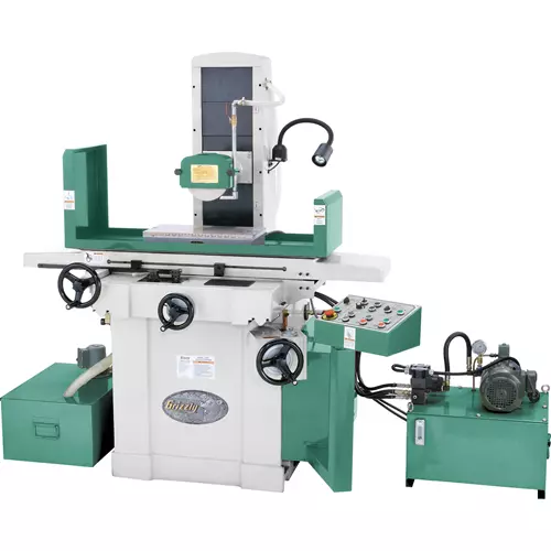

The latest addition to our line of Surface Grinders sports massive castings, a precision spindle and scraped combination Vee and flat ways needed for holding exacting tolerances and producing mirror like finishes. Add to that the silky smooth, automatic hydraulic control with infinitely variable stroke (200 1000 inches per minute), step-over (0 0.335")& down feed (0.0001" 0.001" steps) and you will find the ease of operation allows for tighter control over your production & products! It's as easy to setup as it is to use! All hydraulic lines control cables come supplied with one-way fittings making installation a breeze.
Features:Flood coolant system Column dial Cross feed dial Stone balancing kit Tool box Wheel dressing device 2-pc. T-bolt set Double spanner wrench Adjustable spanner wrench Cast iron construction
Specifications: Spindle motor: 3 HP, 3-phase, 220V, TEFC Hydraulic motor: 2 HP Coolant motor: 1/8 HP Crossfeed motor: 1/8 HP Table surface: 10" x 20" Maximum grinding area: 10" x 21-1/2" Longitudinal travel: 22-5/8" Cross travel: 11" Maximum distance table to spindle center: 21-1/16" T-slot and size: 1-1/2" stud, 7/8" head Grinding wheel: 8" D x 1-1/4" B x 1" W Table speed: 200" 1000"/min Vertical handwheel graduation: 0.0005" Vertical handwheel revolution: 0.1" Automatic downfeed increment: 0.0001" 0.001" Crossfeed handwheel graduation: 0.001" Crossfeed handwheel revolution: 0.2" Automatic crossfeed of saddle: 0 0.335" Overall dimensions: 75-5/8"H x 65"W x 59-7/8"D Column size: 9-1/4" x 12-3/4" Spindle diameter: 1-1/4" Spindle speed: 3,450 RPM Approximate shipping weight: 4334 lbs.
