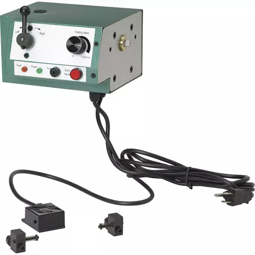

H8178 Power Feed for M1110/M1111
Power feed table movements improve milling efficiency.
The H8178 Power Feed provides precision powered longitudinal table movement for the M1110, M1111, G0463, G0619, and G0720R Mill/Drills.
The speed range is 0–1100 mm/min and the rapid speed feed option moves the table as full speed while being pressed.
The electronics of this accessory include a dual micro limit switch, circuit board, and automatic motor overload protection.
Like all Grizzly power feeds, the H8178 comes with a 1-year warranty which covers parts and assures the unit is free from factory defects.
The H8178 manual was written by our U.S. based Technical Documentation Department and is packed with useful information. The complete and easy-to-read manual provides full instructions on how to assemble and maintain your power feed.
The Grizzly Customer Service and Technical Support Teams are U.S. based. Parts for the power feed may be available online and shipped from the Grizzly parts warehouse in Springfield, MO.
  • Motor: 0.2 HP, 110V, single-phase, 1.8A
  • Speed: 4000 RPM
  • Power transfer: Gearbox with all steel gears
  • Motor control: Circuit board with rheostat
  • Overall dimensions: 7-3/4" W x 7-1/2" D x 5" H
  • Approximate shipping weight: 15 lbs.
  • Feed direction lever
  • Feed speed dial
  • Rapid feed button
