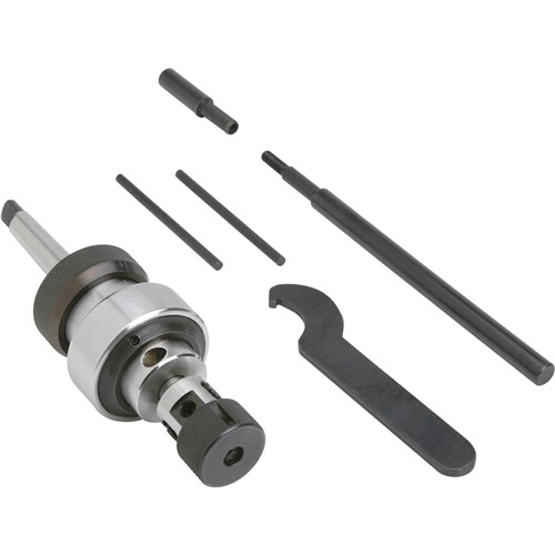

Grizzly T10057 - Tapping Attachment - MT #2
5.0 (2)
$235.00
Turn your drill press into a tapping machine. Adjustable internal clutch mechanism lets you tap 1/8" – 1/2" (M3 – M12) threads.
  • Arbor: MT#2
  • Jaw Type: 3-Jaw, Spring-Loaded
  • Maximum Speed: 700 RPM
  • Construction: High Carbon Steel
  • Steel Hardness: 46-56 HRC
  • Overall Length: 9" (225mm)
  • Stop Lever Length: 8-3/4" (220mm)
  • Reverse Type: Auto Reversing
  • Typical Concentricity: +/- 0.001"
  • Head Diameter: 2.750" (70mm)
  • Tapping Capacity (Metric): M3 to M12
  • Tapping Capacity (SAE): 1/8" to 1/2"
  • Drill Chuck Capacity: 13/32" (10mm)
