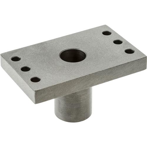

Use this Vise Adapter to convert your cross sliding vise into a vise table. Precision engineered to easily replace the table on our G7943 and G7944 drill presses - just slide the table out of its clamping bracket and slide the adapter in its place. Mounts directly to our Model G1064 Cross-Slide Vise. Size: 6"
Dimensions:
  • Post Diameter: 46mm
  • Post Length: 2.5"
  • Plate Length: 5-11/16"
  • Plate Width: 3-1/2"
  • Plate Thickness: 11/16"
  • Hole Spacing: 4-11/16"
  • Hole Centers: 1" on center
  • Center Hole: 1-5/32"
