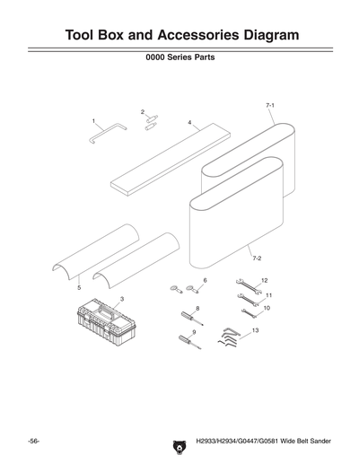

*DISCD*FELT PLATEN REMOVAL TOOL
LIMIT SWITCH CERAMIC TIP
TOOL BOX
$67.65
FELT PLATEN PAD 25"
GRAPHITE 25" X 3.54"
DOOR HANDLE
$25.65
SANDING BELT #100 25 X 60"
7-1
SANDING BELT #180 25 X 60"
7-2
SANDING BELT #180
PHLP HD SCREWDRIVER
Now: PSDF2
SCREWDRIVER FLAT #2
WRENCH 8 X 10MM OPEN-ENDS
WRENCH 12 X 14MM OPEN-ENDS
WRENCH 17 X 19MM OPEN-ENDS
HEX WRENCH SET
$10.30

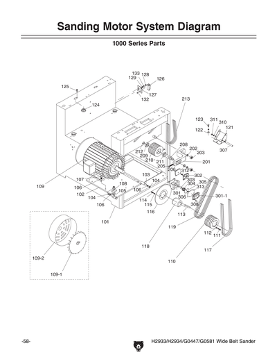

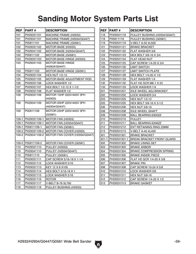

1101
MACHINE FRAME
1102
MOTOR BASE
1103
MOTOR BASE HINGE
$4.30
1104
Now: PN06
HEX NUT 1/2-12
1105
MOTOR BASE ADJUSTMENT ROD
$11.50
1106
Now: PLW07
LOCK WASHER 1/2
1107
Now: PB41
HEX BOLT 1/2-12 X 1-1/2
1108
Now: PW01
FLAT WASHER 1/2
1109
MOTOR 15HP 220V/440V 3HP
$1,328.25
1109-1
MOTOR FAN
1109-2
MOTOR FAN COVER
1110
PULLEY
1111
CAP SCREW 5/16-18 X 1-1/4
1112
Now: PLW01
LOCK WASHER 5/16
1113
KEY 8 X 12 X 105
$5.50
1114
Now: PB03
HEX BOLT 5/16-18 X 1
1115
Now: PLW01
LOCK WASHER 5/16
1116
DISC BRAKE
1117
Now: PVB76
V-BELT B76
1118
PULLEY BUSHING
1119
Now: PVA50
V-BELT A50
1121
BRAKE BRACKET
$50.75
1122
Now: PW02
FLAT WASHER 3/8
1123
Now: PB21
HEX BOLT 3/8-16 X 3/4
1124
FLAT HEAD NUT 5/8 X 11
$8.60
1125
CAP SCREW 1/4-20 X 3/4
1126
LIMIT SWITCH
$68.45
1127
LIMIT SWITCH PLATE
$13.05
1128
Now: PB19
HEX BOLT 1/4-20 X 1/2
1129
Now: PW06
FLAT WASHER 1/4
1132
FLAT HD SCR M6-1 X 25
1133
Now: PLW02
LOCK WASHER 1/4
1201
IDLE WHEEL ADJ BRACKET
$50.75
1202
Now: PLW10
LOCK WASHER 3/4
1203
Now: PN06
HEX NUT 1/2-12
1204
Now: PW13
FLAT WASHER 3/4
1205
Now: PB84
HEX BOLT 3/8-16 X 3-1/2
1206
Now: PN08
HEX NUT 3/8-16
1208
IDLE WHEEL SHAFT
$33.75
1209
BALL BEARING 6305ZZ
1210
PULLEY
$152.80
1211
BALL BEARING 6206ZZ
1212
Now: PR11M
EXT RETAINING RING 25MM
1213
Now: PVA40
V-BELT A40
1301
BRAKE BRACKET
$150.40
1301-1
BREAK BRACKET FRONT GUARD
$42.90
1302
BRAKE LINING SET
$71.90
1302-1
BRAKE LINING
1302-2
BRAKE LINING
1303
BRAKE ARBOR
$40.50
1304
BRAKE COMPRESSION SPRING
$4.85
1305
BRAKE INSIDE PIECE
$21.75
1306
Now: PFH04
FLAT HD SCR 1/4-20 X 5/8
1307
BRAKE PIN
1308
CAP SCREW 10-24 X 5/8
1310
Now: PLW04
LOCK WASHER 3/8
1311
Now: PN08
HEX NUT 3/8-16
1312
CAP SCREW 1/4-20 X 1/2
1313
BRAKE GASKET
$11.50

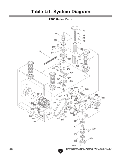

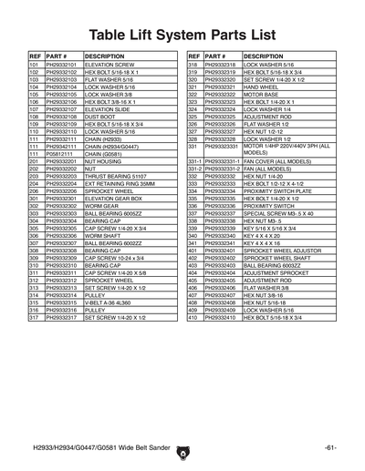

2101
ELEVATION SCREW 1 X 5 X 280
$179.70
2102
Now: PB03
2103
Now: PW07
FLAT WASHER 5/16
2104
Now: PLW01
LOCK WASHER 5/16
2105
Now: PLW04
LOCK WASHER 3/8
2106
Now: PB18
HEX BOLT 3/8-16 X 1
2107
ELEVATION SLIDE
$60.40
2108
DUST BOOT
$52.95
2109
Now: PB07
HEX BOLT 5/16-18 X 3/4
2110
Now: PLW01
LOCK WASHER 5/16
2111
CHAIN
$76.10
2201
NUT HOUSING
$20.70
2202
SPROCKET SHAFT
2203
THRUST BEARING 51107
2204
Now: PR12M
EXT RETAINING RING 35MM
2206
SPROCKET WHEEL
$21.75
2301
ELEVATION GEAR BOX
$86.40
2302
WORM GEAR
$53.95
2303
BALL BEARING 6005ZZ
2304
BEARING CAP
$35.05
2305
2306
WORM SHAFT
$53.95
2307
BALL BEARING 6002ZZ
2308
BEARING CAP
$40.50
2309
CAP SCREW 10-24 X 3/4
2310
BEARING CAP
$50.75
2311
CAP SCREW 1/4-20 X 5/8
2312
SPROCKET WHEEL
$51.35
2313
Now: PSS07
SET SCREW 1/4-20 X 1/2
2314
PULLEY
$76.10
2315
Now: PVA36
V-BELT A36
2316
PULLEY
$45.90
2317
Now: PSS07
2318
Now: PLW01
LOCK WASHER 5/16
2319
Now: PB07
2320
Now: PSS07
2321
HAND WHEEL
$71.90
2322
MOTOR BASE
$58.00
2323
Now: PB31
HEX BOLT 1/4-20 X 1
2324
Now: PLW02
LOCK WASHER 1/4
2325
$4.30
2326
Now: PW01
FLAT WASHER 1/2
2327
Now: PN06
HEX NUT 1/2-12
2328
Now: PLW07
LOCK WASHER 1/2
2331
MOTOR 1/4HP 220V/440V 3-PH
$243.95
2331-1
MOTOR FAN COVER
$10.90
2331-2
MOTOR FAN
$6.05
2332
Now: PN05
HEX NUT 1/4-20
2333
Now: PB89
HEX BOLT 1/2-12 X 4-1/2
2334
PROXIMITY SWITCH FIXING PLATE
$4.60
2335
Now: PB19
2336
PROXIMITY SWITCH
$112.25
2337
Now: PS97M
PHLP HD SCR M3-.5 X 34
2338
Now: PN07M
HEX NUT M3-.5
2339
Now: PK14
KEY 5/16 X 5/16 X 3/4
2340
Now: PK48M
KEY 4 X 4 X 20
2341
Now: PK37M
KEY 4 X 4 X 16

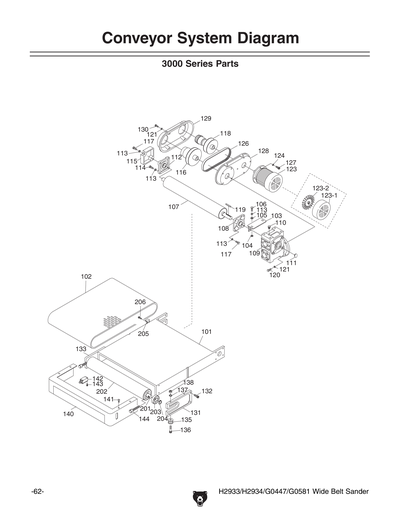

CONVEYOR TABLE
$1,622.35
3102
CONVEYOR BELT 2600 X 620
$851.75
3103
REDUCER FIX PLATE
$121.40
3104
CUSHION
$15.70
3105
Now: PLW04
LOCK WASHER 3/8
3106
Now: PB18
HEX BOLT 3/8-16 X 1
3107
OUTFEED ROLLER
3108
BEARING UCF206
3109
GEARBOX
$1,827.60
3110
BREATHER
$5.20
3111
PLUG
$2.10
3112
MOUNTED BEARING UCF205
3113
Now: PLW04
LOCK WASHER 3/8
3114
Now: PB95
HEX BOLT 1/2-12 X 3
3115
BEARING CAP
$35.65
3116
DRIVEN PULLEY
$320.65
3117
Now: PB16
HEX BOLT 3/8-16 X 1-1/2
3118
DRIVING PULLEY
3119
Now: PK66M
KEY 7 X 7 X 55
3120
Now: PB07M
HEX BOLT M8-1.25 X 25
3121
LOCK WASHER 8MM
3123
FEED MOTOR 1HP 220V/440V 3-PH
3123-1
MOTOR FAN COVER
3123-2
MOTOR FAN
3124
Now: PLW06
LOCK WASHER 5/8
3126
TIMING BELT
3127
CAP SCREW M10-1.5 X 25
3128
BASE PLATE
$166.15
3129
VARIABLE SPEED UNIT COVER
$166.15
3130
SET SCREW M8-1.25 X 20
3131
INFEED ROLLER BRACKET
$64.60
3132
3133
$64.60
3135
CONVEYOR BELT POSITIONING WHEEL
$26.00
3136
CAP SCREW 5/16-18 X 2
3137
Now: PLW01
LOCK WASHER 5/16
3138
Now: PN02
HEX NUT 5/16-18
3140
EMGNCY BRAKE PUSH-PLATE
$262.70
3141
Now: PS04
PHLP HD SCR 1/4-20 X 1/2
3142
LIMIT SWITCH
3143
Now: PS10
PHLP HD SCR 10-24 X 1-1/2
3144
Now: PB95
HEX BOLT 1/2-12 X 3

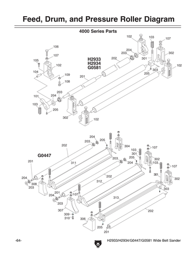

4101
PISTON SLIDE RAIL
$27.70
4102
PISTON BRACKET OUTER
$73.60
4103
SPRING 2 X 16 X 60
$9.05
4104
PIN 10 X 35MM
$3.05
4105
Now: PSS07
4106
Now: PB11
HEX BOLT 5/16-18 X 1-1/2
4107
Now: PN02
HEX NUT 5/16-18
4108
Now: PB12
HEX BOLT 5/16-18 X 1-1/4
4109
Now: PLW01
LOCK WASHER 5/16
4201
PISTON ROLLER SHAFT ASSY LONG
$434.70
4201-1
PISTON ROLLER SHAFT LONG
$91.20
4201A
PISTON ROLLER SHAFT ASSY SHORT MIDDLE
4201A-1

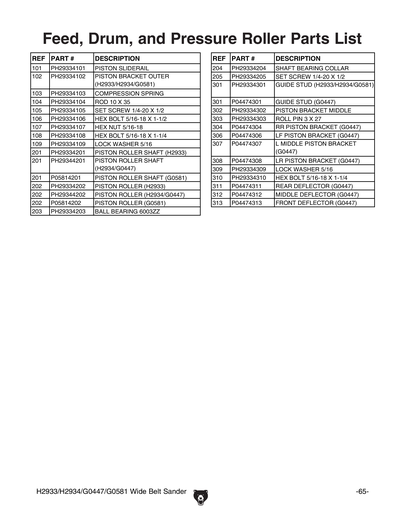

PISTON ROLLER SHAFT SHORT
4202
*DISCD*PISTON ROLLER
4203
Now: G3850
Bearing - 35mm x 17mm
4204
SHAFT BEARING COLLAR
$13.50
4205
Now: PSS07
4301
GUIDE STUD-SE 3/8-16 X 4-5/16 1-3/8
$11.50
4302
PISTON BRACKET MIDDLE
$80.95
4303
ROLL PIN 3 X 27
4309
Now: PLW01
LOCK WASHER 5/16
4310
Now: PB12

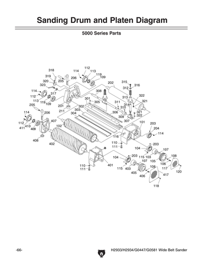

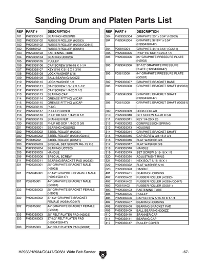

5101
BEARING HOUSING
$190.80
5102
RUBBER ROLLER
$1,219.00
5103
FASTENING TUBE
$53.95
5104
CARTRIDGE BEARING UCC206
5105
PULLEY
$106.90
5106
5107
Now: PK11
KEY 5/16 X 5/16 X 1-3/16
5108
Now: PLW01
LOCK WASHER 5/16
5109
BALL BEARING 6205ZZ
5110
Now: PLW07
LOCK WASHER 1/2
5111
CAP SCREW 1/2-12 X 1-1/2
5112
5113
BEARING CAP
$40.50
5114
STRAIGHT GREASE FITTING W/CAP
$2.90
5115
GREASE FITTING 90 DEG W/CAP
$2.25
5116
PLUG
$2.45
5117
PULLEY COVER
$50.75
5118
Now: PS04
5119
SPANNER NUT
$2.10
5120
Now: PS07
PHLP HD SCR 1/4-20 X 3/8
5201
BEARING HOUSING
$427.80
5202
STEEL ROLLER
$2,317.20
5203
SET SCREW M6-.75 X 6
$2.10
5204
CARTRIDGE BEARING UCC205
5205
HANDLE
$34.25
5206
FLAT HD SCR 5/8 X 11
5211
BEARING BRACKET PAD
$33.35
5301
GRAPHITE BRACKET 25" MALE
$135.00
5302
GRAPHITE BRACKET 25" FEMALE
5303
FELT PLATEN PAD 25"
$51.35
5304
$42.75
5305
Now: PS01
PHLP HD SCR 10-24 X 1/2
5306
GRAPHITE PRESSURE PLATE 25"
5307
GRAPHITE BRACKET BASE
$50.75
5308
GRAPHITE BRACKET SHAFT
$54.05
5309
FASTENING TUBE
$27.20
5310
Now: PSS03
SET SCREW 1/4-20 X 3/8
5311
KEY 1/4 X 1/4 X 25MM
5312
COMPRESSION SPRING 3.5 X 21 X 65
$4.60
5313
HOUSING
$35.65
5314
$26.00
5315
CAP SCREW 3/8-16 X 3/4
5316
Now: PW02
FLAT WASHER 3/8
5317
Now: PW02
FLAT WASHER 3/8
5318
HANDLE
$23.00
5319
Now: PSS08
SET SCREW 5/16-18 X 1/2
5320
ADJUSTMENT RING
$48.30
5321
Now: PB03
5322
Now: PW07
FLAT WASHER 5/16
5323
HANDLE
$34.25
5401
BEARING HOUSING
$188.70
5402
RUBBER ROLLER
$2,611.95
5403
FASTENING TUBE
$53.95
5404
5405
PULLEY
$125.05
5406

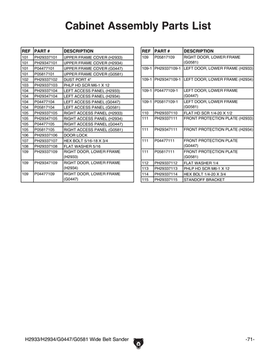

7101
UPPER FRAME COVER
7102
DUST PORT 4"
$22.50
7102-1
DUST PORT EXTENSION
$18.75
7103
Now: PS14M
PHLP HD SCR M6-1 X 12
7104
ACCESS PANEL LEFT
$428.10
7105
ACCESS PANEL RIGHT
$470.95
7106
DOOR LOCK
$42.85
7107
Now: PB07
7108
Now: PW07
FLAT WASHER 5/16
7109
DOOR RIGHT LOWER FRAME
7109-1
DOOR LEFT LOWER FRAME
$428.10
7110
Now: PFH03
FLAT HD SCR 1/4-20 X 1/2
7111
FRONT PROTECTION PLATE
$76.10
7112
Now: PW06
FLAT WASHER 1/4
7113
Now: PS14M
7114
Now: PB83M
HEX BOLT M6-1 X 16
7115
STANDOFF BRACKET
$27.20

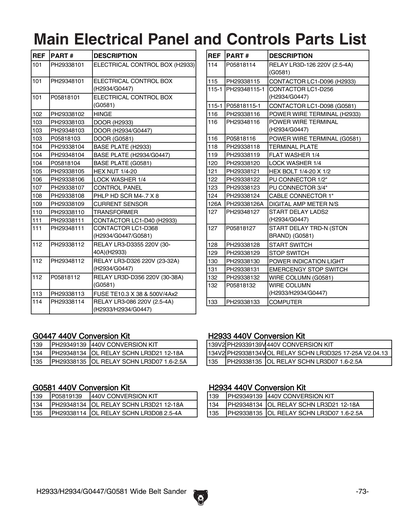

8101
*DISCD*ELECTRICAL CONTROL BOX
8102
HINGE
$10.30
8103
DOOR
$50.75
8104
BASE PLATE
$85.75
8105
Now: PN05
HEX NUT 1/4-20
8106
Now: PLW02
LOCK WASHER 1/4
8107
CONTROL PANEL
$67.40
8108
Now: PS07M
PHLP HD SCR M4-.7 X 8
8109
PROPORTIONAL CURRENT DEVICE
$49.55
8110
TRANSFORMER V1.04.05
$93.65
8110V2
TRANSFORMER 250VA 440V-200/220V
8111
*DISCD*CONTACTOR TELE LC1-D40 V1
8111V2
CONTACTOR SCHN LC1D40A V2.09.10
8112
*DISCD*OL RELAY TELE LR3-D3355 30-40A V1
$194.10
8112V2
OL RELAY TELE LR3-D340 30-40A V2.11.10
$100.25
8112V3
OL RELAY SCHN LRD340 30-40A V3.04.13
8113
***USE P0539013***
$59.90
8113V2
FUSE 4A V2.03.10
$45.90
8114
OL RELAY SCHN LR3D08 2.5-4A
$38.65
8115
CONTACTOR SCHN LC1D09 220V
$49.45
8115-1
CONTACTOR SCHN LC1D09 220V W/LOCK
8115L
8116
*DISCD*GROUND TERMINAL V1.04.05
8116V2
GROUND TERMINAL V2.03.10
$74.90
8117
Now: PS51M
PHLP HD SCR M4-.7 X 30
8118
TERMINAL PLATE V1.05.02
$68.85
8118V2
TERMINAL PLATE V2.03.10
$203.70
8119
Now: PW06
FLAT WASHER 1/4
8120
Now: PLW02
LOCK WASHER 1/4
8121
Now: PB19
8122
PU CONNECTOR 1/2"
$4.30
8123
PU CONNECTOR 3/4"
$10.90
8124
CABLE CONNECTOR 1"
$5.50
8126
AMP METER V1.03.03
$40.50
8126A
DIGITAL AMP METER V2.02.06
$90.00
8128-1
START SWITCH
8128-2
START SWITCH
$32.20
8129-1
E-STOP BUTTON 250V 10A
8129-2
BUTTON SWITCH, YK 10A 250V RED
8130
POWER INDICATOR LIGHT 220V 22MM WHT
8131
8132
WIRE COLUMN
$107.50
8133
COMPUTER W/CONTROL PANEL
$1,122.25
8134
RELAY TELE LR3D-3322 440V 17-25A V1
8134V2
OL RELAY SCHN LR3D325 17-25A V2.04.13
$142.60
8135
OL RELAY SCHN LR3D07 1.6-2.5A
8139
$124.40

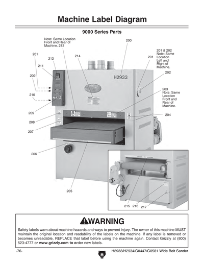

$9.10
9200
MODEL NUMBER LABEL
9201
DISCONNECT SANDER 220V 2W X 3.3H
9202
DONT OPEN 2W X 3.3H
9203
SANDER BELT PINCH 4W X 2.1H
9204
DUST MASK 2W X 3.3H V1
9205
EMERGENCY STRIPE LABEL
9207
9208
9209
CONTROL PANEL FACE LABEL
$12.00
9210
MM CONVERSION CHART 3.6W X 5.5H
9211
AMP SCALE LABEL
$1.50
9212
LOAD METER FACE LABEL
9213
FEED ONLY ONE 5.3W X 2.8H V2.04.08
9214
MACHINE DATA LABEL
9215
DANGER STRIPE LABEL
9216
PREWIRED FOR 220V LABEL
9217
ELECTRICITY 1.4W X 1.2H
