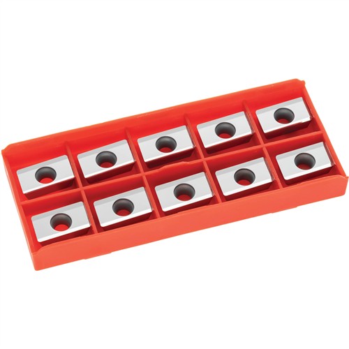

T34407 Harlingen® APKT Carbide Milling Inserts for Aluminum, 10-Pk.
Specifically designed for milling cutters, these carbide inserts are engineered to deliver exceptional finishing and high performance on aluminum. Their specialized geometry is crafted for precise milling applications.
As uncoated carbide inserts, their inherent properties create an extremely sharp and free-cutting edge to handle aluminum's unique characteristics. This ensures outstanding chip evacuation, virtually eliminates built-up edge (BUE), and results in a pristine surface finish. You'll achieve higher accuracy and reduced rework with these inserts, making them a cost-effective and highly effective solution for all your aluminum milling needs.
FITS:
  • T10388 Milling Cutter
  • T34461 Face Milling Cutter
  • Designation: APKT160408-NL
  • Manufacturer grade: HK434
  • Insert shape: Parallelogram
  • Insert size: 16mm I.C.
  • Insert thickness: 4.76mm
  • Nose radius: 0.8mm
  • Clearance angle: Positive
  • Chipbreaker: NL
  • Insert material: Carbide
  • Insert coating: Uncoated
  • Target materials: Aluminum
  • Quantity: 10
