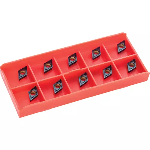

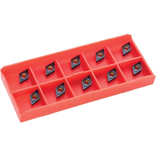

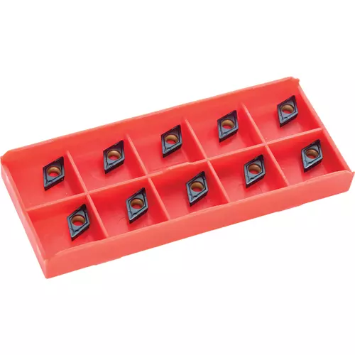

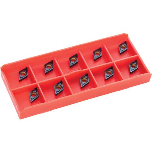

T34575 Harlingen® DCMT Carbide Inserts for Cast Iron, 10-Pk.
These DCMT 55° diamond carbide inserts are engineered for efficient turning, facing, and boring operations on cast iron. Designed with a positive geometry, they provide a clean-cutting action and offer two usable cutting edges for reliable material removal. They are compatible with standard tool holders designed for positive diamond inserts.
Each insert features a dual-layer defense of titanium carbonitride (TiCN) and aluminum oxide (Al2O3) coatings. This powerful combination delivers superior hardness, exceptional abrasion resistance, and excellent thermal stability, making them ideal for the challenging and abrasive characteristics of cast iron. This translates directly into increased productivity and significantly extended tool life.
These inserts provide a reliable and cost-effective solution, ensuring performance you can depend on.
FITS:
  • T10679 Lathe Tool Holder
  • T10680 Lathe Tool Holder
  • T10681 Lathe Tool Holder
  • T10682 Lathe Tool Holder
  • T10683 Lathe Tool Holder
  • T10684 Lathe Tool Holder
  • Designation: DCMT070204-SL1
  • Manufacturer grade: HC3215K
  • Insert shape: Diamond (Rhombic)
  • Insert angle: 55°
  • Clearance angle: 7° Positive
  • Tolerance class: M
  • Insert size: 6.35mm (1/4") I.C.
  • Insert thickness: 2.38mm (3/32")
  • Nose radius: 0.4mm
  • Chipbreaker: S1L
  • Insert material: Carbide
  • Insert coating: TiCN, Al2O3
  • Target materials: Cast iron
  • Quantity: 10
Upgrade your machining operations with these DCMT070204 carbide inserts.
