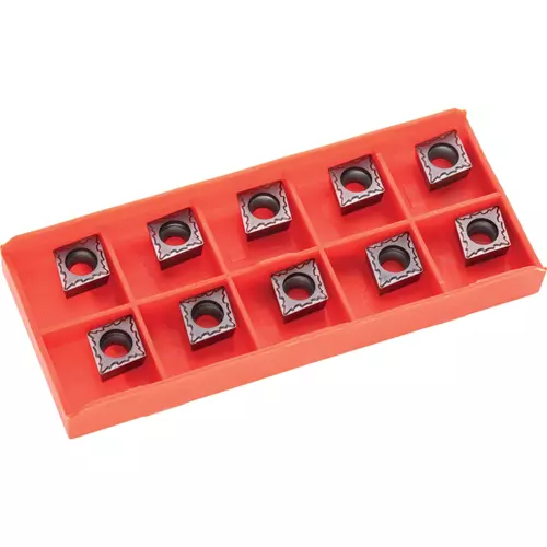

T34413 Harlingen® CCMT Carbide Inserts for Stainless Steel, 10-Pk.
Specifically designed for insert turning tool, indexable end mill, and boring bar sets, these carbide inserts are engineered to deliver robust performance and withstand the challenges of machining stainless steel.
Each insert is engineered with a dual-layer defense of titanium aluminum nitride (TiAlN) and titanium silicon nitride (TiSiN) coatings. This powerful combination delivers a significant boost in overall hardness, alongside exceptional abrasion and heat resistance. That translates directly into a longer cutting lifespan, less downtime, and ultimately, a more productive and cost-effective machining process.
These inserts provide a reliable and cost-effective solution, ensuring performance you can depend on.
FITS:
  • H5680 Insert Turning Tool Set
  • H5681 Insert Turning Tool Set
  • H5681 Indexable End Mill Set
  • T34455 Indexable Boring Bar Set
  • Designation: CCMT060204-NTM
  • Manufacturer grade: HP1215
  • Insert shape: Diamond (Rhombic)
  • Insert angle: 80°
  • Clearance angle: 7° Positive
  • Tolerance class: M
  • Insert size: 6.35mm (1/4") I.C.
  • Insert thickness: 2.38mm (3/32")
  • Nose radius: 0.4mm
  • Chipbreaker: NTM
  • Insert material: Carbide
  • Insert coating: TiAlN, TiSiN
  • Target materials: Stainless steel
  • Quantity: 10
Upgrade your machining operations with these CCMT060204 carbide inserts.
