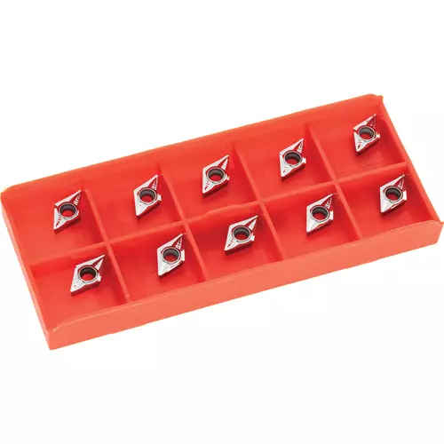

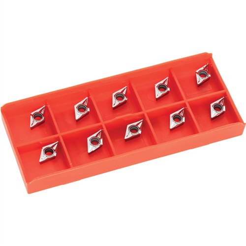

T34419 Harlingen® DCGX Carbide Inserts for Aluminum, 10-Pk.
Specifically designed for precise turning, facing, and boring, these carbide inserts provide exceptional finishing. They offer outstanding accuracy and a smooth surface finish of aluminum.
Experience precise and efficient aluminum machining with these uncoated carbide inserts. Their geometry combined with the lack of a coating creates an exceptionally sharp and free-cutting edge to handle aluminum's unique properties. This ensures excellent chip control and a pristine surface finish, making these inserts a cost-effective and highly effective solution for all your aluminum cutting needs.
FITS:
  • H8278 Boring Bar
  • H8279 Boring Bar
  • H8281 Boring Bar
  • Designation: DCGX070204-NL
  • Manufacturer grade: HK434
  • Shape: Diamond (Rhombic)
  • Angle: 55°
  • Clearance angle: 7° Positive
  • Tolerance class: Medium
  • Insert size: 6.35mm (1/4") I.C.
  • Insert thickness: 2.38mm (3/32")
  • Nose radius: 0.4mm
  • Chipbreaker: NL
  • Material: Carbide
  • Coating: Uncoated
  • Target materials: Aluminum
  • Quantity: 10
Upgrade your machining operations with these DCGX070204 carbide inserts.
