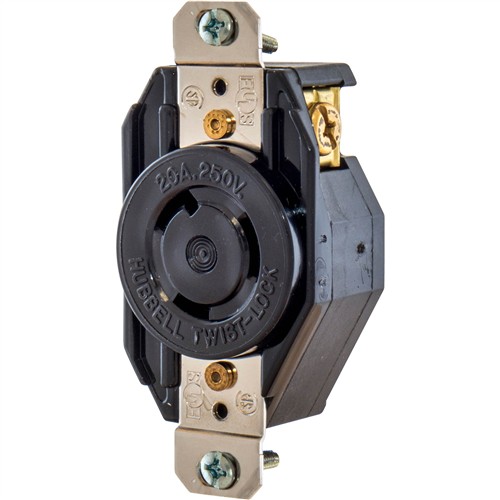

Hubbell T28418 - 20 Amp 250V NEMA L6-20 Single-Phase Twist Lock Receptacle
5.0 (5)
$24.95
  • Type: Single Receptacle
  • Standard: NEMA WD1 and WD5, UL 498
  • Voltage rating: 250V
  • Connection: Screw Terminals
  • Material: Thermoplastic
  • Amperage Rating: 20A
  • Number of Poles: 2
  • Number of Wires: 3
  • NEMA Rating: L6-20R
  • Wire Size: #14AWG to #12AWG
  • Mounting: Screw mount
  • Environmental Conditions: Indoor dry unless protected by additional means
  • Application: Heavy Duty
  • Color: Black
Features:
  • Visible NEMA ratings
  • Nickel plated receptacle strap
  • High impact-resistant chemical-resistant nylon face
  • Reinforced thermoplastic polyester base
  • Rivetless copper alloy contacts and blade
  • Nickel plated steel mounting yoke
  • Withstands 3000 V per UL498 dielectric voltage
  • 600 VAC or 250 VDC maximum working voltage
  • Capable of withstanding a fault level of 1000 A circuit, per UL 498
  • Maximum 30° C temperature rise at full rated current after 50 cycles overload at 150% rated current for either AC or DC applications per UL 498
  • Minimum 4.8 times rated current for 100 cycles overload
  • Terminals identified in accordance with UL 498 (Brass, White, Green)
  • 14 to 8 AWG solid or stranded copper wire
  • Ratings and NEMA identification are permanently marked on device
