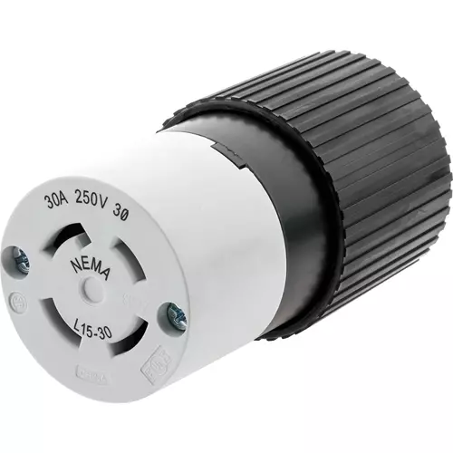

Image for Hubbell T28434 - 30 Amp 250V NEMA L15-30 3-Phase Twist Lock Connector
  • Type: Twist lock connector
  • Application: Heavy Duty
  • Standard: NEMA WD1 and WD5, UL498
  • Number of Poles: 3
  • Amp Rating: 30A
  • Voltage Rating: 3-phase 250 AC V
  • Material: Composite
  • NEMA Rating: L15-30R
  • Mounting: Cord mounted
  • Connection: Screw terminals
Features:
  • Supertough nylon body
  • Visible NEMA ratings
  • Captive assembly screws
  • Impact modified nylon blade/contact holder
  • High performance copper alloy contacts/blade
  • Withstands 3500 V per UL498 dielectric voltage
  • 600 VAC, 250 VDC maximum working voltage
  • Certified for current interrupting at full rated current
  • Minimum 4.8 times rated current for 100 cycles overload
  • Terminals identified in accordance with UL 498
  • 18 to 8 AWG flexible cord terminal accommodation
  • Ratings and NEMA identification are permanently marked on device
