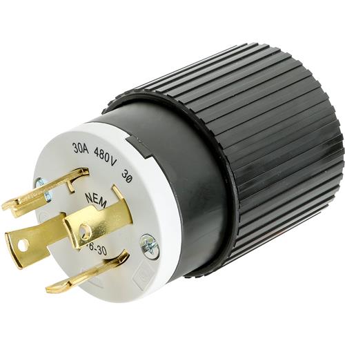

Image for Hubbell T28435 - 30 Amp 480V NEMA L16-30 3-Phase Twist Lock Plug
  • Type: Male plug, 3-phase
  • Standard: UL/CSA
  • Voltage rating: 480 AC V
  • Wattage: 14,400W
  • Connection: Terminal screw
  • Material: Composite
  • Amperage Rating: 30A
  • Number of Poles: 3
  • Number of Wires: 4
  • Wire size: #14AWG to #10AWG
  • NEMA Rating: L16-30P
  • Size: Standard
  • Mounting: Cord Mounted
  • Environmental Conditions: Indoor dry unless protected by additional means
  • Application: Power connection
  • Color: Black
Features:
  • Visible NEMA ratings
  • Captive assembly screws
  • Super tough nylon body
  • Impact modified nylon blade/contact holder
  • Brass contacts/blade
  • Withstands 3500 V per UL498 dielectric voltage
  • 600 VAC or 250 VDC maximum working voltage
  • Certified for current interrupting at full rated current
  • Maximum 30° C temperature rise at full rated current after 50 cycles overload at 150% rated current for either AC or DC applications per UL 498
  • Minimum 4.8 times rated current for 100 cycles overload
  • Terminals identified in accordance with UL 498 (Brass, White, Green)
  • 18 to 8 AWG flexible cord
  • Ratings and NEMA identification are permanently marked on device
