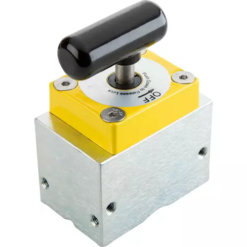

T26940 MagSquare 400
Provide a new level of fast and easy multiplane workholding when positioning steel.
The T26940 MagSquare 400 is an on/off magnetic work-holding square with 165 lb. (75 kg) of hold force from Magswitch Technology.
The MagSquare 400 is machined at 90° and has magnetic grip on 5 sides—strong on 3 sides.
The T26940 MagSquare 400 has on/off control, so there is no fighting the magnet for precise positioning.
This allows for super-fast set-ups and instant work-holding.
A benefit of that is that it stays clean; when the square is off, debris falls right off.
Unlike traditional magnetic squares that hold on to metal chips even when off, with Magswitch you won’t cut your fingers cleaning away steel debris.
There is a pipe notch so it can grip pipe for better versatility.
Attach to your own fabrication jigs with M5 x 0.8 fasteners.
