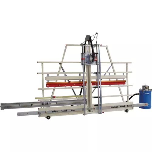

T33599 Safety Speed H6 Vertical Panel Saw
This saw offers full-sized vertical panel saw productivity in an economical machine.
The T33599 Safety Speed H6 Vertical Panel Saw provides a 74" crosscut, ideal for cutting a 10' x 6' piece of material, up to 1.75" thick while only occupying 30 square feet of floor space.
Unlimited length ripcuts are made possible by rotating the saw head allowing you to lock it in place at 90 degree increments for performing rip (horizontal) or crosscuts (vertical).
Photos are shown with a stand and wheels which are optional accessories.
Contact Safety Speed regarding technical support and their manufacturer warranty.
CSA certified
Please note: This item has a lead time of two weeks from time of order.
Due to product size, this item must be delivered to a loading dock or unloaded with a forklift. Liftgate service is not available.
Orders shipping outside of the lower 48 states will require a special quote.
  • Weight: 359 lbs.
  • Dimensions: 120" x 11" x 95"
  • Maximum crosscut: 74"
  • Maximum rip cut: Unlimited
  • Cut Depth: 1-3/4"
  • Frame length: 120"
  • Saw blade diameter: 8"
  • Motor amps and volts: 15 amps, 120V
Features:
  • Milwaukee Tool motor
  • Zinc plated 1 ¾”steel guide tubes
  • 4 Nylatron roller bearing system
  • Adjustable vertical and horizontal rulers
  • Quick change from vertical to horizontal cutting
  • Thin material pressure guard
  • Injection-molded plastic material rollers
  • Spring loaded counter balance system
  • Integrated dust collection bonnet
