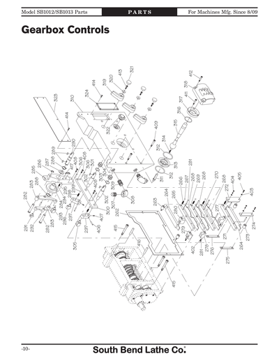

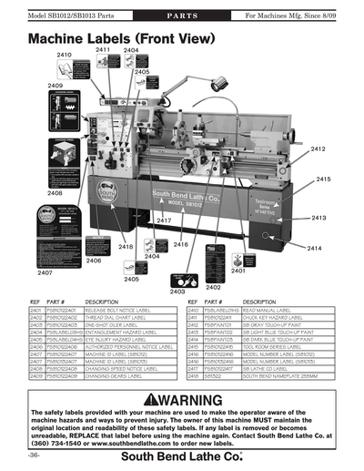

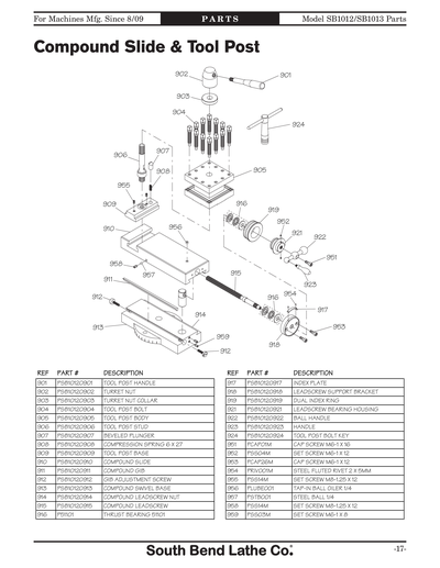

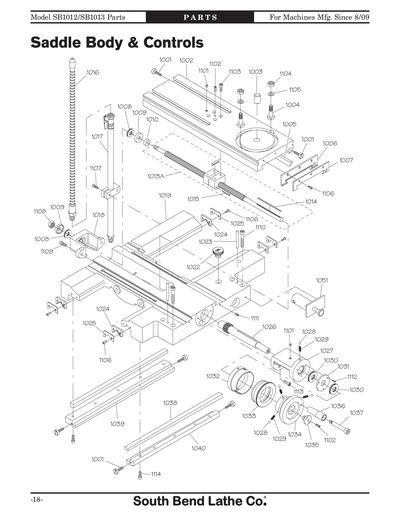

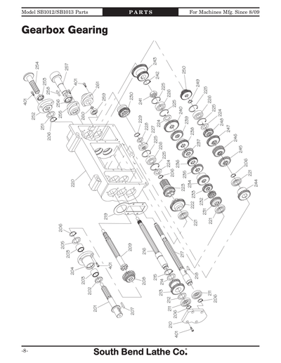

Ref #
Part #
Description

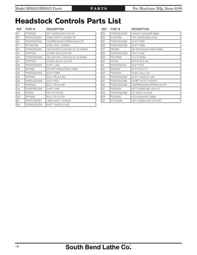

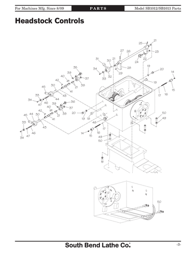

PSB10130001
OIL FILL PLUG
PSB10130002
CAP SCREW M6-1 X 40
PSB10130003
HEADSTOCK COVER
PSB10130004
COVER OIL SEAL M4 X 1700
PSB10130005
CAP SCREW M5-.8 X 10
PSB10130006
PIPE CLIP 5MM
PSB10130007
CAP SCREW M5-.8 X 20
PSB10130008
FLAT HD SCR M5-.8 X 8
PSB10130009
OIL DISTRIBUTOR A-5S
PSB10130009-1
OIL DISTRIBUTOR BRACKET
PSB10130010
PIPE JOINT
PSB10130011
NYLON TUBE
PSB10130012
HEADSTOCK CONTROL PLATE
PSB10130013
PSB10130014
SET SCREW M10-1.5 X 10
PSB10130015
THREADED PLUG M10-1.5
PSB10130016
COMPRESSION SPRING M8 X 37
PSB10130017
STEEL BALL 8.5MM
PSB10130018
HEADSTOCK CASTING PLUG 20MM
PSB10130019
O-RING 13.8 X 2.4 P14
PSB10130020
HEADSTOCK CASTING PLUG 18MM
PSB10130021
O-RING 20.8 X 2.4 P21
PSB10130022
SHIFT CAM
PSB10130023
EXT RETAINING RING 12MM
PSB10130024
SHIFT FORK
PSB10130025
ROLL PIN 6 X 36
PSB10130026
SHIFT ROD
PSB10130027
ROLL PIN 6 X 40
PSB10130028
SHIFT CAM
PSB10130029
KEY 5 X 5 X 22
PSB10130030
ROLL PIN 3 X 25
PSB10130031
LONG SHIFT HANDLE
PSB10130032
SHIFT HANDLE HUB
PSB10130033
HANDLE WASHER 6MM
PSB10130034
CAP SCREW M6-1 X 16
PSB10130035
SHIFT FORK
PSB10130036
SHIFT FORK
PSB10130037
EXT RETAINING RING 15MM
PSB10130038
SHIFT CAM
PSB10130039
E-CLIP 8MM
PSB10130040
KEY 5 X 5 X 30
PSB10130041
SHIFT ROD
PSB10130042
KEY 5 X 5 X 17
PSB10130043
STEEL BALL 1/4
PSB10130044
SHIFT HANDLE HUB
PSB10130045
SHORT SHIFT HANDLE
PSB10130046
COMPRESSION SPRING 6 X 27
PSB10130047
SET SCREW M8-1.25 X 8
PSB10130048
OIL SIGHT GLASS
PSB10130049
LOCK WASHER 12MM
PSB10130050
CAP SCREW M12-1.75 X 40

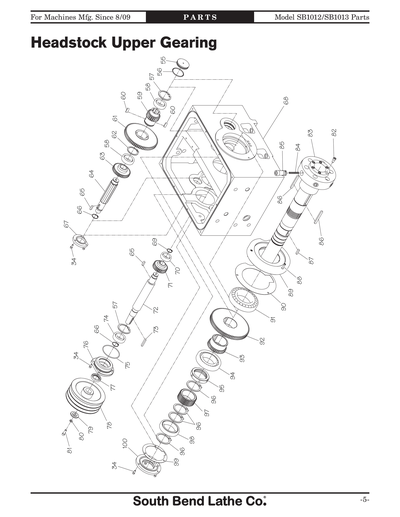

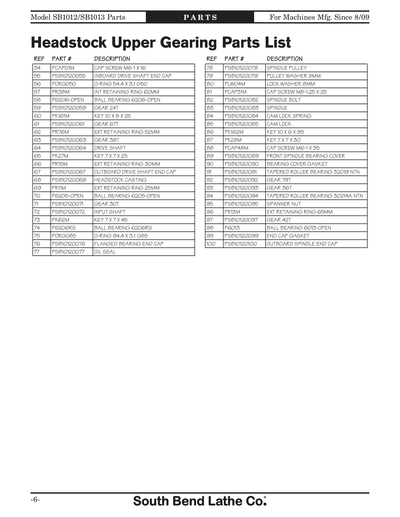

PSB10130055
INBOARD DRIVE SHAFT END CAP
PSB10130056
O-RING 49.4 X 3.1 G50
PSB10130057
INT RETAINING RING 62MM
PSB10130058
BALL BEARING 6206-OPEN
PSB10130059
DRIVE SHAFT W/24T & 67T GEARS
PSB10130060
KEY 10 X 8 X 25
PSB10130061
PSB10130062
EXT RETAINING RING 52MM
PSB10130063
GEAR 38T
PSB10130064
PSB10130065
KEY 7 X 7 X 25
PSB10130066
EXT RETAINING RING 30MM
PSB10130067
OUTBOARD DRIVE SHAFT END CAP
PSB10130068
HEADSTOCK CASTING
PSB10130069
EXT RETAINING RING 25MM
PSB10130070
BALL BEARING 6205-OPEN
PSB10130071
GEAR 30T
PSB10130072
INPUT SHAFT
PSB10130073
KEY 7 X 7 X 45
PSB10130074
BALL BEARING 6206RS
PSB10130075
O-RING 84.4 X 3.1 G85
PSB10130076
FLANGED BEARING END CAP
PSB10130077
OIL SEAL
PSB10130078
SPINDLE PULLEY
PSB10130079
PULLEY WASHER 8MM
PSB10130080
LOCK WASHER 8MM
PSB10130081
CAP SCREW M8-1.25 X 25
PSB10130082
SPINDLE BOLT
PSB10130083
SPINDLE
PSB10130084
CAM LOCK SPRING
PSB10130085
CAM LOCK
PSB10130086
KEY 10 X 6 X 85
PSB10130087
KEY 7 X 7 X 29
PSB10130088
CAP SCREW M6-1 X 35
PSB10130089
FRONT SPINDLE BEARING COVER
PSB10130090
BEARING COVER GASKET
PSB10130091
TAPERED ROLLER BEARING 32019 NTN
PSB10130092
GEAR 79T
PSB10130093
GEAR 36T
PSB10130094
TAPERED ROLLER BEARING 30214A NTN
PSB10130095
SPANNER NUT
PSB10130096
EXT RETAINING RING 65MM
PSB10130097
GEAR 42T
PSB10130098
BALL BEARING 6013ZZ
PSB10130099
END CAP GASKET
PSB10130100
OUTBOARD SPINDLE END CAP
PSB10130105
GEAR FENDER WASHER 6MM
PSB10130106
GEAR 21T
PSB10130107
GEAR 42T
PSB10130108
KEY 6 X 6 X 15
PSB10130109
EXT RETAINING RING 35MM
PSB10130110
PSB10130111
GEAR SHAFT
PSB10130112
GEAR SHAFT WASHER 6MM
PSB10130113
GEAR 42T
PSB10130114
GEAR SLEEVE 21T
PSB10130115
O-RING SPACER
PSB10130116
GEAR SHAFT
PSB10130117
EXT RETAINING RING 20MM
PSB10130118
DOUBLED ENDED GEAR 12T/21T
PSB10130119
GEAR SHAFT
PSB10130120
GEAR 21T
PSB10130121
SPLINE SHAFT SPACER
PSB10130122
NEEDLE BEARING RNA-6904
PSB10130123
SPLINE SHAFT
PSB10130124
O-RING 43.7 X 3.5 P44
PSB10130125
PSB10130126
CAP SCREW M6-1 X 12
PSB10130127
OIL SEAL 28 X 44 X 7
PSB10130128
SQUARE HEAD DRAIN PLUG 1/2 PT

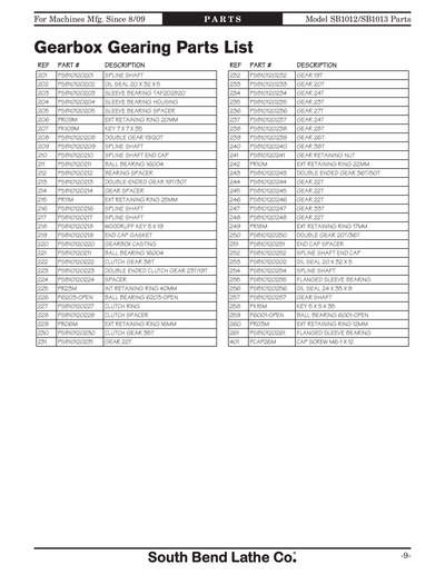

PSB10130201
SPLINE SHAFT
PSB10130202
OIL SEAL 20 X 32 X 5
PSB10130203
SLEEVE BEARING TAF202820
PSB10130204
SLEEVE BEARING HOUSING
PSB10130205
SLEEVE BEARING SPACER
PSB10130206
PSB10130207
KEY 7 X 7 X 35
PSB10130208
DOUBLE GEAR 19/20T
PSB10130209
SPLINE SHAFT
PSB10130210
SPLINE SHAFT END CAP
PSB10130211
BALL BEARING 16004
PSB10130212
BEARING SPACER
PSB10130213
DOUBLE-ENDED GEAR 19T/30T
PSB10130214
GEAR SPACER
PSB10130215
PSB10130216
SPLINE SHAFT
PSB10130217
SPLINE SHAFT
PSB10130218
WOODRUFF KEY 5 X 19
PSB10130219
END CAP GASKET
PSB10130220
GEARBOX CASTING
PSB10130221
BALL BEARING 16004
PSB10130222
CLUTCH GEAR 38T
PSB10130223
DOUBLE ENDED CLUTCH GEAR 23T/19T
PSB10130224
SPACER
PSB10130225
INT RETAINING RING 40MM
PSB10130226
BALL BEARING 6203-OPEN
PSB10130227
CLUTCH RING
PSB10130228
CLUTCH SPACER
PSB10130229
EXT RETAINING RING 16MM
PSB10130230
CLUTCH GEAR 35T
PSB10130231
GEAR 22T
PSB10130232
GEAR 19T
PSB10130233
GEAR 20T
PSB10130234
GEAR 24T
PSB10130235
GEAR 23T
PSB10130236
GEAR 27T
PSB10130237
GEAR 24T
PSB10130238
GEAR 28T
PSB10130239
GEAR 26T
PSB10130240
GEAR 38T
PSB10130241
GEAR RETAINING NUT
PSB10130242
EXT RETAINING RING 22MM
PSB10130243
DOUBLE ENDED GEAR 36T/50T
PSB10130244
GEAR 22T
PSB10130245
GEAR 22T
PSB10130246
GEAR 22T
PSB10130247
GEAR 33T
PSB10130248
GEAR 22T
PSB10130249
EXT RETAINING RING 17MM
PSB10130250
DOUBLE GEAR 20T/36T
PSB10130251
END CAP SPACER
PSB10130252
PSB10130253
PSB10130254
SPLINE SHAFT
PSB10130255
FLANGED SLEEVE BEARING
PSB10130256
OIL SEAL 24 X 35 X 8
PSB10130257
GEAR SHAFT
PSB10130258
KEY 5 X 5 X 35
PSB10130259
BALL BEARING 6001-OPEN
PSB10130260
PSB10130261
PSB10130262
GEARBOX COVER GASKET
PSB10130263
PARTITION NUT
PSB10130264
UPPER PLATE
PSB10130265
UPPER FORK SUPPORT
PSB10130266
COMPRESSION SPRING 4 X 19
PSB10130267
STEEL BALL 1/4
PSB10130268
PARTITION
PSB10130269
MIDDLE FORK SUPPORT
PSB10130270
LOWER FORK SUPPORT
PSB10130271
BOTTOM FORK SUPPORT
PSB10130272
REVERSE STOP PLATE
PSB10130273
PARTITION SPACER
PSB10130274
SHOULDER PLATE
PSB10130275
LEFT CONNECTOR PLATE
PSB10130276
RIGHT CONNECTOR PLATE
PSB10130277
BOTTOM FORK
PSB10130278
LOWER FORK
PSB10130279
MIDDLE FORK
PSB10130280
BOTTOM FORK
PSB10130281
ROLL PIN 3 X 16
PSB10130282
CONNECTOR PIN
PSB10130283
PIVOT ARM
PSB10130284
CAM
PSB10130285
SHIFT BRACKET
PSB10130286
E-CLIP 8MM
PSB10130287
BRACKET SPACER
PSB10130288
PSB10130289
WOODRUFF KEY 4 X 13
PSB10130290
SHIFT ROD
PSB10130291
STOP BLOCK
PSB10130292
DOWEL PIN 5 X 24MM
PSB10130293
RIGHT SHIFT FORK
PSB10130294
STEEL BALL 1/4
PSB10130295
COMPRESSION SPRING 6.25 X 18
PSB10130296
STOP BLOCK
PSB10130297
SHIFT ROCKER ARM
PSB10130298
COMPRESSION SPRING 6 X 13
PSB10130299
STEEL BALL 1/4
PSB101303-001
*DISCD*TRANSFORMER,CONTROL
PSB101303-004
*DISCD*TRANSFORMER,3KVA
PSB101303-008
*DISCD*TRANSFORMER,1.5 KVA
PSB101303-009
*DISCD*TRANSFORMER, 1.5KVA
PSB101303-010
*DISCD*TRANSFORMER, .500KVA
PSB10130300
SHIFT SHAFT SUPPORT BAR
PSB10130301
WOODRUFF KEY 4 X 13
PSB10130302
SHIFT SHAFT
PSB10130303
O-RING 17.8 X 2.4 P18
PSB10130304
SHIFT SHAFT SLEEVE
PSB10130305
SHIFT FORK
PSB10130306
ROLL PIN 5 X 16
PSB10130307

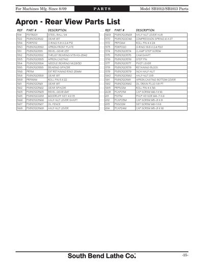

PSB10130308
PIPE ELBOW 90 DEG 1/2 X 1/2 PT
PSB10130309
PIPE NIPPLE 1/2 X 1/2 PT X 1"
PSB10130310
GEARBOX COVER
PSB10130311
SELECTOR ROD
PSB10130312
O-RING 39.4 X 3.1 G40
PSB10130313
SELECTOR LEVER SUPPORT
PSB10130314
COMPRESSION SPRING 9 X 38
PSB10130315
SELECTOR LEVER
PSB10130316
O-RING 3.1 X 29.4 G30
PSB10130317
SELECTOR LEVER END CAP
PSB10130318
SELECTOR PLATE
PSB10130319
SHIFTING HANDLE
PSB10130320
PSB10130321
HANDLE CAP
PSB10130322
OIL SIGHT GLASS
PSB10130323
GEARBOX FRONT COVER PLATE
PSB10130324
FEED CLUTCH COVER
PSB10130401
CAP SCREW M6-1 X 12
PSB10130402
PSB10130403
LOCK WASHER 6MM
PSB10130404
CAP SCREW M6-1 X 12
PSB10130405
CAP SCREW M6-1 X 35
PSB10130406
ROLL PIN 4 X 24
PSB10130407
SET SCREW M6-1 X 8
PSB10130408
CAP SCREW M6-1 X 20
PSB10130409
CAP SCREW M6-1 X 70
PSB10130411
CAP SCREW M5-.8 X 25
PSB10130412
CAP SCREW M6-1 X 12
PSB10130413
CAP SCREW M5-.8 X 12
PSB10130414
PHLP HD SCR M4-.7 X 6
PSB10130415
CAP SCREW M8-1.25 X 65
PSB10130416
TAPER PIN #3/#7 X 1/4"
PSB10130417
SHIFT BRACKET SET SCREW
PSB10130501
DOUBLE GEAR 18T/60T
PSB10130502
WASHER
PSB10130503
ROLL PIN 4 X 22
PSB10130504
DOUBLE GEAR 81T/60T
PSB10130505
DOWEL PIN 4 X 17MM
PSB10130506
DOUBLE GEAR 72T/60T
PSB10130507
SLEEVE BEARING
PSB10130508
BRACKET PLUG
PSB10130509
FEED CONTROL BRACKET
PSB10130510
OIL CUP
PSB10130511
SPLINE SHAFT
PSB10130512
FEED CONTROL HANDLE
PSB10130513
FEED CONTROL WORM
PSB10130514
STEEL BALL 1/4
PSB10130515
COMPRESSION SPRING 6 X 16
PSB10130516
GEAR SHAFT
PSB10130517
KEY 5 X 5 X 18
PSB10130518
INCH GEAR 81T
PSB10130519
ROLL PIN 5 X 36
PSB10130520
OIL SIGHT GLASS
PSB10130521
PSB10130522
GEAR 18T
PSB10130523
PSB10130524
GEAR SHAFT
PSB10130525
ROLL PIN 4 X 24
PSB10130526
FEED DIRECTION PIVOT ARM
PSB10130527
FEED DIRECTION SHAFT
PSB10130528
O-RING 15.8 X 2.4 P16
PSB10130529
O-RING 25.7 X 3.5 P26
PSB10130530
FEED DIRECTION SHAFT SLEEVE
PSB10130531
FEED DIRECTION KNOB
PSB10130532
DIRECTION PLATE
PSB10130534
O-RING 11.8 X 2.4 P12
PSB10130535
GEAR SHAFT
PSB10130537
PSB10130538
SUPPORT BRACKET
PSB10130539
GEAR SHAFT 18T
PSB10130540
WOODRUFF KEY 5 X 19
PSB10130541
INCH GEAR SHAFT SLEEVE
PSB10130542
INCH INDEX RING
PSB10130544
PSB10130545
HANDWHEEL
PSB10130546
HANDWHEEL WASHER 6MM
PSB10130547
HANDWHEEL HANDLE
PSB10130548
HANDLE CAP SCREW
PSB10130549
SAFETY PLATE
PSB10130550
APRON FRONT PLATE
PSB10130551
BEVEL GEAR 23T
PSB10130552
THRUST BEARING NTB/AS-2542
PSB10130553
APRON CASTING
PSB10130554
NEEDLE BEARING NK29/30
PSB10130555
BEARING SPACER
PSB10130556
PSB10130558
GEAR 18T
PSB10130559
ROLL PIN 5 X 22
PSB10130561
GEAR 18T
PSB10130562
GEAR SPACER
PSB10130563
BEVEL GEAR 64T
PSB10130565
WOODRUFF KEY 4 X 13
PSB10130566
HALF-NUT LEVER SHAFT
PSB10130567
OIL FENCE
PSB10130568
HALF-NUT LEVER
PSB10130569
HALF-NUT LEVER HUB
PSB10130570
PSB10130572
ROLL PIN 4 X 24
PSB10130573
O-RING 19.8 X 2.4 P20
PSB10130574
CLAMP STEP SCREW
PSB10130575
CAM SHAFT
PSB10130576
STEP PIN
PSB10130577
PIVOT LEVER
PSB10130578
RETAINING BLOCK
PSB10130579
INCH HALF-NUT
PSB10130580
HALF-NUT GIB
PSB10130581
APRON CASTING BOTTOM COVER
PSB10130582
OIL DRAIN PLUG 1/8 PT
PSB10130583
ROLL PIN 4 X 36
PSB10130601
SET SCREW M5-.8 X 6
PSB10130602
CAP SCREW M5-.8 X 35
PSB10130603
PSB10130604
PSB10130605
FLAT WASHER 6MM
PSB10130606
CAP SCREW M6-1 X 25
PSB10130607
SET SCREW M6-1 X 25
PSB10130608
CAP SCREW M6-1 X 16
PSB10130609
FLAT WASHER 6MM
PSB10130610
PSB10130611
PSB10130612
CAP SCREW M5-.8 X 8
PSB10130613
SET SCREW M6-1 X 6
PSB10130614
CAP SCREW M5-.8 X 16
PSB10130701
DIAL INDICATOR INDEX PLATE
PSB10130702
PIVOT SHAFT
PSB10130703
DIAL INDICATOR CASTING
PSB10130704
KNURLED KNOB
PSB10130705
STUD-DE M8-1.25 X 100 18/12
PSB10130707
GEAR SPACER
PSB10130708
DIAL GEAR 16T
PSB10130751
CAP SCREW M6-1 X 10
PSB10130753
SET SCREW M6-1 X 6
PSB10130754
HEX NUT M8-1.25
PSB10130801
CAP SCREW M10-1.5 X 60
PSB10130802
PSB10130803
INCH INDEX RING
PSB10130804
INCH MICROMETER DIAL
PSB10130805
CARRIAGE STOP BODY
PSB10130806
INCH THREADED STOP ROD
PSB10130807
CLAMP PLATE
PSB10130808
SET SCREW M10-1.5 X 20
PSB10130809
COPPER PLUNGER
PSB10130810
SET SCREW M8-1.25 X 16
PSB10130811
EXTENDED POINT SET SCREW M8-1.25 X 12
PSB10130812
PSB10130901
TOOL POST HANDLE
PSB10130902
TURRET NUT
PSB10130903
TURRET NUT COLLAR
PSB10130904
TOOL POST BOLT
PSB10130905
TOOL POST BODY
PSB10130906
TOOL POST STUD
PSB10130907
BEVELED PLUNGER
PSB10130908
PSB10130909
TOOL POST BASE
PSB10130910
COMPOUND SLIDE ASSEMBLY
PSB10130911
COMPOUND GIB
PSB10130912
GIB ADJUSTMENT SCREW
PSB10130913
PSB10130914
COMPOUND LEADSCREW W/NUT
PSB10130915
PSB10130916
THRUST BEARING 51101
PSB10130917
INDEX PLATE
PSB10130918
LEADSCREW SUPPORT BRACKET
PSB10130919
DUAL INDEX RING
PSB10130921
LEADSCREW BEARING HOUSING
PSB10130922
BALL HANDLE
PSB10130923
HANDLE
PSB10130924
TOOL POST BOLT KEY
PSB10130951
CAP SCREW M6-1 X 16
PSB10130952
SET SCREW M6-1 X 12
PSB10130953
CAP SCREW M6-1 X 12
PSB10130954
PSB10130955
PSB10130956
BALL OILER 1/4 PRESS-IN
PSB10130957
STEEL BALL 1/4
PSB10130958
PSB10130959
SET SCREW M6-1 X 8
PSB10131001
CROSS GIB ADJUSTMENT SCREW
PSB10131002
CROSS SLIDE
PSB10131003
PIVOT STUD 18 X 28
PSB10131004
COMPOUND T-BOLT
PSB10131005
CROSS SLIDE GIB
PSB10131006
CROSS WAY WIPER
PSB10131007
CROSS WAY WIPER PLATE
PSB10131008
THRUST BEARING NTB/AS2-1226
PSB10131009
BEARING COLLAR
PSB10131010
LEADSCREW SLEEVE BEARING
PSB10131011
CROSS SLIDE LEADSCREW W/NUT
PSB10131012
PSB10131013
PSB10131013A
PSB10131014
KEY 3 X 3 X 100
PSB10131015
ROLL PIN 5 X 40
PSB10131016
COOLANT NOZZLE 3/8 PT X 24"
PSB10131017
COOLANT STAND PIPE/VALVE 3/8 PT
PSB10131018
CROSS LEADSCREW END BRACKET
PSB10131019
SADDLE
PSB10131022
SADDLE OIL FILL PLUG
PSB10131023
TAPER PIN #6 X #2 X 3/4"
PSB10131024
BEDWAY WIPER
PSB10131025
BEDWAY WIPER PLATE
PSB10131026
PINION 160DP 16T
PSB10131027
PINION BRACKET
PSB10131028
STEEL BALL 1/4
PSB10131029
COMPRESSION SPRING 6 X 15
PSB10131030
THRUST BEARING NTB/AS2 1730
PSB10131031
BEARING CAP 18 X 52 X 4
PSB10131032
INDEX DIAL HOUSING
PSB10131033
DUAL INDEX RING
PSB10131034
CARRIAGE HANDWHEEL
PSB10131035
PSB10131036
HANDWHEEL HANDLE
PSB10131037
HANDWHEEL HANDLE SCREW
PSB10131038
SADDLE GIB SET
PSB10131039
REAR GIB PRESSURE BAR
PSB10131040
FRONT GIB PRESSURE BAR
PSB10131041
GEAR WASHER 5MM
PSB10131042
GEAR 16T
PSB10131043
GEAR SHAFT
PSB10131044
STRAIGHT PIPE ADAPTER 1/8 PT X 4MM
PSB10131045
ALUMINUM TUBE 4 X 260MM
PSB10131046
ELBOW ADAPTER 1/8 PT X 4MM
PSB10131047
ALUMINUM TUBE 4 X 120MM
PSB10131048
OIL FILTER 6MM
PSB10131049
ALUMINUM TUBE 6 X 160MM
PSB10131050
STRAIGHT PIPE ADAPTER 1/8 PT X 6MM
PSB10131051
SADDLE OIL PUMP ASSEMBLY
PSB10131052
SUPPORT BRACKET
PSB10131101
PSB10131102
SET SCREW M6-1 X 30
PSB10131103
CAP SCREW M6-1 X 30
PSB10131104
HEX NUT M10-1.5
PSB10131105
FLAT WASHER 10MM
PSB10131106
PHLP HD SCR M5-.8 X 12
PSB10131107
CAP SCREW M6-1 X 25
PSB10131108
HEX NUT M10-1.5
PSB10131109
CAP SCREW M6-1 X 20
PSB10131110
CAP SCREW M8-1.25 X 60
PSB10131111
SET SCREW M6-1 X 8
PSB10131112
CAP SCREW M4-.7 X 10
PSB10131113
CAP SCREW M6-1 X 20
PSB10131114
CAP SCREW M6-1 X 20
PSB10131115
PSB10131116
SET SCREW M8-1.25 X 35
PSB10131117
CAP SCREW M12-1.75 X 75

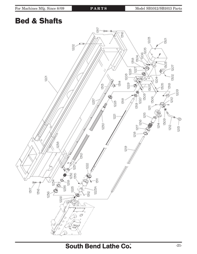

PSB10131201
BED CASTING
PSB10131202
BED END STOP BOLT
PSB10131203
SHAFT END BRACKET COVER
PSB10131204
FEED ROD END BRACKET
PSB10131205
STEEL BALL 5/16
PSB10131206
COMPRESSION SPRING 8 X 27
PSB10131207
SPINDLE ROD END BRACKET
PSB10131208
SHAFT END BRACKET
PSB10131209
LOCK COLLAR
PSB10131210
SPINDLE LEVER HUB
PSB10131211
STEP PIN
PSB10131212
SPINDLE ROD LEVER
PSB10131213
SPINDLE ROD LEVER KNOB
PSB10131214
SPINDLE LEVER HUB BRACKET
PSB10131215
SPINDLE ROD SLEEVE
PSB10131216
COMPRESSION SPRING 38 X 75
PSB10131217
SPRING HOUSING
PSB10131218
EXT RETAINING RING 32MM
PSB10131219
SPINDLE ROD
PSB10131220
THRUST BEARING NTB/AS2 1831
PSB10131221
FEED ROD
PSB10131222
FEED ROD LOCK COLLAR
PSB10131223
CLUTCH COLLAR ASSEMBLY
PSB10131223A
PSB10131224
PSB10131225
THRUST BEARING 51203
PSB10131226
COMPRESSION SPRING 9 X 32
PSB10131227
LEADSCREW LOCK NUT
PSB10131228
THRUST BEARING 51105
PSB10131229
OIL FILL PLUG
PSB10131230
INCH LEADSCREW 4 TPI
PSB10131231
PSB10131232
COMPRESSION SPRING 27 X 55
PSB10131234
LEADSCREW SHEAR PIN
PSB10131235
SHEAR PIN WASHER
PSB10131236
SHEAR PIN COLLAR
PSB10131237
LONGITUDINAL RACK
PSB10131238
GAP RACK
PSB10131301
CAP SCREW M6-1 X 55
PSB10131302
SET SCREW M6-1 X 16
PSB10131303
CAP SCREW M6-1 X 25
PSB10131304
PSB10131305
CAP SCREW M8-1.25 X 70
PSB10131306
TAPER PIN #7 X #3 X 1/4"
PSB10131307
DOWEL PIN #2 X 2"
PSB10131308
CAP SCREW M8-1.25 X 35
PSB10131309
HEX NUT M12-1.75
PSB10131310
KEY 5 X 5 X 15
PSB10131311
CAP SCREW M6-1 X 20
PSB10131312
DOWEL PIN 4 X 30MM
PSB10131313
ROLL PIN 6 X 25
PSB10131314
CAP SCREW M6-1 X 20
PSB10131315
SET SCREW M6-1 X 6
PSB10131316
FLAT WASHER 12MM
PSB10131317
HEX BOLT M12-1.75 X 45
PSB10131318
SET SCREW M6-1 X 8
PSB10131319
PSB10131320
SPINDLE ROTATION SWITCH
PSB10131401
CAP SCREW M6-1 X 20
PSB10131402
GEAR WASHER 6MM
PSB10131403
GEAR 24T
PSB10131404
PIVOT ARM
PSB10131405
KEY 7 X 7 X 15
PSB10131406
HEX NUT M14-2
PSB10131407
GEAR WASHER 14MM
PSB10131408
INT RETAINING RING 47MM
PSB10131409
DOUBLE GEAR 44T/56T
PSB10131410
BALL BEARING 6005ZZ
PSB10131411
BEARING SPACER
PSB10131412
GEAR SHAFT BUSHING
PSB10131413
GEAR SHAFT
PSB10131414
KEY 7 X 7 X 29
PSB10131415
STUD-FT M14-2 X 110 100
PSB10131416
CAP SCREW M8-1.25 X 20
PSB10131417
GEAR WASHER 8MM
PSB10131418
GEAR 57T
PSB10131419
GEAR BUSHING
PSB10131501
SIDE COVER MOUNTING PIN
PSB10131502
HEX NUT M10-1.5
PSB10131503
FLAT WASHER 10MM
PSB10131504
LEFT TOP SIDE COVER
PSB10131505
KNURLED SIDE COVER KNOB M10-1.5
PSB10131506
CAP SCREW M10-1.5 X 25
PSB10131507
PULLEY WASHER 10 X 39 X 5MM
PSB10131508
V-BELT B69
PSB10131509
MOTOR PULLEY
PSB10131510
CAP SCREW M6-1 X 16
PSB10131511
TAPER PIN #4 X #1 X 3/4"
PSB10131512
BRAKE BELT BRACKET
PSB10131513
E-CLIP 6MM
PSB10131514
BRAKE BELT ADJUSTMENT BAR
PSB10131515
CAP SCREW M8-1.25 X 45
PSB10131516
FLAT WASHER 8MM
PSB10131517
BRAKE BELT
PSB10131518
CAPTIVE PIN
PSB10131519
MOTOR 5HP 220/440V 3PH W/ PULLEY V1
PSB10131519-1
MOTOR FAN COVER
PSB10131519-2
MOTOR FAN
PSB10131519-3
MOTOR JUNCTION BOX
PSB10131519V2
MOTOR 5HP 220/440V 3PH V2.05.13 (SB1013)
PSB10131519V2-1
MOTOR FAN COVER
PSB10131519V2-2
MOTOR FAN
PSB10131519V2-3
MOTOR JUNCTION BOX
PSB10131520
STUD-DE M10-1.5 X 135 30/30
PSB10131521
PHLP HD SCR M6-1 X 10
PSB10131522
MOTOR COVER

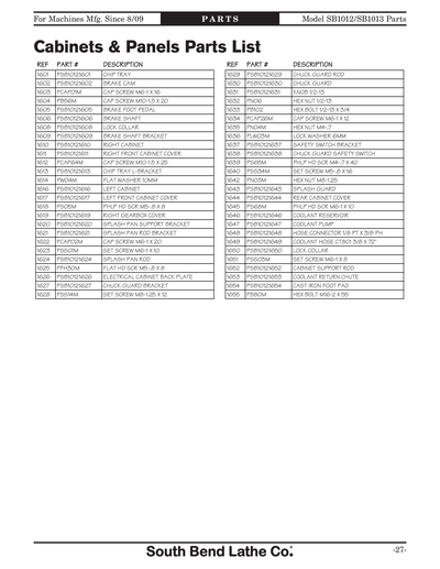

PSB10131523
HEX NUT M8-1.25
PSB10131524
STUD-SE M8-1.25 X 50 20
PSB10131525
BRAKE BELT EXTENSION SPRING
PSB10131526
CAP SCREW M8-1.25 X 55
PSB10131527
MOUNTING INSERT
PSB10131528
MOTOR MOUNTING 10T/395 X 300MM
PSB10131529
HEX BOLT M10-1.5 X 40
PSB10131530
LOCK WASHER 10MM
PSB10131531
HEX NUT M16-2
PSB10131532
STUD-FT M16-2 X 170 170
PSB10131533
FLAT WASHER 16MM
PSB10131534
RUBBER CUSHION SLEEVE
PSB10131535
MOTOR SUPPORT SHAFT
PSB10131536
HEX NUT M4-.7
PSB10131537
SIDE COVER SAFETY SWITCH TM1307
PSB10131538
PHLP HD SCR M4-.7 X 40
PSB10131601
CHIP TRAY
PSB10131602
BRAKE CAM
PSB10131603
CAP SCREW M6-1 X 16
PSB10131604
CAP SCREW M3-.5 X 10
PSB10131605
BRAKE FOOT PEDAL
PSB10131606
BRAKE SHAFT
PSB10131608
LOCK COLLAR
PSB10131609
BRAKE SHAFT BRACKET
PSB10131610
RIGHT CABINET
PSB10131611
RIGHT FRONT CABINET COVER
PSB10131612
PSB10131613
CHIP TRAY L-BRACKET
PSB10131614
FLAT WASHER 10MM
PSB10131616
LEFT CABINET
PSB10131617
LEFT FRONT CABINET COVER
PSB10131618
PHLP HD SCR M5-.8 X 8
PSB10131619
RIGHT GEARBOX COVER
PSB10131620
SPLASH PAN SUPPORT BRACKET
PSB10131621
SPLASH PAN ROD BRACKET
PSB10131622
CAP SCREW M6-1 X 20
PSB10131623
SET SCREW M6-1 X 10
PSB10131624
SPLASH PAN ROD
PSB10131625
PSB10131626
ELECTRICAL CABINET BACK PLATE
PSB10131627
CHUCK GUARD BRACKET
PSB10131628
PSB10131629
CHUCK GUARD ROD
PSB10131630
CHUCK GUARD
PSB10131631
KNOB 1/2-13
PSB10131632
HEX NUT 1/2-12
PSB10131633
HEX BOLT 1/2-13 X 3/4
PSB10131634
CAP SCREW M6-1 X 12
PSB10131635
HEX NUT M4-.7
PSB10131636
LOCK WASHER 6MM
PSB10131637
SAFETY SWITCH BRACKET
PSB10131638
CHUCK GUARD SAFETY SWITCH
PSB10131639
PSB10131640
SET SCREW M5-.8 X 16
PSB10131642
HEX NUT M8-1.25
PSB10131643
SPLASH GUARD
PSB10131644
REAR CABINET COVER
PSB10131645
PSB10131646
COOLANT RESERVOIR
PSB10131647
COOLANT PUMP
PSB10131648
HOSE CONNECTOR 1/8 PT X 3/8 PH
PSB10131649
COOLANT HOSE CT801 3/8 X 72"
PSB10131650
FLAT WASHER 1"
PSB10131651
SET SCREW M6-1 X 8
PSB10131652
CABINET SUPPORT ROD
PSB10131653
COOLANT RETURN CHUTE
PSB10131654
CAST IRON FOOT PAD
PSB10131655
HEX BOLT M16-2 X 55
PSB10131701

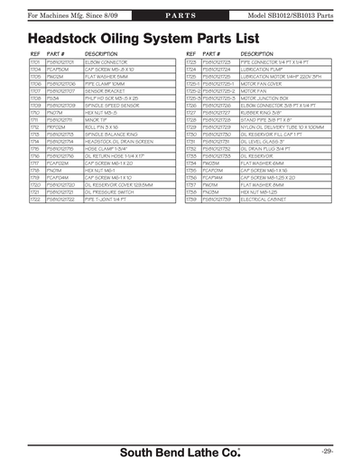

ELBOW CONNECTOR
PSB10131704
PSB10131705
FLAT WASHER 5MM
PSB10131706
PIPE CLAMP 10MM
PSB10131707
SENSOR BRACKET
PSB10131708
PHLP HD SCR M3-.5 X 25
PSB10131709
SPINDLE SPEED SENSOR
PSB10131710
HEX NUT M3-.5
PSB10131711
MINOR TIP
PSB10131712
ROLL PIN 3 X 16
PSB10131713
SPINDLE BALANCE RING
PSB10131714
HEADSTOCK OIL DRAIN SCREEN
PSB10131715
HOSE CLAMP 1-3/4"
PSB10131716
OIL RETURN HOSE 1-1/4 X 17"
PSB10131717
CAP SCREW M6-1 X 20
PSB10131718
HEX NUT M6-1
PSB10131719
CAP SCREW M6-1 X 10
PSB10131720
OIL RESERVOIR COVER 129.5MM
PSB10131721
OIL PRESSURE SWITCH
PSB10131722
PIPE T-JOINT 1/4 PT
PSB10131723
PIPE CONNECTOR 1/4 PT X 1/4 PT
PSB10131724
LUBRICATION MOTOR 1/4HP 220V 3PH W/PUMP
PSB10131725
PSB10131725-1
MOTOR FAN COVER
PSB10131725-2
MOTOR FAN
PSB10131725-3
MOTOR JUNCTION BOX
PSB10131726
ELBOW CONNECTOR 3/8 PT X 1/4 PT
PSB10131727
RUBBER RING 3/8"
PSB10131728
STAND PIPE 3/8 PT X 8"
PSB10131729
NYLON OIL DELIVERY TUBE 10 X 100MM
PSB10131730
OIL RESERVOIR FILL CAP 1 PT
PSB10131731
OIL LEVEL GLASS 3"
PSB10131732
OIL DRAIN PLUG 3/4 PT
PSB10131733
OIL RESERVOIR
PSB10131734
FLAT WASHER 6MM
PSB10131735
CAP SCREW M6-1 X 16
PSB10131736
PSB10131737
FLAT WASHER 8MM
PSB10131738
HEX NUT M8-1.25
PSB10131739
ELECTRICAL CABINET
PSB10131740
MAIN POWER SWITCH W/ DIAL

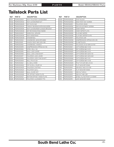

INCH TAILSTOCK LEADSCREW W/NUT
PSB10131802
PSB10131803
KEY 5 X 5 X 20
PSB10131804
THRUST BEARING MTB/AS2-2035
PSB10131805
INCH LEADSCREW FLANGE BRACKET
PSB10131806
PSB10131807
INDEX DIAL SPACER
PSB10131808
INCH INDEX RING
PSB10131809
HANDWHEEL
PSB10131810
PSB10131811
HANDLE BOLT M8-1.25 X 90
PSB10131812
HANDWHEEL HANDLE
PSB10131813
PSB10131814
STEEL BALL 1/4
PSB10131815
QUILL LOCK LEVER
PSB10131816
QUILL LOCK CAM SHAFT
PSB10131817
TAILSTOCK LOCK LEVER
PSB10131818
TAILSTOCK LOCK CAM SHAFT
PSB10131819
ROLL PIN 4 X 24
PSB10131821
OIL SEAL DH53
PSB10131822
PSB10131823
TAILSTOCK CASTING
PSB10131824
TAILSTOCK QUILL
PSB10131825
QUILL GUIDE KEY
PSB10131826
TOP OFFSET INDEX PLATE
PSB10131827
BOTTOM OFFSET INDEX PLATE
PSB10131828
TAILSTOCK ALIGNMENT PIN
PSB10131829
PIVOT BLOCK
PSB10131830
DOG PT SET SCREW
PSB10131831
TAILSTOCK BASE
PSB10131832
PSB10131833
V-WAY WIPER
PSB10131834
V-WAY WIPER PLATE
PSB10131835
FLAT WAY WIPER
PSB10131836
FLAT WAY WIPER PLATE
PSB10131837
TAILSTOCK GIB
PSB10131838
COMPRESSION SPRING 25 X 45
PSB10131839
CLAMP BLOCK
PSB10131840
STUD-FT M14-2 110 110
PSB10131901
CAP SCREW M6-1 X 16
PSB10131902
SET SCREW M6-1 X 12
PSB10131903
CAP SCREW M6-1 X 12
PSB10131904
PSB10131905
PSB10131906
CAP SCREW M6-1 X 8
PSB10131907
CAP SCREW M6-1 X 16
PSB10131908
PSB10131909
FLAT WASHER 10MM
PSB10131910
HEX BOLT M10-1.5 X 55
PSB10131911
FLAT WASHER 14MM
PSB10131912
HEX NUT M14-2
PSB10131913
HEX NUT M8-1.25
PSB10131914
PSB10131915
LOCK WASHER 10MM
PSB10132001

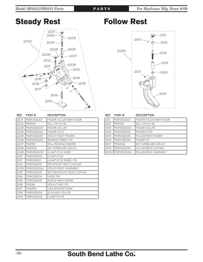

FINGER ADJUSTMENT KNOB
PSB10132002
ROLL PIN 4 X 40
PSB10132003
FINGER COLLAR
PSB10132004
FINGER STUD
PSB10132005
STEADY REST FINGER
PSB10132006
BEARING DOWEL PIN
PSB10132007
BALL BEARING 627ZZ
PSB10132008
PSB10132009
CLAMP STUD KNOB
PSB10132010
CLAMP STUD
PSB10132011
CLAMP DOWEL PIN
PSB10132012
STEADY REST ASSEMBLY
PSB10132013
PSB10132014
HINGE PIN
PSB10132015
SINGLE WING SCREW
PSB10132016
HEX NUT M12-1.75
PSB10132017
LOCK WASHER 12MM
PSB10132018
STUD-DE M14-2 X 80 28/35
PSB10132019
CLAMP PLATE
PSB10132101
PSB10132102
ROLL PIN 4 X 40
PSB10132103
FINGER COLLAR
PSB10132104
FINGER STUD
PSB10132105
FOLLOW REST FINGER
PSB10132106
FINGER TIP
PSB10132107
PSB10132108
FOLLOW REST ASSEMBLY

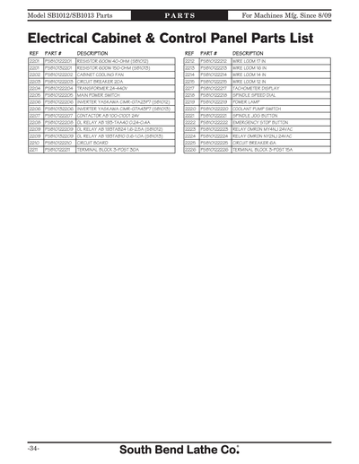

CABINET COOLING FAN
PSB10132203
CIRCUIT BREAKER 20A AB 1492-SP D20 3P
PSB10132204
TRANSFORMER TBSW11 140VA 220/440-24/220V
PSB10132205
P
INVERTER YASKAWA CIMR-G7A43P7
$2,912.50
PSB10132207
CONTACTOR AB 100-C1001 24V
PSB10132208
OL RELAY AB193-T1AA40 0.25-0.4A
P
OL RELAY AB193-T1AB10 0.75-1A
$114.15
PSB10132210
CIRCUIT BOARD W/RELAYS
PSB10132211
TERMINAL BLOCK 3-POST 30A
PSB10132212
WIRE LOOM 17"
PSB10132213
WIRE LOOM 16"
PSB10132214
WIRE LOOM 14"
PSB10132215
WIRE LOOM 12"
PSB10132217
TACHOMETER DISPLAY
PSB10132218
SPINDLE SPEED DIAL
PSB10132219
POWER INDICATOR LIGHT AB 800FD P7N3 22MM
PSB10132220
COOLANT PUMP SWITCH
PSB10132221
JOG BUTTON AB 800FP-F3 22MM GRN
PSB10132222
E-STOP BUTTON AB 800FD-MT44X01
PSB10132223
RELAY OMRON MY4NJ 24VAC
PSB10132224
RELAY OMRON MY2NJ 24V
PSB10132225
CIRCUIT BREAKER 6A AB 1489-A D6 1P
PSB10132226
TERMINAL BLOCK 3-POST 15A

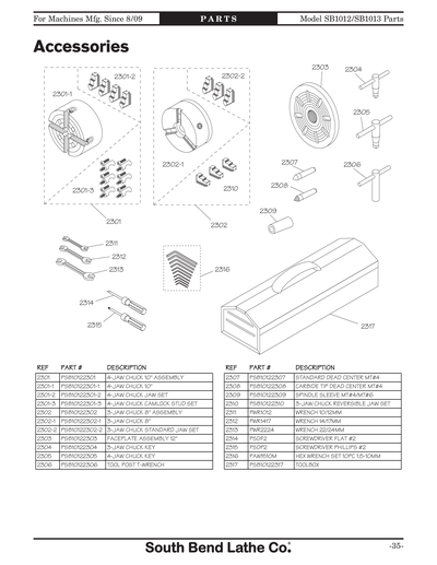

CHUCK 4-JAW 10" ASSEMBLY
PSB10132301-1
PSB10132301-2
PSB10132301-3
CHUCK 4-JAW CAMLOCK STUD SET
PSB10132302
CHUCK 3-JAW 8" ASSEMBLY
PSB10132302-1
PSB10132302-2
PSB10132303
FACEPLATE ASSEMBLY 12"
PSB10132304
CHUCK 3-JAW KEY
PSB10132305
CHUCK 4-JAW KEY
PSB10132306
TOOL POST T-WRENCH
PSB10132307
STANDARD DEAD CENTER MT#4
PSB10132308
CARBIDE TIP DEAD CENTER MT#4
PSB10132309
SPINDLE SLEEVE MT#4/MT#6
PSB10132310
PSB10132311
WRENCH 10 X 12MM OPEN-ENDS
PSB10132312
WRENCH 14 X 17MM OPEN-ENDS
PSB10132313
WRENCH 22 X 24MM OPEN-ENDS
PSB10132314
SCREWDRIVER FLAT #2
PSB10132315
SCREWDRIVER PHILLIPS #2
PSB10132316
HEX WRENCH 1.5-10MM 10PC SET
PSB10132317
TOOLBOX
