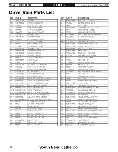

Parts for SB1041 18" Vertical Bandsaw - 3PH
Parts Diagrams for SB1041 - 18" Vertical Bandsaw - 3PH
Parts List for Parts for SB1041 18" Vertical Bandsaw - 3PH

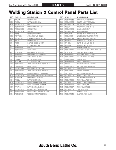

***USE P0806507***
PSB1041410
Now: PN06M
HEX NUT M5-.8
PSB1041411
Now: PS48
PHLP HD SCR 5-40 X 3/4
PSB1041412
Now: PLW11
LOCK WASHER #5
PSB1041413
***USE P0806511***
PSB1041414
***USE P0806512***
PSB1041415
CAP SCREW M5-.8 X 25
PSB1041416
***USE P0806514***
PSB1041417
CAP SCREW M5-.8 X 8
PSB1041418
Now: PW02M
FLAT WASHER 5MM
PSB1041419
LOCK WASHER 5MM
PSB1041420
***USE PT27555116***
PSB1041421
***USE P0806518***
PSB1041422
***USE P0806548***
PSB1041423
***USE P0806520***
PSB1041424
***USE P0806521***
PSB1041425
TRANSFORMER WELDING 110/220VA 110/220V
PSB1041426
CAP SCREW M5-.8 X 16
PSB1041427
Now: PW02M
FLAT WASHER 5MM
PSB1041428
Now: PW02M
FLAT WASHER 5MM
PSB1041429
***USE P0806525***
PSB1041430
FLAT HD SCR M5-.8 X 6
PSB1041431
***USE P0806529***
PSB1041432
GRINDER MOTOR YEN TONG 1/8HP 110V
PSB1041433
***USE P0806531***
PSB1041434
***USE P0806532***
PSB1041435
***USE P0806533***
PSB1041436
***USE P0806534***
PSB1041437
Now: PS09M
PHLP HD SCR M5-.8 X 10
PSB1041438
***USE P0806543***
PSB1041439
***USE P0806545***
PSB1041440
RIVET 2 X 6MM BLIND, BRASS
PSB1041441
***USE P0806581***
PSB1041442
***USE P0806549***
PSB1041443
FLAT HD SCR M5-.8 X 16
PSB1041444
FLAT HD SCR M5-.8 X 12
PSB1041445
FLAT HD SCR M5-.8 X 10
PSB1041446
Now: PW06
FLAT WASHER 1/4
PSB1041447
GRINDING WHEEL 1/4 X 5/8 X 2-1/2
PSB1041448
CAP SCREW M5-.8 X 6
PSB1041449
***USE P0806574***
PSB1041450
***USE P0806573***
PSB1041451
KNOB
PSB1041452
LEFT CLAMP LEVER
PSB1041453
Now: PS16M
PHLP HD SCR M8-1.25 X 16
PSB1041454
***USE PT27555132***
PSB1041455
CAM PIVOT SHAFT
PSB1041456
***USE P0806571***
PSB1041457
CAP SCREW M5-.8 X 12
PSB1041458
***USE PT27555111***
PSB1041459
Now: PR73M
EXT RETAINING RING 5MM
PSB1041460
RIGHT CLAMP LEVER
PSB1041461
***USE PT27555135***
PSB1041462
***USE P0806569***
PSB1041463
***USE PT27555105***
PSB1041464
***USE P0806555***
PSB1041465
Now: PN05
HEX NUT 1/4-20
PSB1041466

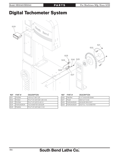

***USE P0806536***
PSB1041501
Now: PN03M
HEX NUT M8-1.25
PSB1041502
Now: PS16M
PSB1041503
PHLP HD SCR 5-40 X 1
PSB1041504
TACHOMETER SENSOR
PSB1041505
Now: PS68M
PHLP HD SCR M6-1 X 10
PSB1041506
Now: PW03M
FLAT WASHER 6MM
PSB1041507
Now: PN28
HEX NUT 5-40
PSB1041508
SENSOR BRACKET
PSB1041509
DIGITIAL TACHOMETER

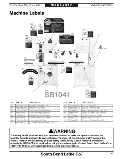

PSB1041701
EYE/FACE/LUNG LABEL 2 X 3.25
PSB1041702
READ MANUAL LABEL 2 X 3.25
PSB1041703
BANDSAW BLADE LABEL 1.5 X 2.5
P
MACHINE ID LABEL
$16.40
PSB1041705
UNSTABLE WORKPIECE LABEL
PSB1041706
DISCONNECT POWER LABEL 3.25 X 2
PSB1041707
ALLEN BRADLEY CONTROLS LABEL 3 X .75
PSB1041708
ELECTRICITY LABEL 1.4
PSB1041709
BANDSAW BLADE LABEL 3.25 X 2
PSB1041710
MODEL NUMBER LABEL
PSB1041711
SB GRAY TOUCH-UP AEROSOL 5oz
PSB1041712
SPEED DIRECTION LABEL
PSB1041713
CHANGE SPEED NOTICE LABEL
