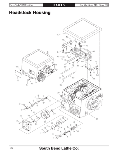

Parts Diagrams for SB1045PF - 21" x 120" Turn-Nado EVS Lathe with DRO

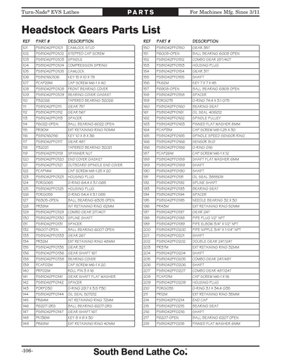

PSB1045PF0101
CAMLOCK STUD
PSB1045PF0102
STEPPED CAP SCREW
PSB1045PF0103
SPINDLE
PSB1045PF0104
COMPRESSION SPRING
PSB1045PF0105
CAMLOCK
PSB1045PF0106
KEY 15 X 10 X 78
PSB1045PF0107
CAP SCREW M6-1 X 40
PSB1045PF0108
FRONT BEARING COVER
PSB1045PF0109
BEARING COVER GASKET
PSB1045PF0110
TAPERED BEARING 32026
PSB1045PF0111
GEAR 75T
PSB1045PF0112
GEAR 56T
PSB1045PF0113
SPACER
PSB1045PF0114
BALL BEARING 6022 OPEN
PSB1045PF0115
Now: PR90M
EXT RETAINING RING 110MM
PSB1045PF0116
KEY 10 X 8 X 36
PSB1045PF0117
GEAR 48T
PSB1045PF0118
TAPERED BEARING 32021
PSB1045PF0119
SPANNER NUT
PSB1045PF0120
END COVER GASKET
PSB1045PF0121
OUTBOARD SPINDLE END COVER
PSB1045PF0122
CAP SCREW M8-1.25 X 20
PSB1045PF0123
HOUSING PLUG
PSB1045PF0124
O-RING 64.4 X 3.1 G65
PSB1045PF0125
HOUSING PLUG
PSB1045PF0126
O-RING 54.4 X 3.1 G55
PSB1045PF0127
BALL BEARING 6305-OPEN
PSB1045PF0128
Now: PR38M
INT RETAINING RING 62MM
PSB1045PF0129
COMBO GEAR 21T/40T
PSB1045PF0130
SPLINE SHAFT
PSB1045PF0131
SPACER
PSB1045PF0132
BALL BEARING 6007-OPEN
PSB1045PF0133
GEAR 26T
PSB1045PF0134
Now: PR32M
EXT RETAINING RING 48MM
PSB1045PF0135
GEAR 32T
PSB1045PF0136
GEAR SHAFT 16T
PSB1045PF0138
BEARING COVER
PSB1045PF0139
CAP SCREW M6-1 X 20
PSB1045PF0140
ROLL PIN 3 X 16
PSB1045PF0141
GEAR SHAFT FLAT WASHER
PSB1045PF0142
SPACER
PSB1045PF0143
O-RING 29.7 X 3.5 P30
PSB1045PF0144
OIL SEAL 507212
PSB1045PF0145
Now: PR64M
INT RETAINING RING 72MM
PSB1045PF0146
BALL BEARING 6207-2RS
PSB1045PF0147
GEAR SHAFT 16T
PSB1045PF0148
KEY 8 X 8 X 30
PSB1045PF0149
Now: PR68M
EXT RETAINING RING 40MM
PSB1045PF0150
GEAR 35T
PSB1045PF0151
BALL BEARING 6008-OPEN
PSB1045PF0152
COMBO GEAR 25T/40T
PSB1045PF0153
HOUSING PLUG
PSB1045PF0154
GEAR 31T
PSB1045PF0155
SHAFT
PSB1045PF0156
Now: PK62M
KEY 7 X 7 X 45
PSB1045PF0157
BALL BEARING 6908-OPEN
PSB1045PF0158
SPACER
PSB1045PF0159
O-RING 74.4 X 3.1 G75
PSB1045PF0160
BEARING SEAT
PSB1045PF0161
OIL SEAL 406212
PSB1045PF0162
SPINDLE PULLEY
PSB1045PF0163
PINNED FLAT WASHER 8MM
PSB1045PF0164
CAP SCREW M8-1.25 X 30
PSB1045PF0165
SPINDLE SPEED SENSOR RING
PSB1045PF0166
SENSOR BUD
PSB1045PF0186
O-RING G16

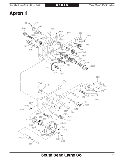

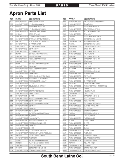

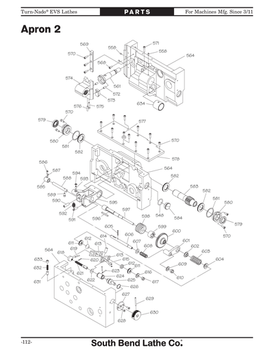

STEEL BALL 1/4
PSB1045PF0507
COMPRESSION SPRING
PSB1045PF0508
CARRIAGE GRADUATED DIAL
PSB1045PF0509
FLAT HD CAP SCR M5-.8 X 12
PSB1045PF0510
SHAFT BRACKET
PSB1045PF0511
WOODRUFF KEY 5 X 19
PSB1045PF0512
GEAR SHAFT
PSB1045PF0513
HOUSING PLUG
PSB1045PF0514
Now: PR07M
EXT RETAINING RING 18MM
PSB1045PF0515
THRUST WASHER
PSB1045PF0516
NEEDLE BEARING 18/20
PSB1045PF0517
SPACER
PSB1045PF0518
Now: PR11M
EXT RETAINING RING 25MM
PSB1045PF0519
GEAR 56T
PSB1045PF0520
NEEDLE BEARING 28/20
PSB1045PF0521
SPACER
PSB1045PF0522
GEAR SHAFT
PSB1045PF0523
RIVET 3 X 10MM BLIND, STEEL
PSB1045PF0524
FEED SELECTION ID PLATE
PSB1045PF0525
FEED SELECTION SHAFT
PSB1045PF0526
COLLAR
PSB1045PF0527
DOUBLE GEAR 15T/33T
PSB1045PF0528
COLLAR
PSB1045PF0529
STEPPED DOWEL PIN
PSB1045PF0530
OIL SIGHT GLASS
PSB1045PF0531
SHAFT
PSB1045PF0532
*DISCD*NEEDLE BEARING TLA1616
PSB1045PF0533
GEAR SHAFT 26T
PSB1045PF0534
NEEDLE BEARING TLA3016
PSB1045PF0535
GEAR 24T
PSB1045PF0536
GEAR 24T
PSB1045PF0537
BEVEL GEAR
PSB1045PF0538
Now: PR15M
EXT RETAINING RING 30MM
PSB1045PF0539
BUSHING
PSB1045PF0540
ALIGNMENT PIN
PSB1045PF0541
FEED DIRECTION ID PLATE
PSB1045PF0542
FEED DIRECTION SHAFT
PSB1045PF0543
GEAR 24T
PSB1045PF0545
SHAFT
PSB1045PF0546
DOUBLE GEAR 24T/26T
PSB1045PF0547
FEED ON/OFF LEVER ASSEMBLY
PSB1045PF0548
O-RING 20.8 X 2.4 P21
PSB1045PF0549
PIVOT FORK
PSB1045PF0550
Now: PR81M
EXT RETAINING RING 21MM
PSB1045PF0551
FLAT HD CAP SCR M6-1 X 16
PSB1045PF0552
LEVER RETAINER
PSB1045PF0553
SET SCREW M8-1.25 X 8
PSB1045PF0554
COMPRESSION SPRING
PSB1045PF0555
HALF NUT LEVER ASSEMBLY
PSB1045PF0557
O-RING G25
PSB1045PF0558
SET SCREW M6-1 X 8
PSB1045PF0559
COMPRESSION SPRING
PSB1045PF0560
WOODRUFF KEY 5 X 16
PSB1045PF0561
CAM SHAFT
PSB1045PF0562
SET SCREW M10-1.5 X 35
PSB1045PF0563
SET SCREW M10-1.5 X 10
PSB1045PF0564
APRON HOUSING 2PC
PSB1045PF0565
SET SCREW M10-1.5 X 6
PSB1045PF0566
COMPRESSION SPRING
PSB1045PF0567
STEEL BALL 3/8
PSB1045PF0568
CAP SCREW M6-1 X 12
PSB1045PF0569
HALF NUT GIB
PSB1045PF0570
CAP SCREW M6-1 X 16
PSB1045PF0571
CAP SCREW M6-1 X 30
PSB1045PF0572
DOWEL PIN
PSB1045PF0573
SIDE PLATE
PSB1045PF0574
HALF NUT
PSB1045PF0575
CAP SCREW M6-1 X 30
PSB1045PF0576
SET SCREW M6-1 X 30
PSB1045PF0577
PLUG 3/8" NPT
PSB1045PF0578
TOP PLATE
PSB1045PF0579
OIL SEAL 30 X 40 X 5
PSB1045PF0580
SHAFT BRACKET
PSB1045PF0581
O-RING 44.4 X 3.1 G45
PSB1045PF0582
*DISCD*THRUST BEARING NTB3047/AS2
PSB1045PF0583
PINION
PSB1045PF0584
HOUSING PLUG
PSB1045PF0585
LOCK COLLAR
PSB1045PF0586
CAP SCREW M6-1 X 12
PSB1045PF0587
ROLL PIN 4 X 16
PSB1045PF0588
RETAINING PIN
PSB1045PF0589
CAP SCREW M5-.8 X 25
PSB1045PF0590
SLOTTED DOWEL PIN
PSB1045PF0591
CAPTIVE PIN
PSB1045PF0592
EXTENSION SPRING
PSB1045PF0593
SET SCREW M6-1 X 14
PSB1045PF0594
LOCK NUT M6-1
PSB1045PF0595
PIVOT BRACKET
PSB1045PF0596
Now: PK33M
KEY 5 X 5 X 45
PSB1045PF0597
SHAFT
PSB1045PF0598
WORM
PSB1045PF0599
CLUTCH
PSB1045PF0600
CLUTCH GEAR
PSB1045PF0601
PIVOT ARM
PSB1045PF0602
SPRING RETAINER
PSB1045PF0603
COMPRESSION SPRING
PSB1045PF0604
SPRING RETAINER
PSB1045PF0605
ROLL PIN 4 X 24
PSB1045PF0606
TRIP ROD
PSB1045PF0607
SPRING RETAINER
PSB1045PF0608
COMPRESSION SPRING
PSB1045PF0609
SPACER
PSB1045PF0610
LOCK NUT M12-1.75
PSB1045PF0611
THRUST BEARING NTB1528/AS2
PSB1045PF0612
DOMED BEARING
PSB1045PF0613
CLAMP PLATE 2PC
PSB1045PF0614
DOWEL PIN
PSB1045PF0615
ROLL PIN 5 X 30
PSB1045PF0616
SPACER
PSB1045PF0617
LOCK NUT M10-1.5
PSB1045PF0618
THREADED SHAFT W/DOMED BEARING
PSB1045PF0619
ROLL PIN 4 X 24
PSB1045PF0620
ROLL PIN 3 X 16
PSB1045PF0621
PSB1045PF0622
DOMED BEARING
PSB1045PF0623
ROLL PIN 3 X 24
PSB1045PF0624
COUPLING
PSB1045PF0625
SHAFT
PSB1045PF0626
O-RING 17.8 X 2.4 P18
PSB1045PF0627
END PLATE
PSB1045PF0628
FLAT HD CAP SCR M5-.8 X 16
PSB1045PF0629
ROLL PIN 5 X 36
PSB1045PF0630
KNURLED KNOB
PSB1045PF0631
STEPPED DOWEL PIN
PSB1045PF0632
COMPRESSION SPRING
PSB1045PF0633
SET SCREW M12-1.75 X 12
PSB1045PF0634
BUSHING

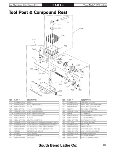

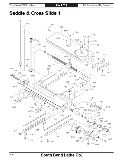

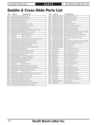

PSB1045PF0701
HANDLE
PSB1045PF0702
TOOL POST NUT 4-WAY
PSB1045PF0703
COLLAR
PSB1045PF0704
TOOL POST BOLT 4-WAY
PSB1045PF0705
TOOL POST BODY 4-WAY
PSB1045PF0705A
TOOL POST ASSEMBLY 4-WAY
PSB1045PF0706
TOOL POST SHAFT 4-WAY
PSB1045PF0707
PLUNGER
PSB1045PF0708
COMPRESSION SPRING
PSB1045PF0712
COMPOUND REST BODY
PSB1045PF0712A
COMPOUNT REST ASSEMBLY
PSB1045PF0713
SET SCREW M8-1.25 X 16
PSB1045PF0714
STEEL BALL 1/4
PSB1045PF0715
BALL OILER 1/4 PRESS-IN
PSB1045PF0716
GIB SCREW
PSB1045PF0717
COMPOUND REST GIB
PSB1045PF0718
SWIVEL BASE
PSB1045PF0719
SET SCREW M8-1.25 X 30
PSB1045PF0720
LEADSCREW W/NUT
PSB1045PF0722
Now: PK47M
KEY 4 X 4 X 15
PSB1045PF0723
THRUST BEARING NTB/AS2 2035
PSB1045PF0724
LEADSCREW BRACKET
PSB1045PF0725
COMPRESSION SPRING
PSB1045PF0726
CAP SCREW M6-1 X 20
PSB1045PF0727
DIAL COLLAR
PSB1045PF0728
GRADUATED DIAL
PSB1045PF0729
COMPOUND REST HANDWHEEL
PSB1045PF0730
LONG HANDWHEEL HANDLE
PSB1045PF0732
HANDWHEEL RETAINER
PSB1045PF0733
SET SCREW M6-1 X 20
PSB1045PF0734
SHORT HANDWHEEL HANDLE
PSB1045PF0801
GIB SCREW
PSB1045PF0802
CROSS SLIDE
PSB1045PF0803
PIVOT PIN
PSB1045PF0804
T-BOLT
PSB1045PF0805
CROSS SLIDE GIB
PSB1045PF0806
CROSS SLIDE WIPER
PSB1045PF0807
WIPER PLATE
PSB1045PF0808
THRUST BEARING NTB/AS2 1730
PSB1045PF0809
WEDGE KEY 7 X 7 X 30
PSB1045PF0810
LEADSCREW W/NUT
PSB1045PF0811
ROLL PIN 5 X 40
PSB1045PF0813
KEY 3 X 3 X 115
PSB1045PF0814
COOLANT STAND PIPE 3/8" NPT X 24"
PSB1045PF0815
COOLANT VALVE 3/8" NPT
PSB1045PF0816
LEADSCREW REAR COVER
PSB1045PF0817
THRUST WASHER
PSB1045PF0818
LEADSCREW REAR BRACKET
PSB1045PF0819
SADDLE
PSB1045PF0820
SADDLE FLAT WIPER
PSB1045PF0821
FLAT WIPER PLATE
PSB1045PF0822
OIL CAP
PSB1045PF0823
TAPER PIN #6 X 90MM
PSB1045PF0824
SADDLE V-WIPER
PSB1045PF0825
V-WIPER PLATE
PSB1045PF0826
PINION
PSB1045PF0827
Now: PK96M
KEY 3 X 3 X 20
PSB1045PF0828
PINION END CAP M16-2 X 5
PSB1045PF0829
LEADSCREW FRONT BRACKET
PSB1045PF0830
COMPRESSION SPRING
PSB1045PF0831
STEEL BALL 1/4
PSB1045PF0832
PSB1045PF0833
THRUST WASHER
PSB1045PF0834
RETAINING PLATE
PSB1045PF0835
DIAL COLLAR
PSB1045PF0836
GRADUATED DIAL
PSB1045PF0837
CROSS SLIDE HANDWHEEL
PSB1045PF0838
HANDWHEEL RETAINER
PSB1045PF0839
HANDWHEEL HANDLE
PSB1045PF0840
HANDLE CAP SCREW
PSB1045PF0841
FRONT GIB SUPPORT
PSB1045PF0842
SADDLE GIB
PSB1045PF0843
REAR GIB SUPPORT
PSB1045PF0844

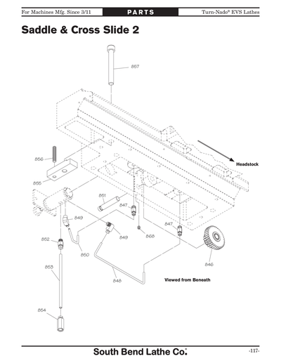

ONE-SHOT OILER ASSEMBLY
PSB1045PF0845
ONE-SHOT OILER PLATE
PSB1045PF0846
DOUBLE GEAR 16T/36T
PSB1045PF0847
PIPE STRAIGHT ADAPTER 1/8" NPT X 4MM
PSB1045PF0848
OIL TUBE ALUMINUM 4 X 258MM
PSB1045PF0849
PIPE ELBOW ADAPTER 1/8" NPT X 4MM
PSB1045PF0850
OIL TUBE ALUMINUM 4 X 121MM
PSB1045PF0851
SHAFT
PSB1045PF0852
PIPE STRAIGHT ADAPTER 1/8" NPT X 6MM
PSB1045PF0853
OIL TUBE ALUMINUM 6 X 175MM
PSB1045PF0854
OIL FILTER 6MM
PSB1045PF0855
CLAMP PLATE
PSB1045PF0856
SET SCREW M8-1.25 X 40
PSB1045PF0857
CAP SCREW M12-1.75 X 85
PSB1045PF0858
PSB1045PF0859
SET SCREW M6-1 X 25
PSB1045PF0860
PSB1045PF0861
Now: PW04M
FLAT WASHER 10MM
PSB1045PF0862
Now: PN02M
HEX NUT M10-1.5
PSB1045PF0863
Now: PS08M
PHLP HD SCR M5-.8 X 12
PSB1045PF0864
CAP SCREW M6-1 X 25
PSB1045PF0865
Now: PN13M
HEX NUT M16-2
PSB1045PF0866
PSB1045PF0867
CAP SCREW M10-1.5 X 80
PSB1045PF0868
SET SCREW M6-1 X 8
PSB1045PF0869
PSB1045PF0870
Now: PS09M
PHLP HD SCR M5-.8 X 10
PSB1045PF0871
CAP SCREW M8-1.25 X 40
PSB1045PF0872
PSB1045PF0873
GIB HOLDER
PSB1045PF0874
SET SCREW M8-1.25 X 20

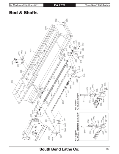

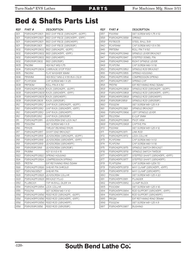

PSB1045PF0901
BED W/GAP
P
BED W/GAP
$60,285.10
PSB1045PF0903
Now: PN09M
HEX NUT M12-1.75
PSB1045PF0904
CARRIAGE STOP POST
PSB1045PF0905
Now: PW08M
FLAT WASHER 16MM
PSB1045PF0906
HEX BOLT M16-2 X 55 BLK C12.9
PSB1045PF0907
CAP SCREW M6-1 X 25
PSB1045PF0908
ROLL PIN 8 X 30
P
RACK
$1,166.20
P
GAP RACK
$416.95
PSB1045PF0911
LEADSCREW END LOCK NUT
PSB1045PF0915
SET SCREW M6-1 X 8
PSB1045PF0916
THRUST BEARING 51105
PSB1045PF0917
SHAFT END BRACKET
P
LEADSCREW
$2,427.75
PSB1045PF0919
Now: PK99M
KEY 6 X 6 X 15
PSB1045PF0920
SPRING HOUSING
PSB1045PF0924
COMPRESSION SPRING
PSB1045PF0925
Now: PR37M
EXT RETAINING RING 32MM
PSB1045PF0926
SHEAR PIN SHROUD
PSB1045PF0927
SHEAR PIN
PSB1045PF0928
LEADSCREW COLLAR
PSB1045PF0929
BRACKET PLUG
PSB1045PF0930
PSB1045PF0934
LOCK COLLAR
PSB1045PF0935
SET SCREW M6-1 X 10
P
FEED ROD
$1,225.35
PSB1045PF0937
PSB1045PF0938
SPRING
PSB1045PF0939
STEEL BALL 3/8
PSB1045PF0940
CAP SCREW M10-1.5 X 35
PSB1045PF0945
ROLL PIN 6 X 50
PSB1045PF0946
SPINDLE LEVER BRACKET ASSEMBLY
PSB1045PF0947
PSB1045PF0948
RIGHT SPINDLE LEVER
PSB1045PF0949
CAP SCREW M6-1 X 16
PSB1045PF0950
SPINDLE ROD BRACKET
PSB1045PF0955
PSB1045PF0956
COMPRESSION SPRING
PSB1045PF0957
SPRING CAP
PSB1045PF0958
Now: PR37M
P
SPINDLE ROD
$733.00
PSB1045PF0960
PSB1045PF0961
SPINDLE BRACKET
PSB1045PF0966
LEFT SPINDLE LEVER
PSB1045PF0967
E-CLIP 8MM
PSB1045PF0968
PIVOT ARM
PSB1045PF0969
CAPTIVE PIN
PSB1045PF0970
SET SCREW M8-1.25 X 12
PSB1045PF0971
LINK ROD
PSB1045PF0972
LOCK COLLAR
PSB1045PF0973
CAP SCREW M6-1 X 10
PSB1045PF0974
CAP SCREW M6-1 X 16
PSB1045PF0975
SPINDLE SWITCH BRACKET
PSB1045PF0976
SPINDLE SWITCH TM1308
P
STEPPED SHAFT
$177.85
PSB1045PF0978
CAP SCREW M8-1.25 X 70
P
WAY CLAMP
$449.85
PSB1045PF0980
PSB1045PF0981
PLUNGER
PSB1045PF0982
CLAMP BLOCK
PSB1045PF0983
P
ROD SUPPORT
$1,017.95
PSB1045PF0985
Now: PR12M
EXT RETAINING RING 35MM
PSB1045PF0986
PSB1045PF0987
BUSHING

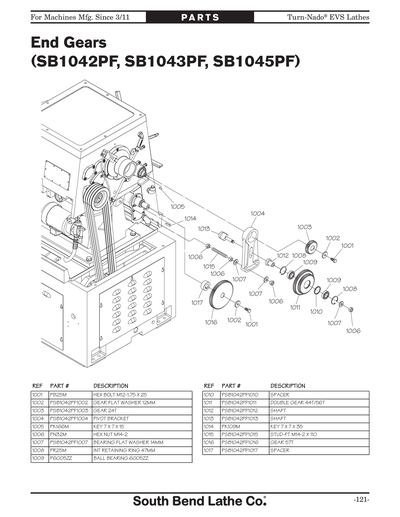

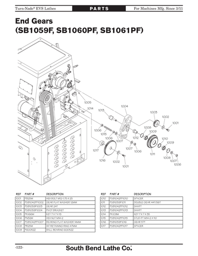

PSB1045PF1001
Now: PB25M
HEX BOLT M12-1.75 X 25
PSB1045PF1002
GEAR FLAT WASHER 12MM
PSB1045PF1003
GEAR 24T
PSB1045PF1004
PIVOT BRACKET
PSB1045PF1005
KEY 7 X 7 X 15
PSB1045PF1006
Now: PN32M
HEX NUT M14-2
PSB1045PF1007
BEARING FLAT WASHER 14MM
PSB1045PF1008
Now: PR25M
INT RETAINING RING 47MM
PSB1045PF1009
BALL BEARING 6005ZZ
PSB1045PF1010
SPACER
PSB1045PF1011
DOUBLE GEAR 44T/56T
PSB1045PF1012
SHAFT
PSB1045PF1013
SHAFT
PSB1045PF1014
KEY 7 X 7 X 35
PSB1045PF1015
STUD-FT M14-2 X 110
PSB1045PF1016
GEAR 57T
PSB1045PF1017
SPACER
PSB1045PF1101

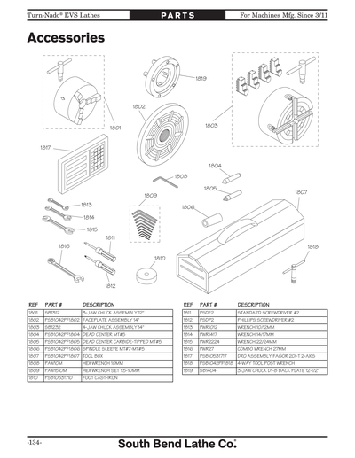

PSB1045PF1801
12" High Precision 3 Jaw Scroll Chuck
PSB1045PF1802
FACEPLATE ASSEMBLY 14"
PSB1045PF1803
14" 4 Jaw Ind. Chuck D1-8
PSB1045PF1804
DEAD CENTER MT#5
PSB1045PF1805
DEAD CENTER CARBIDE-TIPPED MT#5
PSB1045PF1806
SPINDLE SLEEVE MT#7-MT#5
PSB1045PF1807
TOOL BOX
PSB1045PF1808
HEX WRENCH 10MM
PSB1045PF1809
HEX WRENCH 1.5-10MM 10PC SET
PSB1045PF1810
FOOT CAST-IRON
PSB1045PF1811
Now: PSDF2
SCREWDRIVER FLAT #2
PSB1045PF1812
Now: PSDP2
SCREWDRIVER PHILLIPS #2
PSB1045PF1813
WRENCH 10 X 12MM OPEN-ENDS
PSB1045PF1814
WRENCH 14 X 17MM OPEN-ENDS
PSB1045PF1815
WRENCH 22 X 24MM OPEN-ENDS
PSB1045PF1816
Now: PWR27
WRENCH 27MM COMBO
PSB1045PF1817
DRO ASSEMBLY FAGOR 2-AXIS
PSB1045PF1818
TOOL POST WRENCH 4-WAY
PSB1045PF1819
12-1/2" D1-8 Back Plate
