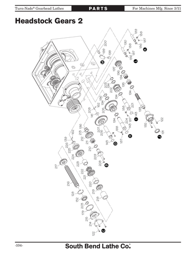

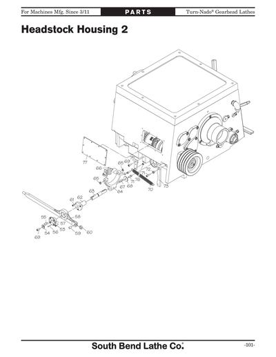

Parts for SB1058F - 18" x 80" Turn-Nado Gearhead Lathe with DRO
Part Diagram for SB1058F

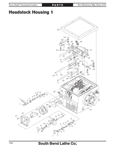

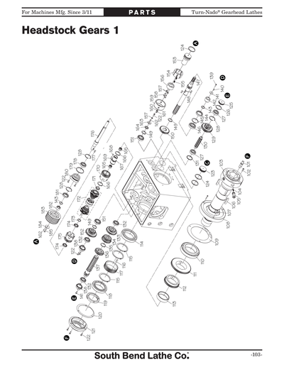

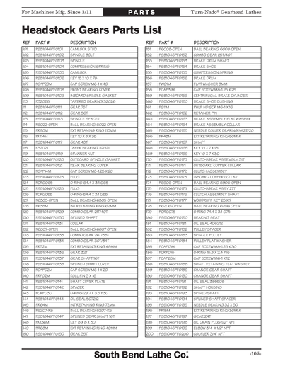

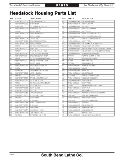

Ref #
Part #
Description
PSB1058F0001
SHIFT LEVER END CAP
PSB1058F0002
SHIFT LEVER
PSB1058F0003
CAP SCREW M5-.8 X 25
PSB1058F0004
SHAFT COLLAR
PSB1058F0005
KEY 4 X 4 X 15
PSB1058F0006
SHIFT LEVER SHAFT
PSB1058F0007
KEY 4 X 4 X 20
PSB1058F0008
DETENT PIN
PSB1058F0009
COMPRESSION SPRING
PSB1058F0010
SHIFT KNUCKLE
PSB1058F0011
EXT RETAINING RING 18MM
PSB1058F0012
SHIFT TAB
PSB1058F0013
PHLP HD SCR M6-1 X 20
PSB1058F0014
LEVER BEVELED WASHER
PSB1058F0015
SPEED SELECTION LEVER
PSB1058F0016
EXT RETAINING RING 30MM
PSB1058F0017
RANGE SELECTION LEVER
PSB1058F0018
KEY 5 X 5 X 14
PSB1058F0019
SPEED SLECTOR SHAFT
PSB1058F0020
KEY 5 X 5 X 14
PSB1058F0021
CAP SCREW M8-1.25 X 35
PSB1058F0022
LEVER HOUSING
PSB1058F0023
KEY 7 X 7 X 25
PSB1058F0024
RANGE SELECTOR SHAFT
PSB1058F0025
SELECTOR SLEEVE
PSB1058F0026
EXT RETAINING RING 35MM
PSB1058F0027
SELECTOR DISC
PSB1058F0028
SIGHT GLASS
PSB1058F0029
STEP PIN
PSB1058F0030
UPPER PIVOT ROD
PSB1058F0031
UPPER SHIFT YOKE
PSB1058F0032
E-CLIP 10MM
PSB1058F0033
SHIFT FORK
PSB1058F0034
SHIFT ARM PIVOT BOLT
PSB1058F0035
SHIFT ARM
PSB1058F0036
SHIFT FORK
PSB1058F0037
LOWER SHIFT YOKE
PSB1058F0038
LOWER PIVOT ROD
PSB1058F0039
CAP SCREW M6-1 X 30
PSB1058F0040
DETENT BRACKET
PSB1058F0041
SHIFT LIMIT PIN
PSB1058F0042
OIL TUBE
PSB1058F0043
SHIFT YOKE FRAME
PSB1058F0044
OIL FITTING
PSB1058F0045
PIVOT ARM BOLT HEX NUT
PSB1058F0046
PIVOT ROD LOCK COLLARS
PSB1058F0047
CAP SCREW M8-1.25 X 20
PSB1058F0048
SHIFT FORK
PSB1058F0049
OUTBOARD SIDE SHIFT LEVER
PSB1058F0050
HEADSTOCK TOP COVER
PSB1058F0051
HEADSTOCK HOUSING
PSB1058F0052
COMPRESSION SPRING
PSB1058F0053
FLAT HD SCR M5-.8 X 12
PSB1058F0054
FLAT WASHER 6MM
PSB1058F0055
KEY 6 X 6 X 20
PSB1058F0056
ROLL PIN 4 X 16
PSB1058F0057
FLANGE BUSHING
PSB1058F0058
LEVER
PSB1058F0059
PIVOT PIN
PSB1058F0060
LEVER ROLLER
PSB1058F0061
CAP SCREW M5-.8 X 10
PSB1058F0062
INNER LEVER SLEEVE
PSB1058F0063
LEVER SHAFT
PSB1058F0064
SHIFT FORK
PSB1058F0065
EXT RETAINING RING 10MM
PSB1058F0066
SHIFT TAB
PSB1058F0067
KEY 6 X 6 X 30
PSB1058F0068
RETAINING FLAT WASHER 6MM
PSB1058F0069
CAP SCREW M6-1 X 16
PSB1058F0070
EXTENSION SPRING
PSB1058F0071
CAP SCREW M6-1 X 20
PSB1058F0072
BUSHING
PSB1058F0073
DETENT PLATE
PSB1058F0074
SPRING HANGER
PSB1058F0075
SPRING PLATE
PSB1058F0076
HEX NUT M6-1
PSB1058F0077
HEADSTOCK REAR COVER
PSB1058F0101
CAMLOCK STUD
PSB1058F0102
SPINDLE BOLT
PSB1058F0103
SPINDLE
PSB1058F0104
COMPRESSION SPRING
PSB1058F0105
CAMLOCK
PSB1058F0106
KEY 15 X 10 X 78
PSB1058F0107
CAP SCREW M6-1 X 40
PSB1058F0108
FRONT BEARING COVER
PSB1058F0109
INBOARD SPINDLE GASKET
PSB1058F0110
TAPERED BEARING 32026
PSB1058F0111
GEAR 75T
PSB1058F0112
GEAR 56T
PSB1058F0113
SPINDLE SPACER
PSB1058F0114
BALL BEARING 6022 OPEN
PSB1058F0115
EXT RETAINING RING 110MM
PSB1058F0116
KEY 10 X 8 X 35
PSB1058F0117
GEAR 48T
PSB1058F0118
TAPERED BEARING 32021
PSB1058F0119
SPANNER NUT
PSB1058F0120
OUTBOARD SPINDLE GASKET
PSB1058F0121
REAR BEARING COVER
PSB1058F0122
PSB1058F0123
PLUG
PSB1058F0124
O-RING 64.4 X 3.1 G65
PSB1058F0125
PLUG
PSB1058F0126
O-RING 54.4 X 3.1 G55
PSB1058F0127
BALL BEARING 6305-OPEN
PSB1058F0128
INT RETAINING RING 62MM
PSB1058F0129
COMBO GEAR 21T/40T
PSB1058F0130
SPLINED SHAFT
PSB1058F0131
COLLAR
PSB1058F0132
BALL BEARING 6007-OPEN
PSB1058F0133
COMBO GEAR 26T/38T
PSB1058F0134
COMBO GEAR 30T/34T
PSB1058F0135
EXT RETAINING RING 48MM
PSB1058F0136
GEAR 32T
PSB1058F0137
GEAR SHAFT 16T
PSB1058F0138
SPLINED SHAFT COVER
PSB1058F0139
CAP SCREW M6-1 X 20
PSB1058F0140
ROLL PIN 3 X 16
PSB1058F0141
SHAFT COVER PLATE
PSB1058F0142
SPACER
PSB1058F0143
O-RING 29.7 X 3.5 P30
PSB1058F0144
OIL SEAL 507212
PSB1058F0145
INT RETAINING RING 72MM
PSB1058F0146
BALL BEARING 6207-RS
PSB1058F0147
SPLINED GEAR SHAFT 16T
PSB1058F0148
KEY 8 X 8 X 30
PSB1058F0149
EXT RETAINING RING 40MM
PSB1058F0150
GEAR 35T
PSB1058F0151
BALL BEARING 6008-OPEN
PSB1058F0152
COMBO GEAR 25T/40T
PSB1058F0153
BRAKE DRUM W/SHAFT
PSB1058F0154
BRAKE SHOE (SET OF 4)
PSB1058F0155
COMPRESSION SPRING
PSB1058F0156
BRAKE DRUM W/SHAFT
PSB1058F0157
FLAT WASHER 8MM
PSB1058F0158
CAP SCREW M8-1.25 X 25
PSB1058F0159
CENTRIFUGAL BRAKE CYLINDER
PSB1058F0160
BRAKE SHOE BUSHING
PSB1058F0161
PHLP HD SCR M6-1 X 16
PSB1058F0162
RETAINER PIN
PSB1058F0163
BRAKE ASSEMBLY FLAT WASHER
PSB1058F0164
BRAKE ASSEMBLY COLLAR
PSB1058F0165
NEEDLE ROLLER BEARING NK22/20
PSB1058F0166
EXT RETAINING RING 50MM
PSB1058F0167
SHAFT
PSB1058F0168
KEY 10 X 7 X 18
PSB1058F0169
KEY 10 X 7 X 30
PSB1058F0170
CLUTCH/GEAR ASSEMBLY 31T
PSB1058F0171
OUTBOARD COPPER COLLAR
PSB1058F0172
CLUTCH ASSEMBLY
PSB1058F0173
INBOARD COPPER COLLAR
PSB1058F0174
BALL BEARING 6906-OPEN
PSB1058F0175
CLUTCH/GEAR ASSY 27T
PSB1058F0176
CLUTCH ASSEMBLY SHAFT
PSB1058F0177
WOODRUFF KEY 25 X 7
PSB1058F0178
BALL BEARING 6206-OPEN
PSB1058F0179
O-RING 74.4 X 3.1 G75
PSB1058F0180
BEARING SEAT
PSB1058F0181
OIL SEAL 406212
PSB1058F0182
PULLEY SPACER
PSB1058F0183
SPINDLE PULLEY
PSB1058F0184
PULLEY FLAT WASHER
PSB1058F0185
CAP SCREW M8-1.25 X 30
PSB1058F0186
O-RING 15.8 X 2.4 P16
PSB1058F0187
CAP SCREW M6-1 X 12
PSB1058F0188
SHAFT RETAINING FLAT WASHER
PSB1058F0189
CHANGE GEAR SHAFT
PSB1058F0190
CHANGE GEAR SHAFT
PSB1058F0191
OIL SEAL 385508
PSB1058F0192
SHAFT HOUSING
PSB1058F0193
SPINED SHAFT
PSB1058F0194
SPLINED SHAFT SPACER
PSB1058F0195
NEEDLE BEARING 32 X 30
PSB1058F0196
PSB1058F0197
GEAR 24T
PSB1058F0198
OIL DRAIN PLUG 1/2" NPT
PSB1058F0199
ELBOW 3/4 X 1/2" NPT
PSB1058F0200
COUPLER 3/4" NPT

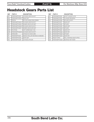

PSB1058F0201
CHANGE GEAR SHAFT
PSB1058F0202
GEAR 24T
PSB1058F0203
EXT RETAINING RING 32MM
PSB1058F0204
CHANGE GEAR SHAFT
PSB1058F0205
COMBO GEAR 24T/48T
PSB1058F0206
CHANGE GEAR SHAFT
PSB1058F0207
COMBO GEAR 48T/24T
PSB1058F0208
CAP SCREW M6-1 X 16
PSB1058F0209
CHANGE GEAR SHAFT
PSB1058F0210
O-RING 3.1 X 34.4 G35
PSB1058F0211
NEEDLE ROLLER BEARING NAX3030
PSB1058F0212
GEAR 28T
PSB1058F0213
CHANGE SPACER
PSB1058F0214
SHAFT COVER PLATE
PSB1058F0215
FLANGED BEARING
PSB1058F0216
SPLINED SHAFT
PSB1058F0217
GEAR 27T
PSB1058F0218
SPACER
PSB1058F0219
GEAR 23T
PSB1058F0220
SPACER
PSB1058F0221
GEAR 27T
PSB1058F0222
GEAR 19T
PSB1058F0223
SPACER
PSB1058F0224
GEAR 31T
PSB1058F0225
BALL BEARING 6207-OPEN
PSB1058F0226
BEARING RETAINER

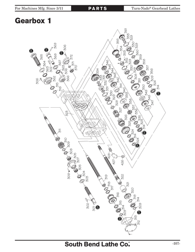

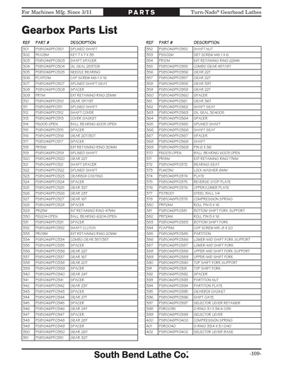

PSB1058F0301
SPLINED SHAFT
PSB1058F0302
KEY 7 X 7 X 35
PSB1058F0303
SHAFT SPACER
PSB1058F0304
OIL SEAL 253708
PSB1058F0305
NEEDLE BEARING
PSB1058F0306
CAP SCREW M6-1 X 16
PSB1058F0307
SPLINED SHAFT SEAT
PSB1058F0308
SPACER
PSB1058F0309
EXT RETAINING RING 25MM
PSB1058F0310
GEAR 19T/19T
PSB1058F0311
SPLINED SHAFT
PSB1058F0312
SHAFT COVER
PSB1058F0313
COVER GASKET
PSB1058F0314
BALL BEARING 6005-OPEN
PSB1058F0315
SPACER
PSB1058F0316
GEAR 20T/30T
PSB1058F0317
SPACER
PSB1058F0318
PSB1058F0319
SPLINED SHAFT
PSB1058F0320
GEAR 22T
PSB1058F0321
SHAFT SPACER
PSB1058F0322
SPLINED SHAFT
PSB1058F0323
GEARBOX CASTING
PSB1058F0324
SPACER
PSB1058F0325
GEAR 32T
PSB1058F0326
GEAR 23T
PSB1058F0327
GEAR 16T
PSB1058F0328
SPACER
PSB1058F0329
INT RETAINING RING 47MM
PSB1058F0330
BALL BEARING 6204-OPEN
PSB1058F0331
SPACER
PSB1058F0332
SHAFT CLUTCH
PSB1058F0333
EXT RETAINING RING 20MM
PSB1058F0334
COMBO GEAR 35T/35T
PSB1058F0335
SPACER
PSB1058F0336
GEAR 22T
PSB1058F0337

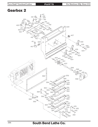

GEAR 16T
PSB1058F0338
GEAR 20T
PSB1058F0339
SPACER
PSB1058F0340
GEAR 24T
PSB1058F0341
SPACER
PSB1058F0342
GEAR 23T
PSB1058F0343
SPACER
PSB1058F0344
GEAR 27T
PSB1058F0345
SPACER
PSB1058F0346
GEAR 24T
PSB1058F0347
SPACER
PSB1058F0348
GEAR 28T
PSB1058F0349
SPACER
PSB1058F0350
GEAR 26T
PSB1058F0351
GEAR 32T
PSB1058F0352
SHAFT NUT
PSB1058F0353
SET SCREW M6-1 X 6
PSB1058F0354
EXT RETAINING RING 22MM
PSB1058F0355
COMBO GEAR 45T/18T
PSB1058F0356
GEAR 22T
PSB1058F0357
GEAR 22T
PSB1058F0358
GEAR 33T
PSB1058F0359
GEAR 22T
PSB1058F0360
SPACER
PSB1058F0361
GEAR 36T
PSB1058F0362
SHAFT SEAT
PSB1058F0363
OIL SEAL 304005
PSB1058F0364
SPACER
PSB1058F0365
SPLINED SHAFT
PSB1058F0366
SHAFT SEAT
PSB1058F0367
SPACER
PSB1058F0368
SHAFT
PSB1058F0369
PIN 6 X 36
PSB1058F0370
BALL BEARING 6003-OPEN
PSB1058F0371
EXT RETAINING RING 17MM
PSB1058F0372
BEARING SEAT
PSB1058F0373
LOCK WASHER 6MM
PSB1058F0374
PLATE
PSB1058F0375
REVERSE STOP PLATE
PSB1058F0376
UPPER/LOWER PLATE
PSB1058F0377
STEEL BALL 1/4
PSB1058F0378
COMPRESSION SPRING
PSB1058F0380
ROLL PIN 5 X 16
PSB1058F0381
BOTTOM SHIFT FORK SUPPORT
PSB1058F0382
ROLL PIN 5 X 16
PSB1058F0383
BOTTOM SHIFT FORK
PSB1058F0384
CAP SCREW M5-.8 X 20
PSB1058F0385
PARTITION
PSB1058F0386
LOWER-MID SHIFT FORK SUPPORT
PSB1058F0387
PSB1058F0388
UPPER-MID SHIFT FORK SUPPORT
PSB1058F0389
PSB1058F0390
TOP SHIFT FORK SUPPORT
PSB1058F0391
TOP SHIFT FORK
PSB1058F0392
SPACER
PSB1058F0393
PARTITION NUT
PSB1058F0394
PARTITION PLATE
PSB1058F0395
GEARBOX GASKET
PSB1058F0396
SHIFT GATE
PSB1058F0397
SELECTOR LEVER RETAINER

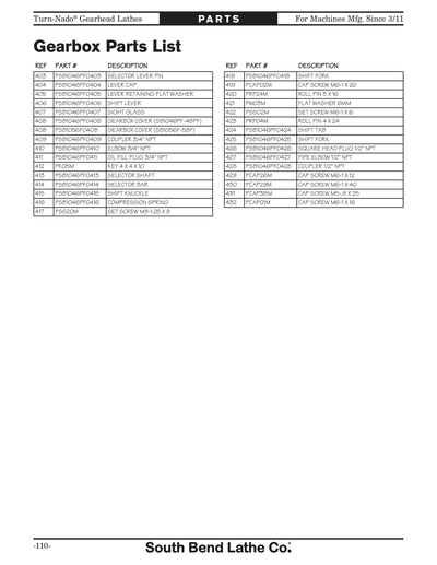

PSB1058F0398
PSB1058F0399
SELECTOR LEVER
PSB1058F0400
COMPRESSION SPRING
PSB1058F0401
O-RING 39.4 X 3.1 G40
PSB1058F0402
SELECTOR LEVER BASE
PSB1058F0403
SELECTOR LEVER PIN
PSB1058F0404
LEVER CAP
PSB1058F0405
LEVER RETAINING FLAT WASHER
PSB1058F0406
SHIFT LEVER
PSB1058F0407
SIGHT GLASS
PSB1058F0408
GEARBOX FRONT COVER
PSB1058F0409
COUPLER 3/4" NPT
PSB1058F0410
ELBOW 3/4" NPT
PSB1058F0411
OIL FILL PLUG 3/4" NPT
PSB1058F0412
KEY 4 X 4 X 10
PSB1058F0413
SELECTOR SHAFT
PSB1058F0414
SELECTOR BAR
PSB1058F0415
SHIFT KNUCKLE
PSB1058F0416
COMPRESSION SPRING
PSB1058F0417
SET SCREW M8-1.25 X 8
PSB1058F0418
SHIFT FORK
PSB1058F0419
CAP SCREW M6-1 X 20
PSB1058F0420
ROLL PIN 5 X 16
PSB1058F0421
FLAT WASHER 6MM
PSB1058F0422
SET SCREW M6-1 X 6
PSB1058F0423
ROLL PIN 4 X 24
PSB1058F0424
SHIFT TAB
PSB1058F0425
SHIFT FORK
PSB1058F0426
SQUARE HEAD PLUG 1/2" NPT
PSB1058F0427
PIPE ELBOW 1/2" NPT
PSB1058F0428
COUPLER 1/2" NPT
PSB1058F0429
CAP SCREW M6-1 X 12
PSB1058F0430
CAP SCREW M6-1 X 40
PSB1058F0431
PSB1058F0432
CAP SCREW M6-1 X 16

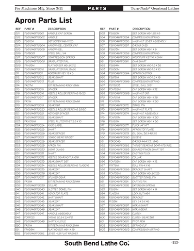

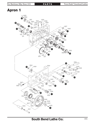

PSB1058F0501
HANDLE CAP SCREW
PSB1058F0502
HANDLE
PSB1058F0503
SET SCREW M6-1 X 25
PSB1058F0504
HANDWHEEL CENTER CAP
PSB1058F0505
HANDWHEEL
PSB1058F0506
STEEL BALL 1/4
PSB1058F0507
COMPRESSION SPRING
PSB1058F0508
GRADUATED DIAL
PSB1058F0509
PSB1058F0510
GRADUATED DIAL BASE
PSB1058F0511
WOODRUFF KEY 19 X 5
PSB1058F0512
GEAR SHAFT
PSB1058F0513
PLUG
PSB1058F0514
PSB1058F0515
SPACER
PSB1058F0516
NEEDLE ROLLER BEARING 18/20
PSB1058F0517
SPACER
PSB1058F0518
PSB1058F0519
GEAR 56T
PSB1058F0520
NEEDLE ROLLER BEARING 28/20
PSB1058F0521
NOTCHED SPACER
PSB1058F0522
GEAR SHAFT
PSB1058F0523
RIVET 2.8 X 10MM NAMEPLATE, STEEL
PSB1058F0524
KNOB LABEL
PSB1058F0525
SHAFT
PSB1058F0526
GEAR SPACER
PSB1058F0527
COMBO GEAR 15T/33T
PSB1058F0528
GEAR SPACER
PSB1058F0529
APRON PIN
PSB1058F0530
SIGHT GLASS
PSB1058F0531
SHAFT
PSB1058F0532
NEEDLE BEARING TLA1616
PSB1058F0533
GEAR SHAFT 26T
PSB1058F0534
NEEDLE ROLLER BEARING TLA3016
PSB1058F0535
GEAR 24T
PSB1058F0536
GEAR 24T
PSB1058F0537
SPLINED GEAR
PSB1058F0538
PSB1058F0539
COLLAR
PSB1058F0540
SLOTTED DOWEL PIN
PSB1058F0541
INDICATOR PLATE
PSB1058F0542
SHIFT SHAFT
PSB1058F0543
GEAR 24T
PSB1058F0545
GEAR SHAFT
PSB1058F0546
GEAR 24T
PSB1058F0547
HANDLE ASSEMBLY
PSB1058F0548
O-RING 20.8 X 2.4 P21
PSB1058F0549
SHIFT KNUCKLE
PSB1058F0550
EXT RETAINING RING 21MM
PSB1058F0551
FLAT HD SCR M6-1 X 16
PSB1058F0552
LEVER HUB FLAT WASHER
PSB1058F0553
PSB1058F0554
COMPRESSION SPRING
PSB1058F0555
HALF-NUT LEVER ASSEMBLY
PSB1058F0557
O-RING G-25
PSB1058F0558
SET SCREW M6-1 X 8
PSB1058F0559
COMPRESSION SPRING
PSB1058F0560
WOODRUFF KEY 16 X 5MM
PSB1058F0561
CAM SHAFT
PSB1058F0562
SET SCREW M10-1.5 X 35
PSB1058F0563
SET SCREW M10-1.5 X 10
PSB1058F0564
APRON CASTING
PSB1058F0565
SET SCREW M10-1.5 X 16
PSB1058F0566
COMPRESSION SPRING
PSB1058F0567
STEEL BALL 3/8
PSB1058F0568
CAP SCREW M6-1 X 12
PSB1058F0569
HALF-NUT GIB
PSB1058F0570
CAP SCREW M6-1 X 16
PSB1058F0571
CAP SCREW M6-1 X 30
PSB1058F0572
DOWEL PIN
PSB1058F0573
HALF-NUT PLATE
PSB1058F0574
HALF-NUT ASSEMBLY
PSB1058F0575
CAP SCREW M6-1 X 30
PSB1058F0576
SET SCREW M6-1 X 30
PSB1058F0577
PLUG 1/4" NPT
PSB1058F0578
APRON TOP PLATE
PSB1058F0579
OIL SEAL 30 X 40 X 5
PSB1058F0580
SLEEVE
PSB1058F0581
O-RING 44.4 X 3.1 G45
PSB1058F0582
THRUST BEARING 3047-NTB/AS2
PSB1058F0583
GEARED PINION SHAFT 18T
PSB1058F0584
CASTING PLUG
PSB1058F0585
COLLAR
PSB1058F0586
CAP SCREW M6-1 X 12
PSB1058F0587
ROLL PIN 4 X 16
PSB1058F0588
BRACKET SHAFT
PSB1058F0589
PSB1058F0590
SLOTTED DOWEL PIN
PSB1058F0591
CAPTIVE PIN
PSB1058F0592
EXTENSION SPRING
PSB1058F0593
SET SCREW M6-1 X 14
PSB1058F0594
LOCK NUT M6-1
PSB1058F0595
BRACKET
PSB1058F0596
KEY 5 X 5 X 45
PSB1058F0597
WORM SHAFT
PSB1058F0598
WORM GEAR

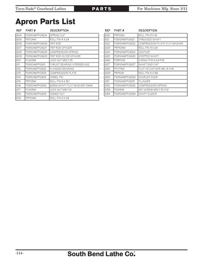

PSB1058F0599
CLUTCH
PSB1058F0600
CLUTCH GEAR 36T
PSB1058F0601
PIVOT ARM
PSB1058F0602
SPRING CUP
PSB1058F0603
COMPRESSION SPRING
PSB1058F0604
SPRING CUP
PSB1058F0605
ROLL PIN 4 X 24
PSB1058F0606
TRIP ROD
PSB1058F0607
TRIP ROD SPACER
PSB1058F0608
COMPRESSION SPRING
PSB1058F0609
TRIP ROD OUTER SPACER
PSB1058F0610
LOCK NUT M12-1.75
PSB1058F0611
THRUST BEARING NTB1528/AS2
PSB1058F0612
FLANGED BEARING
PSB1058F0613
COMPRESSION PLATE
PSB1058F0614
DOWEL PIN
PSB1058F0615
ROLL PIN 5 X 30
PSB1058F0616
WORM SHAFT FLAT WASHER 10MM
PSB1058F0617
LOCK NUT M10-1.5
PSB1058F0618
THREADED SHAFT W/DOMED NUT
PSB1058F0619
ROLL PIN 4 X 24
PSB1058F0620
ROLL PIN 3 X 16
PSB1058F0621
PSB1058F0622
COMPRESSION PLATE FLAT WASHER
PSB1058F0623
ROLL PIN 3 X 24
PSB1058F0624
COUPLER
PSB1058F0625
STEPPED SHAFT
PSB1058F0626
O-RING 17.8 X 2.4 P18
PSB1058F0627
SHAFT END CAP
PSB1058F0628
FLAT HD CAP SCR M5-.8 X 16
PSB1058F0629
ROLL PIN 5 X 36
PSB1058F0630
KNURLED KNOB
PSB1058F0631
PLUNGER
PSB1058F0632
COMPRESSION SPRING
PSB1058F0633
SET SCREW M12-1.75 X 12
PSB1058F0634
SHAFT SLEEVE

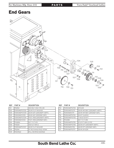

PSB1058F0701
HEX BOLT M12-1.75 X 25
PSB1058F0702
GEAR FLAT WASHER
PSB1058F0703
GEAR 24T
PSB1058F0704
PIVOT ARM
PSB1058F0705
KEY 7 X 7 X 15
PSB1058F0706
HEX NUT M14-2
PSB1058F0707
GEAR FLAT WASHER
PSB1058F0708
PSB1058F0709
BALL BEARING 6005ZZ
PSB1058F0710
SPACER
PSB1058F0711
GEAR 44T/56T
PSB1058F0712
SHAFT SLEEVE
PSB1058F0713
T-HEAD SHAFT
PSB1058F0714
KEY 7 X 7 X 35
PSB1058F0715
STUD-FT M14-2 X 110
PSB1058F0716
GEAR 57T
PSB1058F0717
GEAR SPACER

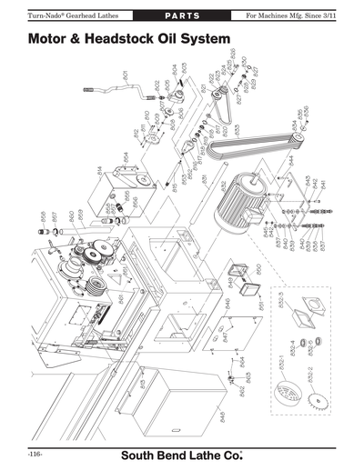

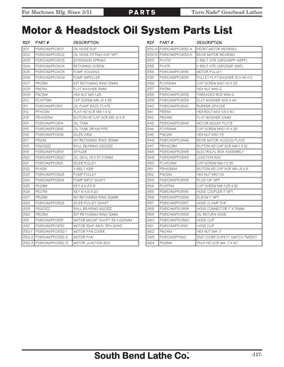

PSB1058F0801
OIL HOSE 5/8"
PSB1058F0802
PULLEY PUMP ASSEMBLY
PSB1058F0803
PSB1058F0804
PSB1058F0805
PSB1058F0806
PSB1058F0807
EXT RETAINING RING 15MM
PSB1058F0808
FLAT WASHER 8MM
PSB1058F0809
HEX NUT M8-1.25
PSB1058F0810
CAP SCREW M5-.8 X 35
PSB1058F0811
PSB1058F0812
FLAT HD SCR M6-1 X 12
PSB1058F0813
BUTTON HD CAP SCR M5-.8 X 8
PSB1058F0814
OIL TANK
PSB1058F0815
OIL TANK DRAIN PIPE
PSB1058F0816
PSB1058F0817
INT RETAINING RING 35MM
PSB1058F0818
BALL BEARING 6202ZZ
PSB1058F0819
PSB1058F0820
PSB1058F0821
PSB1058F0822
V-BELT A38
PSB1058F0823
PSB1058F0824
PSB1058F0825
KEY 4 X 4 X 8
PSB1058F0826
KEY 6 X 6 X 20
PSB1058F0827
INT RETAINING RING 32MM
PSB1058F0828
PSB1058F0829
BALL BEARING 6201ZZ
PSB1058F0830
EXT RETAINING RING 12MM
PSB1058F0831
MOTOR MOUNT SHAFT 32 X 625MM
PSB1058F0832
MOTOR 15HP 440V 3PH 60HZ
PSB1058F0832-1
MOTOR FAN COVER
PSB1058F0832-2
MOTOR FAN
PSB1058F0832-3
MOTOR JUNCTION BOX
PSB1058F0832-4
FRONT MOTOR BEARING
PSB1058F0832-5
REAR MOTOR BEARING
PSB1058F0833
V-BELT A75
PSB1058F0834
MOTOR PULLEY
PSB1058F0835
PULLEY FLAT WASHER 12 X 45 X 5
PSB1058F0836
CAP SCREW M10-1.5 X 25
PSB1058F0837
HEX NUT M16-2
PSB1058F0838
THREADED ROD M16-2
PSB1058F0839
FLAT WASHER 16.5 X 40
PSB1058F0840
RUBBER SPACER
PSB1058F0841
HEX BOLT M10-1.5 X 40
PSB1058F0842
FLAT WASHER 10MM
PSB1058F0843
MOTOR MOUNT PLATE
PSB1058F0844
PSB1058F0845
HEX NUT M10-1.5
PSB1058F0846
REAR MOTOR ACCESS PLATE
PSB1058F0847
BUTTON HD CAP SCR M6-1 X 12
PSB1058F0848
ELECTRICAL BOX ASSEMBLY
PSB1058F0849
JUNCTION BOX
PSB1058F0850
CAP SCREW M6-1 X 25
PSB1058F0851
PSB1058F0852
HEX NUT M10-1.5
PSB1058F0853
PLUG 1/4" NPT
PSB1058F0854
CAP SCREW M8-1.25 X 16
PSB1058F0855
HOSE COUPLER 1" NPT
PSB1058F0856
ELBOW 1" NPT
PSB1058F0857
HOSE CLAMP 3/4"
PSB1058F0858
HOSE CONNECTOR 1" X 75MM
PSB1058F0859
OIL RETURN HOSE
PSB1058F0860
HOSE CLIP
PSB1058F0861
HOSE CLIP
PSB1058F0862
HEX NUT M4-.7
PSB1058F0863
END COVER SAFETY SWITCH TM1307
PSB1058F0864
PHLP HD SCR M4-.7 X 40

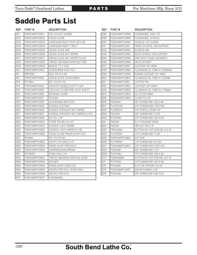

PSB1058F0901
GIB ADJUST SCREW
PSB1058F0902
CROSS SLIDE
PSB1058F0903
COMPOUND REST PIVOT 25 X 40
PSB1058F0904
COMPOUND REST T-BOLT
PSB1058F0905
CROSS SLIDE GIB
PSB1058F0906
CROSS SLIDE WAY WIPER
PSB1058F0907
CROSS SLIDE WAY WIPER PLATE
PSB1058F0908
THRUST BEARING NTB/AS2 1730
PSB1058F0909
CROSS SLIDE LEADSCREW ASSY
PSB1058F0910
PSB1058F0911
ROLL PIN 5 X 40
PSB1058F0912
PSB1058F0913
KEY 3 X 3 X 115
PSB1058F0914
COOLANT NOZZLE 3/8 PT X 24"
PSB1058F0915
COOLANT STAND PIPE ASSY 3/8 PT
PSB1058F0916
BEARING COVER
PSB1058F0917
SPACER
PSB1058F0918
LEADSCREW BRACKET
PSB1058F0919
SADDLE CASTING
PSB1058F0920
SADDLE STRAIGHT WAY WIPER
PSB1058F0921
SADDLE STRAIGHT WAY WIPER PLATE
PSB1058F0922
OIL FILL CAP
PSB1058F0923
TAPER PIN #6 X 2-1/2"
PSB1058F0924
SADDLE V-WAY WIPER
PSB1058F0925
SADDLE V-WAY WIPER PLATE
PSB1058F0926
CROSS SLIDE PINION SHAFT 16T
PSB1058F0927
KEY 3 X 3 X 20
PSB1058F0928
SHAFT CAP M16-2 X 5
PSB1058F0929
PINION SHAFT BRACKET
PSB1058F0930
COMPRESSION SPRING
PSB1058F0931
STEEL BALL 1/4
PSB1058F0932
THRUST BEARING NTB/AS2 2035
PSB1058F0933
SPACER
PSB1058F0934
PINION SHAFT END CAP
PSB1058F0935
GRADUATED DIAL BASE RING
PSB1058F0936
GRADUATED DIAL
PSB1058F0937
HANDWHEEL
PSB1058F0938
HANDWHEEL END CAP
PSB1058F0939
HANDWHEEL HANDLE
PSB1058F0940
HANDLE CAP SCREW
PSB1058F0941
FRONT SADDLE GIB SUPPORT
PSB1058F0942
SADDLE GIB
PSB1058F0943
REAR SADDLE GIB SUPPORT

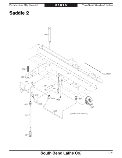

PSB1058F0944
ONE-SHOT OILER ASSEMBLY
PSB1058F0946
GEAR 16T/36T
PSB1058F0947
COUPLER 1/8"-4MM
PSB1058F0948
ALUMINUM OIL TUBE 4 X 258MM
PSB1058F0949
ELBOW COUPLER 1/8"-4MM
PSB1058F0950
ALUMINUM OIL TUBE 4 X 121MM
PSB1058F0951
CAPTIVE PIN
PSB1058F0952
COUPLER 1/8"-6MM
PSB1058F0953
ALUMINUM OIL TUBE 6 X 175MM
PSB1058F0954
OIL FILTER 6MM
PSB1058F0955
CLAMP PLATE
PSB1058F0956
SET SCREW M8-1.25 X 40
PSB1058F0957
CAP SCREW M12-1.75 X 85
PSB1058F0958
BALL OILER 1/4 PRESS-IN
PSB1058F0959
SET SCREW M6-1 X 25
PSB1058F0960
PSB1058F0961
FLAT WASHER 10MM
PSB1058F0962
HEX NUT M10-1.5
PSB1058F0963
BUTTON HD CAP SCR M5-.8 X 12
PSB1058F0964
CAP SCREW M6-1 X 25
PSB1058F0965
NUT M16
PSB1058F0966
PSB1058F0967
CAP SCREW M10-1.25 X 80
PSB1058F0968
SET SCREW M6-1 X 8
PSB1058F0969
PSB1058F0970
BUTTON HD CAP SCR M5-.8 X 10
PSB1058F0971
CAP SCREW M8-1.25 X 40
PSB1058F0972
PSB1058F0973
GIB RETAINING CLIP
PSB1058F0974
SET SCREW M8-1.25 X 20

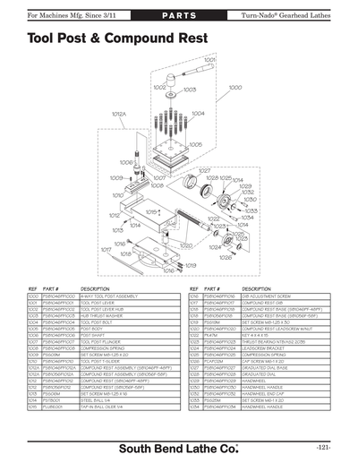

PSB1058F1000
TOOL POST ASSEMBLY 4-WAY
PSB1058F1001
TOOL POST LEVER
PSB1058F1002
TOOL POST LEVER HUB
PSB1058F1003
HUB THRUST WASHER
PSB1058F1004
TOOL POST BOLT
PSB1058F1005
POST BODY
PSB1058F1006
POST SHAFT
PSB1058F1007
TOOL POST PLUNGER
PSB1058F1008
COMPRESSION SPRING
PSB1058F1009
PSB1058F1010
TOOL POST T-SLIDER
PSB1058F1012
COMPOUND REST W/GIB AND BASE
PSB1058F1012A
COMPOUND REST ASSEMBLY
PSB1058F1013
SET SCREW M8-1.25 X 16
PSB1058F1014
STEEL BALL 1/4
PSB1058F1015
PSB1058F1016
GIB ADJUSTMENT SCREW
PSB1058F1017
COMPOUND REST GIB
PSB1058F1018
PSB1058F1019
SET SCREW M8-1.25 X 30
PSB1058F1020
COMPOUND REST LEADSCREW W/NUT
PSB1058F1022
KEY 4 X 4 X 15
PSB1058F1023
PSB1058F1024
LEADSCREW BRACKET
PSB1058F1025
COMPRESSION SPRING
PSB1058F1026
CAP SCREW M6-1 X 20
PSB1058F1027
GRADUATED DIAL BASE
PSB1058F1028
GRADUATED DIAL
PSB1058F1029
HANDWHEEL
PSB1058F1030
HANDWHEEL HANDLE
PSB1058F1032
HANDWHEEL END CAP
PSB1058F1033
SET SCREW M6-1 X 20
PSB1058F1034
HANDWHEEL HANDLE

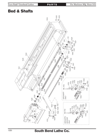

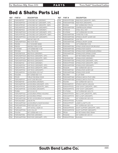

PSB1058F1101
LATHE BED W/GAP
PSB1058F1102
LATHE BED W/GAP
PSB1058F1103
HEX NUT M12-1.75
PSB1058F1104
BED STOP BOLT
PSB1058F1105
FLAT WASHER 16MM
PSB1058F1106
HEX BOLT M16-2 X 55
PSB1058F1107
CAP SCREW M6-1 X 25
PSB1058F1108
ROLL PIN 6 X 30
PSB1058F1109
BED RACK 2PC
PSB1058F1110
BED RACK 2PC
PSB1058F1111
LEADSCREW LOCK NUT
PSB1058F1115
SET SCREW M6-1 X 8
PSB1058F1116
THRUST BEARING 51105
PSB1058F1117
SHAFT END BRACKET
PSB1058F1118
LONGITUDINAL LEADSCREW
PSB1058F1119
KEY 6 X 6 X 15
PSB1058F1120
LEADSCREW SPRING HOUSING
PSB1058F1125
LEADSCREW SPRING
PSB1058F1126
KEYED LEADSCREW FLAT WASHER
PSB1058F1127
SHEAR PIN
PSB1058F1128
LEADSCREW FLANGE BUSHING
PSB1058F1129
FEED ROD END CAP
PSB1058F1130
PSB1058F1134
LOCK COLLAR
PSB1058F1135
SET SCREW M6-1 X 10
PSB1058F1136
FEED ROD
PSB1058F1137
PSB1058F1138
COMPRESSION SPRING
PSB1058F1139
STEEL BALL 3/8
PSB1058F1140
CAP SCREW M10-1.5 X 35
PSB1058F1145
TAPER PIN 7 X 45
PSB1058F1146
SPINDLE ON/OFF LEVER HUB
PSB1058F1147
STEP PIN
PSB1058F1148
PSB1058F1149
CAP SCREW M6-1 X 16
PSB1058F1150
SPINLE LEVER SELECTOR BRACKET
PSB1058F1155
SPINDLE ROD SLEEVE
PSB1058F1156
SPINDLE ROD COMPRESSION SPRING
PSB1058F1157
SPINDLE ROD SPRING COVER
PSB1058F1158
PSB1058F1159
SPINDLE ROD
PSB1058F1160
PSB1058F1161
SPINDLE ROD LEVER HUB
PSB1058F1166
SPINDLE ROD LEVER
PSB1058F1167
E-CLIP 8MM
PSB1058F1168
SPINDLE SWITCH PIVOT ARM
PSB1058F1169
SPINDLE SWITCH PIVOT PIN
PSB1058F1170
SET SCREW M8-1.25 X 12
PSB1058F1171
SPINDLE SWITCH LINKAGE
PSB1058F1172
STEP SHAFT
PSB1058F1173
CAP SCREW M8-1.25 X 70
PSB1058F1174
BED CLAMP
PSB1058F1175
PSB1058F1176
PLUNGER
PSB1058F1177
LOWER CLAMP PLATE
PSB1058F1178
PSB1058F1179
SHAFT SUPPORT
PSB1058F1180
PSB1058F1181
PSB1058F1182
BUSHING

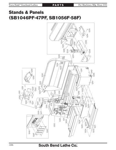

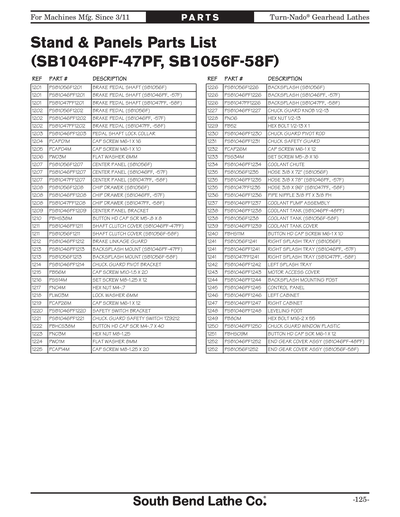

PSB1058F1201
BRAKE PEDAL SHAFT
PSB1058F1202
BRAKE PEDAL
PSB1058F1203
PEDAL SHAFT LOCK COLLAR
PSB1058F1204
CAP SCREW M6-1 X 16
PSB1058F1205
CAP SCREW M6-1 X 10
PSB1058F1206
FLAT WASHER 6MM
PSB1058F1207
CENTER PANEL
PSB1058F1208
CHIP DRAWER
PSB1058F1209
CENTER PANEL BRACKET
PSB1058F1210
PSB1058F1211
SHAFT CLUTCH COVER
PSB1058F1212
BRAKE LINKAGE GUARD
PSB1058F1213
BACKSPLASH MOUNTING PLATE
PSB1058F1214
CHUCK GUARD PIVOT BRACKET
PSB1058F1215
CAP SCREW M3-.5 X 10
PSB1058F1216
PSB1058F1217
HEX NUT M4-.7
PSB1058F1218
LOCK WASHER 6MM
PSB1058F1219
CAP SCREW M6-1 X 12
PSB1058F1220
SAFETY SWITCH BRACKET
PSB1058F1221
CHUCK GUARD SAFETY SWITCH TZ9212
PSB1058F1222
BUTTON HD CAP SCR M4-.7 X 40
PSB1058F1223
HEX NUT M8-1.25
PSB1058F1224
FLAT WASHER 8MM
PSB1058F1225
PSB1058F1226
BACKSPLASH
PSB1058F1227
CHUCK GUARD KNOB 1/2-13
PSB1058F1228
HEX NUT 1/2-12
PSB1058F1229
HEX BOLT 1/2-13 X 1
PSB1058F1230
CHUCK GUARD PIVOT ROD
PSB1058F1231
CHUCK SAFETY GUARD
PSB1058F1232
CAP SCREW M6-1 X 12
PSB1058F1233
SET SCREW M5-.8 X 16
PSB1058F1234
COOLANT CHUTE
PSB1058F1235
COOLANT HOSE 3/8 X 96"
PSB1058F1236
PIPE NIPPLE 3/8 PT X 3/8 PH
PSB1058F1237
COOLANT PUMP ASSEMBLY
PSB1058F1238
COOLANT TANK
PSB1058F1239
COOLANT TANK COVER
PSB1058F1240
BUTTON HD CAP SCR M6-1 X 10
PSB1058F1241
RIGHT SPLASH TRAY
PSB1058F1242
LEFT SPLASH TRAY
PSB1058F1243
MOTOR ACCESS COVER
PSB1058F1244
BACKSPLASH MOUNTING POST
PSB1058F1245
CONTROL PANEL PLATE
PSB1058F1246
LEFT CABINET
PSB1058F1247
RIGHT CABINET
PSB1058F1248
LEVELING FOOT
PSB1058F1249
HEX BOLT M16-2 X 55
PSB1058F1250
CHUCK GUARD WINDOW PLASTIC
PSB1058F1251
PSB1058F1252
END GEAR COVER ASSEMBLY

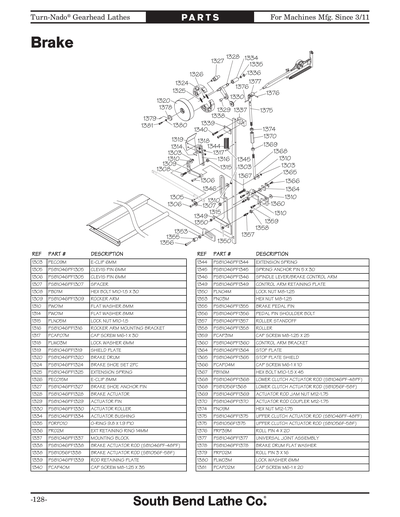

PSB1058F1303
E-CLIP 6MM
PSB1058F1305
CLEVIS PIN 6MM
PSB1058F1306
CLEVIS PIN 6MM
PSB1058F1307
SPACER
PSB1058F1308
HEX BOLT M10-1.5 X 30
PSB1058F1309
ROCKER ARM
PSB1058F1310
FLAT WASHER 8MM
PSB1058F1314
FLAT WASHER 8MM
PSB1058F1315
LOCK NUT M10-1.5
PSB1058F1316
ROCKER ARM MOUNTING BRACKET
PSB1058F1317
CAP SCREW M6-1 X 30
PSB1058F1318
LOCK WASHER 6MM
PSB1058F1319
SHIELD PLATE
PSB1058F1320
BRAKE DRUM
PSB1058F1324
BRAKE SHOE SET 2PC W/SPRING
PSB1058F1325
PSB1058F1326
E-CLIP 8MM
PSB1058F1327
BRAKE SHOE ANCHOR PIN
PSB1058F1328
BRAKE ACTUATOR
PSB1058F1329
ACTUATOR PIN
PSB1058F1330
ACTUATOR ROLLER
PSB1058F1334
ACTUATOR BUSHING
PSB1058F1335
O-RING 9.8 X 1.9 P10
PSB1058F1336
EXT RETAINING RING 14MM
PSB1058F1337
MOUNTING BLOCK
PSB1058F1338
BRAKE ACTUATOR ROD
PSB1058F1339
ROD RETAINING PLATE
PSB1058F1340
PSB1058F1344
EXTENSION SPRING
PSB1058F1345
SPRING ANCHOR PIN 5 X 40
PSB1058F1346
SPINDLE LEVER/BRAKE CONTROL ARM
PSB1058F1349
CONTROL ARM RETAINING PLATE
PSB1058F1350
LOCK NUT M8-1.25
PSB1058F1353
HEX NUT M8-1.25
PSB1058F1355
BRAKE PEDAL PIN
PSB1058F1356
PEDAL PIN SHOULDER BOLT
PSB1058F1357
ROLLER STANDOFF
PSB1058F1358
ROLLER
PSB1058F1359
PSB1058F1360
CONTROL ARM BRACKET
PSB1058F1364
STOP PLATE
PSB1058F1365
STOP PLATE SHIELD
PSB1058F1366
CAP SCREW M6-1 X 10
PSB1058F1367
HEX BOLT M10-1.5 X 45
PSB1058F1368
LOWER CLUTCH ACTUATOR ROD
PSB1058F1369
ACTUATOR ROD JAM NUT M12-1.75
PSB1058F1370
ACTUATOR ROD COUPLER M12-1.75
PSB1058F1374
HEX NUT M12-1.75
PSB1058F1375
UPPER CLUTCH ACTUATOR ROD
PSB1058F1376
ROLL PIN 4 X 20
PSB1058F1377
UNIVERSAL JOINT ASSEMBLY
PSB1058F1378
BRAKE DRUM FLAT WASHER
PSB1058F1379
ROLL PIN 3 X 16
PSB1058F1380
LOCK WASHER 6MM
PSB1058F1381
CAP SCREW M6-1 X 20

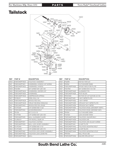

PSB1058F1400
TAILSTOCK ASSEMBLY
PSB1058F1401
HANDWHEEL HANDLE CAP SCREW
PSB1058F1402
HANDWHEEL HANDLE
PSB1058F1403
PSB1058F1404
PSB1058F1405
HANDWHEEL
PSB1058F1406
COMPRESSION SPRING
PSB1058F1407
STEEL BALL 1/4
PSB1058F1408
GRADUATED DIAL
PSB1058F1409
PSB1058F1410
GRADUATED DIAL BASE
PSB1058F1411
CAP SCREW M6-1 X 20
PSB1058F1412
LEADSCREW W/NUT
PSB1058F1413
KEY 5 X 5 X 12
PSB1058F1414
PSB1058F1415
QUILL ALIGNMENT GUIDE
PSB1058F1416
PSB1058F1417
TAILSTOCK CASTING
PSB1058F1418
QUILL LOCK LEVER ASSEMBLY
PSB1058F1419
CAP SCREW M6-1 X 10
PSB1058F1420
PSB1058F1421
TAILSTOCK LOCK LEVER ASSEMBLY
PSB1058F1422
PSB1058F1423
QUILL
PSB1058F1424
HEX NUT M18-2.5
PSB1058F1425
FLAT WASHER 18MM
PSB1058F1426
OFFSET INDICATOR PLATE
PSB1058F1427
SET SCREW M10-1.5 X 30
PSB1058F1428
ALIGNMENT PIN
PSB1058F1429
PIVOT BLOCK
PSB1058F1430
BUTTON HD CAP SCR M5-.8 X 16
PSB1058F1431
V-WAY WIPER PLATE
PSB1058F1432
V-WAY WIPER
PSB1058F1433
PSB1058F1434
STRAIGHT WAY WIPER
PSB1058F1435
TAILSTOCK BASE
PSB1058F1436
FLAT WASHER 18MM
PSB1058F1437
LOCK WASHER 18MM
PSB1058F1438
TAILSTOCK ANCHOR BOLT
PSB1058F1439
TAILSTOCK GIB
PSB1058F1440
TAILSTOCK GIB ADJUST SCREW
PSB1058F1441
CLAMP PLATE
PSB1058F1442
TAILSTOCK MOUNTING BOLT
PSB1058F1443
CLAMP BLOCK
PSB1058F1444
TAILSTOCK MOUNTING STUD AND NUT ASSY.
PSB1058F1445
ROLL PIN 6 X 36
PSB1058F1446

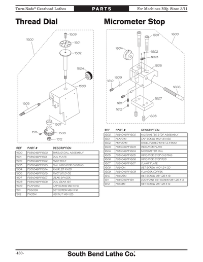

PSB1058F1500
THREAD DIAL ASSEMBLY
PSB1058F1501
DIAL PLATE
PSB1058F1502
PIVOT BOLT
PSB1058F1503
DIAL INDICATOR CASTING
PSB1058F1504
KNURLED KNOB
PSB1058F1505
PIVOT STUD-DE M8-125 X 115 12/18
PSB1058F1507
GEAR SPACER
PSB1058F1508
DIAL GEAR 16T
PSB1058F1509
CAP SCREW M6-1 X 10
PSB1058F1511
SET SCREW M6-1 X 6
PSB1058F1512
HEX NUT M8-1.25
PSB1058F1600
MICROMETER STOP ASSEMBLY
PSB1058F1601
CAP SCREW M10-1.5 X 60
PSB1058F1602
PSB1058F1603
INDICATOR PLATE
PSB1058F1604
MICROMETER DIAL
PSB1058F1605
INDICATOR STOP CASTING
PSB1058F1606
INDICATOR STOP ROD
PSB1058F1607
CLAMP PLATE
PSB1058F1608
SET SCREW M10-1.5 X 20
PSB1058F1609
PLUNGER COPPER
PSB1058F1610
PSB1058F1611
DOG PT SET SCR M8-1.25 X 12
PSB1058F1612

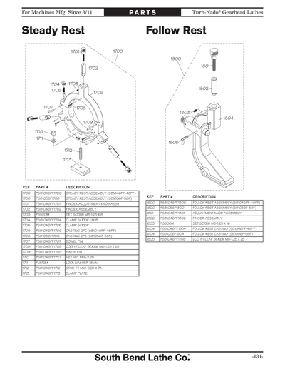

PSB1058F1700
STEADY REST ASSEMBLY
PSB1058F1701
FINGER AND ADJUSTMENT KNOB ASSY
PSB1058F1702
PSB1058F1703
PSB1058F1704
CLAMP SCREW KNOB
PSB1058F1705
CLAMP SCREW
PSB1058F1706
PSB1058F1707
DOWEL PIN
PSB1058F1708
DOG PT LEAF SCR M8-1.25 X 25
PSB1058F1709
HINGE PIN
PSB1058F1710
HEX NUT M16-2
PSB1058F1711
LOCK WASHER 18MM
PSB1058F1712
STUD-FT M16-2 X 120
PSB1058F1713
CLAMP PLATE
PSB1058F1800
FOLLOW REST ASSEMBLY
PSB1058F1801
ADJUSTMENT KNOB ASSEMBLY
PSB1058F1802
FINGER ASSEMBLY
PSB1058F1803
PSB1058F1804
PSB1058F1805

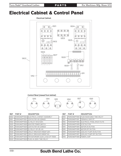

PSB1058F1900
ELECTRICAL CABINET ASSEMBLY
PSB1058F1901
CONTACTOR AB C23400
PSB1058F1902
OL RELAY AB 193T1AC25 21-25A
PSB1058F1903
MASTER POWER SWITCH
PSB1058F1904
CONTACTOR AB C09400
PSB1058F1905
OL RELAY AB .25-.4A
PSB1058F1906
CIRCUIT BREAKER 25A AB 1492-SP D25 3P
PSB1058F1907
CIRCUIT BREAKER 6A AB 1489-A D6 1P
PSB1058F1908
TRANSFORMER TBSW11 140VA 220/440-24/220V
PSB1058F1909
FUSE 4A 250V TIME-DELAY
PSB1058F1910
FUSE 500M 250V TIME-DELAY
PSB1058F1911
TERMINAL BAR 6P
PSB1058F1912
ELECTRICAL PANEL BACK PLATE
PSB1058F1913
STOP BUTTON
PSB1058F1914
MOTOR ON BUTTON
PSB1058F1915
MOTOR OFF BUTTON
PSB1058F1916
COOLANT PUMP ON BUTTON
PSB1058F1917
COOLANT PUMP OFF BUTTON
PSB1058F1918
POWER INDICATOR LIGHT AB 800FD P7N3 22MM

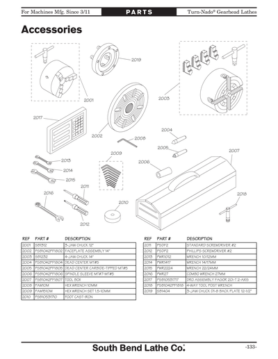

PSB1058F2001
12" High Precision 3 Jaw Scroll Chuck
PSB1058F2002
FACEPLATE ASSEMBLY 14"
PSB1058F2003
14" 4 Jaw Ind. Chuck D1-8
PSB1058F2004
DEAD CENTER MT#5
PSB1058F2005
DEAD CENTER CARBIDE-TIPPED MT#5
PSB1058F2006
SPINDLE SLEEVE MT#7-MT#5
PSB1058F2007
TOOL BOX
PSB1058F2008
HEX WRENCH 10MM
PSB1058F2009
HEX WRENCH 1.5-10MM 10PC SET
PSB1058F2010
FOOT CAST-IRON
PSB1058F2011
SCREWDRIVER FLAT #2
PSB1058F2012
SCREWDRIVER PHILLIPS #2
PSB1058F2013
WRENCH 10 X 12MM OPEN-ENDS
PSB1058F2014
WRENCH 14 X 17MM OPEN-ENDS
PSB1058F2015
WRENCH 22 X 24MM OPEN-ENDS
PSB1058F2016
WRENCH 27MM COMBO
PSB1058F2017
DRO ASSEMBLY FAGOR 2-AXIS
PSB1058F2018
TOOL POST WRENCH 4-WAY
PSB1058F2019
12-1/2" D1-8 Back Plate

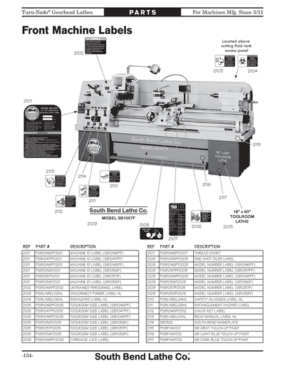

PSB1058F2102
UNTRAINED PERSONNEL LABEL

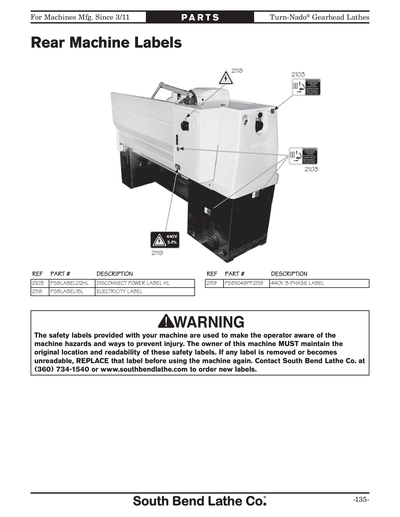

PSB1058F2103
DISCONNECT POWER LABEL 3.25 X 2
PSB1058F2104
BIOHAZARD LABEL 3.25 X 2
PSB1058F2105
TOOLROOM SIZE LABEL
PSB1058F2106
CARRIAGE LOCK LABEL
PSB1058F2107
THREAD CHART
PSB1058F2108
ONE SHOT OILER LABEL
PSB1058F2109
MODEL NUMBER LABEL
PSB1058F2110
SAFETY GLASSES LABEL 3.25 X 2
PSB1058F2111
ENTANGLEMENT LABEL 3.25 X 2
PSB1058F2112
CHUCK KEY LABEL
PSB1058F2113
READ MANUAL LABEL 3.25 X 2
PSB1058F2114
Nameplate 255mm
PSB1058F2115
SB GRAY TOUCH-UP AEROSOL 5oz
PSB1058F2116
SB LT BLUE TOUCH-UP AEROSOL 5oz
PSB1058F2117
SB DK BLUE TOUCH-UP AEROSOL 5oz
PSB1058F2118
ELECTRICITY LABEL 1.4
PSB1058F2119
440V 3-PHASE LABEL
