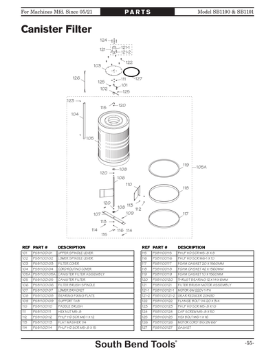

CANISTER FILTER
$444.35
PSB1100105A
Replacement Filter for SB1100 and SB1101
P
FILTER BRUSH SPINDLE
$46.85
P
LOWER BRACKET
$28.10
P
BEARING FIXING PLATE
$8.20
P
SUPPORT TAB
$4.30
P
PADDLE BRUSH
$23.65
PSB1100111
Now: PN06M
HEX NUT M5-.8
PSB1100112
Now: PB04M
HEX BOLT M6-1 X 10
PSB1100113
Now: PW06
FLAT WASHER 1/4
PSB1100114
Now: PS20M
PHLP HD SCR M5-.8 X 15
PSB1100115
Now: PS05M
PHLP HD SCR M5-.8 X 8
PSB1100116
Now: PS68M
PHLP HD SCR M6-1 X 10
P
FOAM GASKET 20 X 1560MM
$19.35
P
FOAM GASKET 42 X 1560MM
$13.30
P
FOAM GASKET 10 X 1560MM
$13.60
P
THRUST BEARING 12 X 14 X 6MM
$5.15
P
FILTER BRUSH MOTOR ASSEMBLY
$382.80
P
