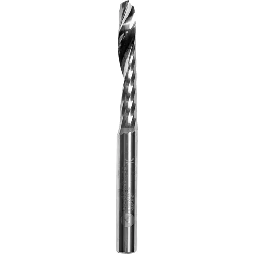

Ideal for deep cuts in non-ferrous metals and acrylic.
With a 1-1/2" cutter length, this bit gives you the freedom to make deep cuts in acrylics with accuracy and durability.
The polished O-flute prevents nasty chip build-up that can compromise cut quality and decrease cutter longevity.
The up-spiral design pulls material up and out of your cuts.
This can leave a little fuzz on the top edge of your material but this is easily removed with a quick rough-up with fine grit sandpaper.
Appropriate cutter geometry for both acrylics and non-ferrous metals.
Great for cuts up to 1-1/2" in depth.
This bit will fit the 1/4" collet that ships with Origin.
Contact Shaper regarding technical support and warranties on their products.
  • Overall length: 3"
  • Shank diameter: 1/4"
  • Cutter diameter: 1/4"
  • Cutter length: 1-1/2"
  • Geometry: Upcut, spiral, O-flute
  • Material: Solid carbide
  • Ideal for deep cuts in non-ferrous metals and acrylic
  • Polished O-flute resists chip adhesion
  • Appropriate for a wide range of non-wood materials
