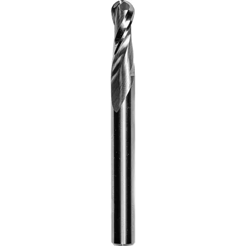

T33714 Shaper Tools 1/4" x 3/4" Up-Spiral Ball Nose Router Bit
A must-have bit for signmakers.
This bit cuts smooth channels that are ideal for a wide range of applications, from cutting board juice channels to dimensional signage, and text.
With solid carbide composition and upcut geometry, this bit can handle a wide variety of materials with ease.
The up-spiral design pulls material up and out of your cuts.
This can leave a little fuzz on the top edge of your material but this is easily removed with a quick rough-up with fine grit sandpaper.
This bit will fit the 1/4" collet that ships with Origin.
Contact Shaper regarding technical support and warranties on their products.
  • Overall length: 2.5"
  • Shank diameter: 1/4"
  • Cutter diameter: 1/4"
  • Cutter length: 3/4"
  • Geometry: Upcut, spiral, ball nose
  • Material: Solid carbide
  • Ball nose tip is ideal for cutting channels
  • Appropriate for a wide variety of materials and specialty applications
