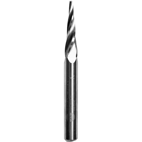

T33717 Shaper Tools 11° Tapered Ball Nose Router Bit
A small ball nose end for cutting tapered channels.
This bit can handle a wide range of specialty applications, from deep profile contouring to cutting wedged tenons for custom joinery.
The ball nose end leaves a smooth rounded channel finish and the four-flute geometry and solid carbide composition help to ensure cutter longevity.
This bit will fit the 1/4" collet that ships with Origin.
Contact Shaper regarding technical support and warranties on their products.
  • Overall length: 2-1/2"
  • Shank diameter: 1/4"
  • Cutter angle: 11°
  • Cutter diameter: 1/16"
  • Cutter length: 1"
  • Geometry: Conical, spiral, ball nose
  • Material: Solid carbide
  • Ideal for a wide variety of specialty applications that require tapered cuts
  • Small ball nose end for tapered channels
  • Appropriate for a wide range of materials, with good chip extraction and durability
