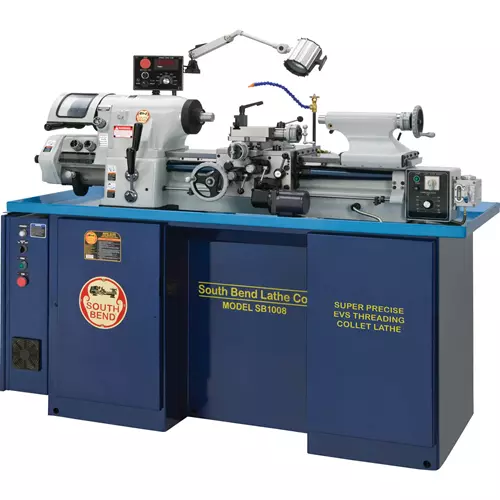

Image for South Bend SB1008 - Super Precision EVS Threading Collet Lathe
Sale price limited to stock on hand
Incredible Sale!
With a spindle runout of less than 50 millionths of an inch, these lathes are the most accurate in the world and indispensable when precision, speed and repeatability are important.
Features:
  • Spindle runout within 0.00125 mm (50 millionths of an inch)
  • Hardened and ground spindle mounted on high-precision angular-contact bearings for sustained precision and rigidity
  • Infinitely variable spindle speed between 50-4000 RPM
  • 3 HP motor with current-vector inverter drive for increased low-end torque
  • Fast lever-action collet closer
  • Independent variable feeds for carriage and cross slide
  • Turcite B slideway bearing surface between carriage and bed
  • Quick change inch and metric gearbox
  • Inch and metric dual dials
  • Automatic threading stop and control
  • High-quality Japanese Yaskawa Inverter
  • An ideal machine for super high-precision work on small parts using 5-C collets
  • 5-C bar stock diameter up to 1.0625"
  • Built to extremely high South Bend standards for industrial-duty use.
    Tool post is optional
    CAPACITY
  • Swing over bed: 11"
  • Distance between centers: 18"
  • Swing over cross slide: 5.98"
  • Swing over saddle: 9.05"
  • Cross slide travel: 6"
  • Compound travel: 3"
  • Carriage travel: 25"
    HEADSTOCK
  • Spindle nose: 5-C (10°)
  • Spindle bore: 1.25"
  • Spindle taper: 4°
  • Spindle speeds w/ 5-C: 50-4000 RPM
  • Spindle speed w/ 6" 3-Jaw Chuck: 50-3000 RPM
    TAILSTOCK:
  • Tailstock taper MT #2
  • Tailstock travel : 3.75"
  • Tailstock barrel diameter: 1.358"
    THREADS
  • Inch threads: 11-108 TPI
  • Metric threads: 0.275-2.7 mm
  • Modular pitches: N/A
  • Diametral pitches: N/A
    FEEDS
  • Number of longitudinal feeds: Variable
  • Longitudinal feed range: 0.3125"-7"/min
  • Number of cross feeds: Variable
  • Cross feed range: 0.1875"-4"/min
    ELECTRICAL
  • Voltage/phase/amps: 220V, 3-Phase, 10A
  • Spindle motor: 3 HP
  • Coolant motor: 1/8 HP
  • Feed inverter motor: 1/2 HP
    GENERAL
  • Machine footprint : 59" x 25"
  • Approximate shipping weight: 2004 lbs.
