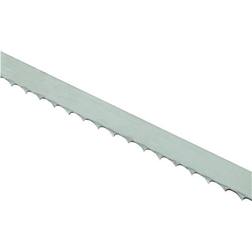

An economical 93-1/2" carbon steel hook blade for ripping boards to size.

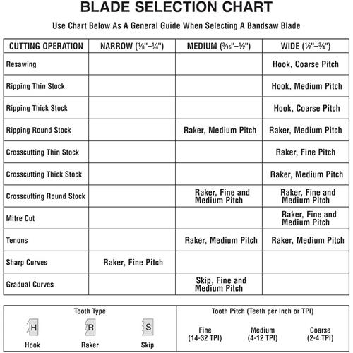

Width is an important factor when considering a new blade. The typical range is as small as 1/8" wide to 3/4" wide. This 1/2" wide blade is good for contour sawing with a minimum radius of 2-1/2". For resaw cutting, you will want to fit the widest blade available for your machine.
Typically, there are more teeth per inch for narrower blades compared to wider blades. We sell hook blades in 3, 4, and 6 TPI versions. This means the 4 TPI cut slower than 3 TPI and faster than 6 TPI blades.
The 93-1/2" length blade fits 14" bandsaws that do not have a riser block installed. If you do have a riser installed, use 105" bandsaw blades instead.

  • Length: 93-1/2"
  • Width: 1/2"
  • Gauge: 0.025"
  • TPI: 4 Hook
  • Type: Carbon tool steel
