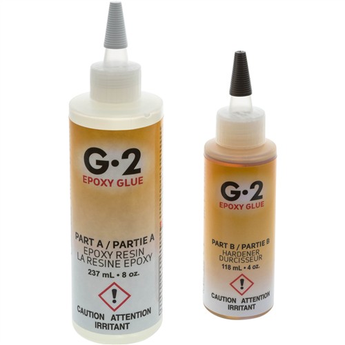

For over 35 years, G-2 has been an excellent adhesive choice for oily, acidic, hardwoods like teak and other tropical woods. use it for gluing oak and cedar, as well as other materials that are difficult to bond. G-2 was developed primarily for waterproof bonding of rot-resistant woods used in fine yacht joinery. Use G-2 for both interior and exterior applications as well as below the waterline. G-2 can be mixed in small or large batches, has a long pot life, and cures overnight. After curing, it can be machined, drilled, sanded, and tapped.
Features & Specs
  • Mixed Viscosity: 5500 cps
  • Mixed Color: Light Amber
  • Tensile Strength: 6000 psi
  • Compressive Strength: 12000 psi
  • Elongation: 11%
  • Application Temp Range: 50°F to 102°F
  • Max Service Temp: -4°F to 160°F
  • Gel Time @ 77°F: 90 minutes
  • Full Cure at 77°F: 48 hours
  • 12 oz.
