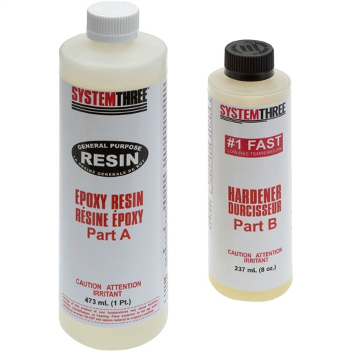

These System 3 General Purpose Epoxy Kits each come with a different hardener for use in different working temperatures and providing varous working times. The General Purpose Epoxy System contains 30% plant derived material and has never contained any volatile organic compounds.
When selecting a kit, consider both the minimum temperature during application and the desired working time that is appropriate for your application. Combine different hardeners to provide a continuous & variable range of cure times.

- Features convenient 2:1 mixing ratio
- Solvent-free, unfilled, epoxy system
- Use for almost all epoxy applications
- Mixed viscosity average: 950 cps
- Mixed Color: Light Amber
- Tensile Strength (PSI): 7500
- Tensile Elongation: 11%
- Flexural Strength: 12,500
- Flexural Modulus: 350,000
- Max Temp: 160° F
- Gel Time: 15 Minutes
- Tack Free Time Thin Film: 2 Hours
- Minimum Application Temp: 35° F
- 1.5 Pint
