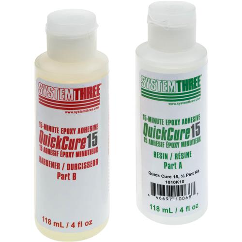

Image for System Three T30579 - Quick Cure 15-Minute Epoxy Adhesive Kit, 8 oz.
Quick Cure-15 will provide some additional working time over the Quick Cure-5 product.
