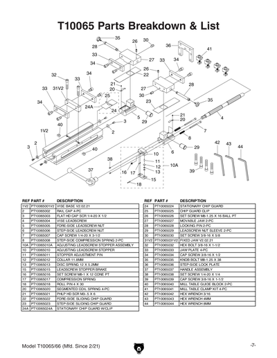

Parts for T10065 4" High-Precision Double Clamp Milling Vise
Parts Diagrams for T10065 - 4" High-Precision Double Clamp Milling Vise
Parts List for Parts for T10065 4" High-Precision Double Clamp Milling Vise
RAIL CAP 4-PC
Now: PFH41
FLAT HD CAP SCR 1/4-20 X 1/2
VISE LEADSCREW
FORE-SIDE LEADSCREW NUT
STEP-SIDE LEADSCREW NUT
CAP SCREW 1/4-20 X 3-1/2
STEP-SIDE COMPRESSION SPRING 2-PC
ADJUSTING LEADSCREW STOPPER ASSEMBLY
10A
ROLL PIN 4 X 30
SEGMENTED COIL SPRING 4-PC
Now: PS12M
PHLP HD SCR M3-.5 X 6
FORE-SIDE SLIDING CHIP GUARD
STEP-SIDE SLIDING CHIP GUARD
STATIONARY CHIP GUARD W/CLIP
24A
SET SCREW M8-1.25 X 16 BALL PT
MOVABLE JAW 2-PC
LOCKING PIN 2-PC
LEADSCREW NUT SLEEVE 2-PC
Now: PSS21
SET SCREW 3/8-16 X 5/8
FIXED JAW V1
31V2
FIXED JAW V2.02.21
Now: PB16
HEX BOLT 3/8-16 X 1-1/2
JAW PLATE 4-PC
CAP SCREW 3/8-16 X 1/2
KNOB BOLT M8-1.25 X 38
STEP-SIDE LOCK PLATE
HANDLE ASSEMBLY
Now: PSS11
SET SCREW 1/4-20 X 1/4
CAP SCREW 3/8-16 X 1-1/2
MILL TABLE GUIDE BLOCK 2-PC
$21.20
MILL TABLE CLAMP KIT 4-PC
$199.25
ALLEN WRENCH 3/16"
HEX WRENCH 4MM
HEX WRENCH 8MM
