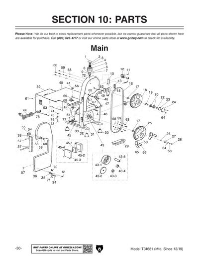

Parts Diagrams for T31681 - 1 HP Commercial Grade Bone Saw

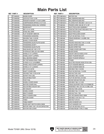

Parts List for Parts for T31681 1 HP Commercial Grade Bone Saw
KNOB ASSEMBLY
KNOB ASSEMBLY
KNOB ASSEMBLY
KNOB ASSEMBLY
KNOB ASSEMBLY
5A
KNOB ASSEMBLY
KNOB ASSEMBLY
KNOB ASSEMBLY
STEEL BALL 6MM
KNOB ASSEMBLY
TENSIONING MANDREL
HEX BOLT M6-1 X 25 SS
WHEEL COVER KNOB
TENSIONING SLIDE PLATE GUIDE
TENSIONING SHAFT
65" x 5/8" x .025" x 4 Hook Meat Blade
HYDRAULIC SEAL 22 X 30 X 6MM
WHEEL 8-1/4" (UPPER)
WHEEL SHAFT (UPPER)
BALL BEARING 6203ZZ
Now: PR18M
EXT RETAINING RING 17MM
O-RING 41.2 X 1.8 RUBBER
WHEEL AXLE COVER (UPPER)
WHEEL 8-1/4" (LOWER)
KEY 6 X 6 X 25 RE
SHAFT COVER (SS)
HEX BOLT M6-1 X 25 LH SS
SCRAP TRAY (SS)
ADJUSTABLE FOOT
FOOT RAIL
WHEEL COVER HINGE
MOTOR COVER RAIL
ADJUSTABLE MOUNT KEY
KEY MOUNT
WHEEL COVER
MEAT PUSHER
MEAT PUSHER ARM
MOTOR COVER
TABLE
TABLE INSERT
DOOR LIMIT SWITCH KEDU QKS8
MOTOR 750W 110V 1-PH W/CAPACITOR
43-1
43-2
43-3
BALL BEARING 6203-2RS
43-4
43-5
POWER CORD 16G 3W 72" 5-15P
45
ELECTRICAL BOX ASSEMBLY
45-1
45-2
45-3
45-4
FLAT HD SCR M4-.7 X 16
46
FENCE KNOB M6-1, 6-LOBE, D30
FENCE
48
ROUND HEAD BOLT M6-1 X 14 SS
49
BLADE WIPER HOLDER
50
BLADE WIPER PAD
51
FRAME COVER (BOTTOM)
52
BLADE GUIDE
53
ON/OFF SWITCH KEDU HY57
54
MEAT PUSHER MOUNT
55
MEAT PUSHER SPINDLE
56
FRAME
57
SLOTTED ROUND HEAD STUD (SS)
58
FLAT WASHER 6MM SS
59
LOCK WASHER 6MM SS
60
HEX BOLT M6-1 X 20 SS
61
PHLP HD SCR M4-.7 X 8 SS
62
HEX NUT M5-.8 SS
63
64
FLAT HD SCR M5-.8 X 8 SS
65
SCRAP DEFLECTOR (SS)
66
HEX BOLT M6-1 X 12 SS
67
FENCE SUPPORT ROD 14 X 270MM SS
68
KNOB BOLT M8-1.25 X 40, 5-LOBE, D38
69
HEX NUT M8-1.25 SS
70
HEX BOLT M4-.7 X 10 SS
71
HEX NUT M4-.7 SS
72
Now: PR03M
EXT RETAINING RING 12MM
73
Now: PB11
HEX BOLT 5/16-18 X 1-1/2
74
Now: PN02
HEX NUT 5/16-18
75
Now: PLW01
LOCK WASHER 5/16
76
Now: PW07
FLAT WASHER 5/16
77
FLAT HD SCR M5-.8 X 12
78
STRAIN RELIEF TYPE-2 11MM

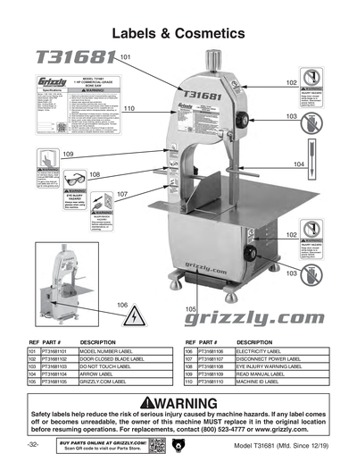

MODEL NUMBER LABEL
DOOR CLOSED BLADE 1.5W X 2.5H
DO NOT TOUCH LABEL
ARROW LABEL
GRIZZLY.COM LABEL 6.625",GREEN
106
ELECTRICITY 1.4W X 1.2H
107
DISCONNECT 110V 1.5W X 2.5H
108
SAFETY GLASSES 1.5W X 2.5H
109
READ MANUAL 1.5W X 2.5H
110
MACHINE ID LABEL
