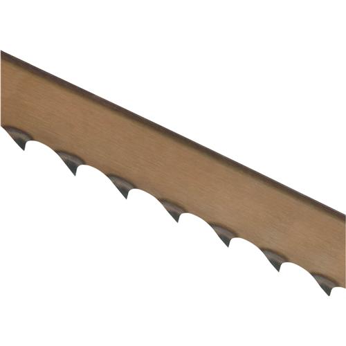

Timber Wolf's® exclusive use of low tensioned, high ductile Swedish silicon steel, unique geometric gullet designs and sets, unique manufacturing processes and quality control that is unsurpassed in the business has resulted in the production of the finest bandsaw blades in the world.
Timber Wolf® mills the teeth of all their blades, as opposed to stamping them out. This process produces a blade that is at least 50% sharper out of the box. Timber Wolf® also uses induction hardening, which results in a blade that will conform to a band wheel using 30% less tension.
High Performance (HP) and Raker (RK) blades are specifically designed for detail work in 1" and smaller kiln dried wood when a very clean finish is required. They are also effective in plywood and other woods where tear-out is a concern as well as in the cutting of soft metals.
Positive Claw (PC) blades are everything a wood cutting blade was meant to be. They have over 60% of the speed capabilities of a hook style blade with "hook" style gullet geometry and fast chip removal, while giving you the great finish of a skip.
AS-S blades are only .025" thick with a total overall set of only .048 thousandths of an inch. These bands were specifically designed for straight-line resawing in very expensive, thick woods. These blades utilize the thinnest kerf possible and provide a super finish when speed is not a concern.
Blade Selection: Selecting the right blade for the cutting task requires knowledge about blade characteristics and cutting priorities (i.e. speed, finish, etc.).Blade Length: Measured by the blade circumference, blade lengths are specific to each bandsaw. They are determined by the wheel diameter and distance between the wheels. Blade Width: Measured from the back of the blade to the tip of the blade tooth (the widest point). Blade width determines the largest and smallest curve that can be cut, and contributes to the accuracy of cutting straight—generally the wider the blade, the straighter it will cut.
Tooth Set: Two common tooth sets for wood bandsaw blades are alternate and raker. Each type of tooth set removes material in a different manner, leaving cuts with different characteristics. Alternate: An all-purpose arrangement where the teeth are bent evenly left and right of the blade. Raker: Three teeth in a recurring group—one bent left, one bent right, and one that is not bent. The raker set is ideal for most contour cuts.
Tooth Type: The most common tooth types for wood blades are: Standard (or Raker): Equally spaced teeth set at a “0” rake angle. Recommended for thinner workpieces and general use. Hook (or Claw): Wide gullets (round or flat), equally spaced teeth, positive rake angle, and fast cut with good surface finish. Skip (or Skip Tooth): Wide, flat gullets, a "0" rake angle, equally spaced teeth, and recommended for thick wood cutting.
