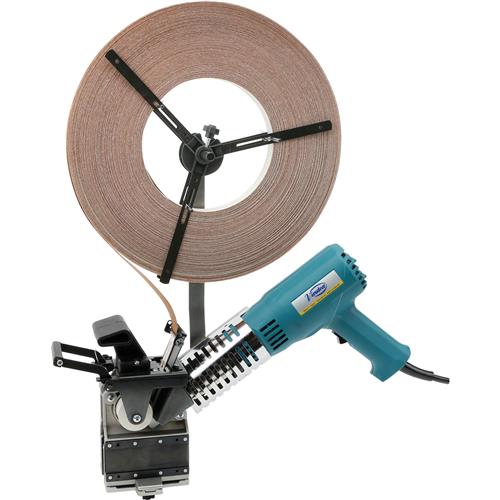

G7910 Virtutex Handheld Edge Bander
Easy adjustment and application makes it the best portable edgebander on the market.
The G7910 Virtutex Handheld Edge Bander is the only manual bander with tracking of tape on the board.
It's suitable for use with most types of pre-glued edging, easily applying pre-glued PVC, polyester, melamine, and wood veneer of up to 2" wide (50mm).
This lightweight and portable edgebander has long proved to be popular for site and workshop alike.
The unit applies heat direct to pre-glued edging material including PVC, melamine, and wood veneer ensuring the best possible application and bonding.
A set of rubber clamps hug the board so you can get the most accurate tracking of the tape on the board.
This edgebander excels at bonding circular and shaped pieces with a minimum internal radius of 20mm.
A portable edge bander is the perfect answer for shops doing custom and on-site work.
Parts for the tool may be available online from Virutex when you search for model AG98F.
  • Input power: 1500 W
  • Maximum edgebanding width: 2"
  • Minimum edging thickness: 0.4 mm
  • Maximum edging thickness: 1 mm
  • Temperature I: 570F (300°C)
  • Temperature II: 1,000F (525°C)
  • Air delivery: 16 CV feet/min (400 l/min)
  • Weight: 6 lbs.
