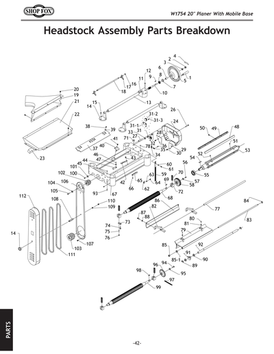

HANDLE
$9.50
Now: PN09M
HEX NUT M12-1.75
Now: PW06M
FLAT WASHER 12MM
HAND WHEEL
$22.35
COLLAR
Now: PR29M
INT RETAINING RING 32MM
BALL BEARING 6203ZZ
Now: PK48M
KEY 4 X 4 X 20
WORM GEAR
$18.00
WORM HOUSING
CAP SCREW M6-1 X 55
ROLLER
ROLLER STAND
$8.95
CAP SCREW M6-1 X 16
E-CLIP 8MM
KNIFE GAUGE
$2.30
KNIFE GAUGE SHAFT
$3.20
DUST HOOD
$32.40
FLANGE BOLT M6-1 X 12
UPPER COVER
GASKET
GEAR BOX COVER
CAP SCREW M8-1.25 X 40
ROLL PIN 6 X 20
SAFETY HATCH
SAFETY HATCH
FLANGE BOLT M6-1 X 10
BRACKET ASSEMBLY
$1.75
31-1
BRACKET
31-2
IDLE PULLEY
31-3
IDLE SHAFT
SHAFT
COLLAR
EXTENSION SPRING
$1.49
HANGER
CAP SCREW M6-1 X 10
CHIP DEFLECTOR PLATE
$4.35
FLANGE BOLT M6-1 X 15
Now: PW03M
FLAT WASHER 6MM
PLATE SPRING
PLATE SPRING
ADJUSTING SHAFT
$1.49
45
SET SCREW M6-1 X 12
46
SET SCREW M6-1 X 20
Now: PN01M
HEX NUT M6-1
48
SET OF 4 KNIVES
$166.45
49
$7.25
50
GIB SCREW
$1.49
51
COMPRESSION SPRING
$1.90
52
JACK SCREW M5-.8 X 12
53
CUTTERHEAD
54
KEY 8 X 8 X 36
55
BALL BEARING 6206ZZ
56
Now: PB83M
HEX BOLT M6-1 X 16
57
Now: PW03M
FLAT WASHER 6MM
58
SPROCKET
$20.50
59
SCALE
$1.90
60
Now: PW03M
FLAT WASHER 6MM
61
Now: PS14M
PHLP HD SCR M6-1 X 12
62
CUT LIMIT POINTER
63
Now: PW03M
FLAT WASHER 6MM
64
Now: PS14M
65
CUT LIMITER PLATE
66
HEX BOLT M5-.8 X 12
67
HEAD CASTING
68
OUTFEED ROLLER
$90.25
68V2
Now: D4785
Rubber Outfeed Roller for W1754/ST1014
69
Now: PK01M
KEY 5 X 5 X 22
70
COMPRESSION SPRING
$1.90
71
HEAD CASTING OILER SET SCREW
72
BUSHING
$2.90
72-1
SWITCH BOX BACK COVER
72-2
CONTACTOR NHD C35-D 220V
72-3
OL RELAY NHD NTH-32 26-32
72-4
SWITCH BOX FRONT COVER
73
PLATE
$1.90
74
Now: PB09M
HEX BOLT M8-1.25 X 20
75
SET SCREW M6-1 X 20
76
Now: PN01M
HEX NUT M6-1
77
SHAFT
78
SET SCREW M6-1 X 16
79
CHIP BREAKER
$38.50
80
SET SCREW M6-1 X 20
81
Now: PN01M
HEX NUT M6-1
82
BRACKET
83
LOCKING ROD
84
Now: PR03M
EXT RETAINING RING 12MM
85
Now: PN09M
HEX NUT M12-1.75
85-1
LOCK WASHER 12MM
86
PRESSURE PLATE
87
Now: PB09M
88
LOCK WASHER 8MM
89
E-CLIP 15MM
90
ANTI-KICKBACK SHAFT COLLAR
91
ANTI-KICKBACK FINGER
92
SHAFT
93
SET SCREW M8-1.25 X 12
94
Now: PB83M
HEX BOLT M6-1 X 16
95
Now: PW03M
FLAT WASHER 6MM
96
SPROCKET
$17.25
97
CHAIN 06B-1 X 67
$8.65
98
Now: PK01M
KEY 5 X 5 X 22
99
INFEED ROLLER
$94.20
100
Now: PB02M
HEX BOLT M6-1 X 12
Now: PW03M
FLAT WASHER 6MM

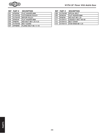

CUTTERHEAD PULLEY
MOTOR PULLEY 28MM
$32.00
103-1
MOTOR PULLEY WASHER 11MM
103-2
FLAT HD SCR M10-1.5 X 20
Now: PW01M
FLAT WASHER 8MM
Now: PB07M
HEX BOLT M8-1.25 X 25
106
BELT GUARD
107
108
BELT GUARD BOLT
$1.49
109
Now: PW01M
FLAT WASHER 8MM
110
Now: PN03M
HEX NUT M8-1.25
111
Now: PVM60
V-BELT M60 3L600
112
BELT COVER
114
STAR KNOB M8-1.25
$1.90

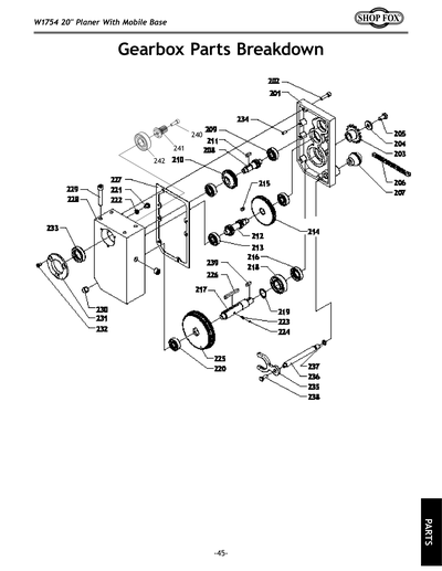

201
GEAR BOX COVER
202
CAP SCREW M6-1 X 25
203
SPROCKET
$6.90
204
Now: PW01M
FLAT WASHER 8MM
205
Now: PB03M
HEX BOLT M8-1.25 X 16
206
CHAIN 06B-1 X 51
$6.15
207
BALL KNOB M10-1.5
$1.90
208
SHAFT
$14.40
209
BALL BEARING 6201-2RS
210
GEAR
211
Now: PK19M
KEY 5 X 5 X 14
212
SHAFT
$15.85
213
214
GEAR
$11.25
215
Now: PK06M
KEY 5 X 5 X 10
216
OIL SEAL 20 X 35 X 7
$3.65
217
SHAFT
$5.10
218
BALL BEARING 6204ZZ
219
Now: PR09M
EXT RETAINING RING 20MM
220
221
Now: PS03M
PHLP HD SCR M6-1 X 8
222
Now: PW03M
FLAT WASHER 6MM
223
COMPRESSION SPRING
$1.49
224
STEEL BALL 4MM
225
GEAR
$28.50
226
Now: PK36M
KEY 5 X 5 X 50
227
PACKING PIECE
$1.90
228
GEAR BOX
229
CAP SCREW M8-1.25 X 50
230
OIL PLUG
231
FLANGE COVER
232
FLAT HD CAP SCR M5-.8 X 12 C10.9
233
OIL SEAL 25 X 40 X 10
$3.65
234
PIN 5 X 10
235
CLUTCH
$1.49
236
HANDLE SHAFT
$3.25
237
O-RING 16 X 2.4
238
HEX LOCTITE SCREW
239
Now: PK08M
KEY 5 X 5 X 16
240
CAP SCREW M6-1 X 20 LH
241
GEAR 14T
$17.65
242
BALL BEARING 6204ZZ
301
ENCLOSED STAND
302
COVER
303
FLAT HD SCR M6-1 X 20
304
MOTOR PLATE
305
SET SCREW M6-1 X 12
306
PLATE CONNECTING ROD
307
SET SCREW M6-1 X 12
308
309
HEX BOLT M10-1.5 X 70
310
Now: PW04M
FLAT WASHER 10MM
311
Now: PN02M
HEX NUT M10-1.5
312
COLLAR
313
SET SCREW M6-1 X 8
314
ADJUST BOLT
315
Now: PN09M
HEX NUT M12-1.75
316
Now: PW06M
FLAT WASHER 12MM
317

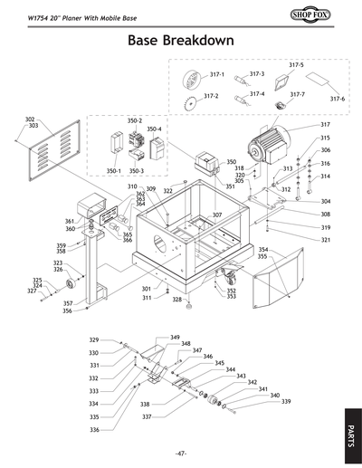

MOTOR 5HP 240V 1-PH
$606.35
317-1
MOTOR FAN COVER
317-10
BALL BEARING 6204ZZ
317-2
MOTOR FAN
$5.45
317-3
R CAPACITOR 60M 400V
$8.60
317-4
S CAPACITOR 300M 300V
317-5
MOTOR JUNCTION BOX COVER
317-6
MOTOR LABEL
317-7
CENT SWITCH 3/4-3450
317-8
CONTACT PLT-TUNGSTEN 5HP OR LESS
317-9
BALL BEARING 6206ZZ
318
Now: PK12M
KEY 5 X 5 X 30
319
Now: PW01M
FLAT WASHER 8MM
320
Now: PN03M
HEX NUT M8-1.25
321
HEX BOLT M8-1.25 X 45
322
STRAIN RELIEF
323
Now: PN03M
HEX NUT M8-1.25
324
Now: PW01M
FLAT WASHER 8MM
325
SLEEVE
$1.49
326
UNIVERSAL PULLEY
$3.20
327
HEX BOLT M8-1.25 X 70
328
RUBBER FOOT
329
Now: PR16M
EXT RETAINING RING 9MM
330
Now: PW06M
FLAT WASHER 12MM
331
SHAFT 12MM
$1.75
332
333
Now: PW01M
FLAT WASHER 8MM
334
Now: PN03M
HEX NUT M8-1.25
335
Now: PN02M
HEX NUT M10-1.5
336
Now: PW04M
FLAT WASHER 10MM
337
Now: PB45M
HEX BOLT M8-1.25 X 100
338
Now: PW01M
FLAT WASHER 8MM
339
TROLLEY WHEEL BOLT
$1.49
340
Now: PR21M
INT RETAINING RING 35MM
341
BALL BEARING 6202ZZ
342
TROLLEY WHEEL
343
SLEEVE
$4.35
344
TROLLEY UNIVERSAL KIT
$23.40
345
Now: PW04M
FLAT WASHER 10MM
346
LOCK NUT M12-1.75
347
HEX BOLT M10-1.5 X 55
348
BRACKET
349
PEDAL
349A
COMPLETE PEDAL ASSEMBLY
350V2
MAG SWITCH ASSY V2.01.11
$223.20
350V2-1
MAG SWITCH COVER ASSEMBLY
350V2-2
CONTACTOR NHD C-35D 220V
350V2-3
OL RELAY NHD NTH-32 26-32A
351
BUTTON HD CAP SCR M5-.8 X 20
352
Now: PW02M
FLAT WASHER 5MM
353
Now: PN06M
HEX NUT M5-.8
354
FRONT COVER
355
BUTTON HD CAP SCR M6-1 X 20
356
FLANGE BOLT M8-1.25 X 20
357
SWITCH MOUNTING BRACKET
358
FLANGE BOLT M6-1 X 16
359
360
BALL STRAIN RELIEF
361
SWITCH BOX
$14.10
362
SWITCH FACE COVER
$6.90
363V2
START BUTTON V2.01.11
$18.00
364
INDICATOR LIGHT
$3.65
365V2
STOP BUTTON V2.01.11
366
TAP SCREW ST4.2 X 8
367
POWER CORD 12G 3W 72" V1
367V2
POWER CORD 12G 3W 72" L6-30P V2.07.12
$40.25
401

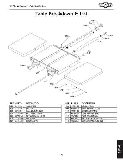

TABLE/BED
402
ROLLER
403
404
ECCENTRIC SHAFT
405
SET SCREW M6-1 X 12
406
LOCK BAR
$2.15
407
LOCK SLEEVE
$2.20
408
LOCKING ROD
$2.90
409
STAR KNOB M12-1.75
410
EXTENSION WING
$105.70
411
LOCK WASHER 8MM
412
Now: PW01M
FLAT WASHER 8MM
413
Now: PB20M
HEX BOLT M8-1.25 X 35
414
SET SCREW M8-1.25 X 20

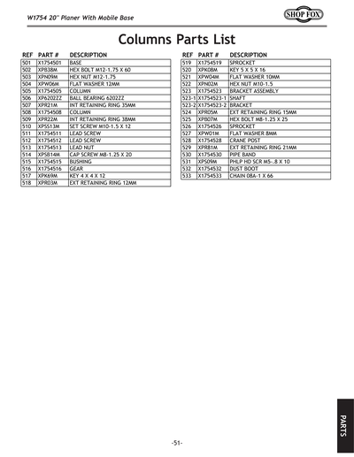

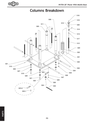

501
BASE
502
Now: PB38M
HEX BOLT M12-1.75 X 60
503
Now: PN09M
HEX NUT M12-1.75
504
Now: PW06M
FLAT WASHER 12MM
505
COLUMN
506
BALL BEARING 6202ZZ
507
Now: PR21M
508
COLUMN
509
Now: PR22M
INT RETAINING RING 38MM
510
SET SCREW M10-1.5 X 12
511
LEAD SCREW
512
LEAD SCREW
513
LEAD NUT
$2.90
514
CAP SCREW M8-1.25 X 20
515
BUSHING
516
GEAR
517
Now: PK69M
KEY 4 X 4 X 12
518
Now: PR03M
519
SPROCKET
$6.90
520
Now: PK08M
KEY 5 X 5 X 16
521
Now: PW04M
FLAT WASHER 10MM
522
Now: PN02M
HEX NUT M10-1.5
523
BRACKET ASSEMBLY
$5.75
524
Now: PR05M
EXT RETAINING RING 15MM
525
Now: PB07M
526
SPROCKET
$5.45
527
Now: PW01M
FLAT WASHER 8MM
528
CRANE POST
529
Now: PR81M
EXT RETAINING RING 21MM
530
PIPE BAND
531
Now: PS09M
PHLP HD SCR M5-.8 X 10
532
DUST BOOT
$1.90
533
CHAIN 08A-1 X 66
