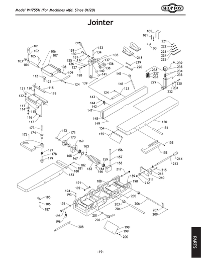

Parts for W1755H 6" Parallelogram Jointer with Helical Cutterhead
Parts Diagrams for W1755H - 6" Parallelogram Jointer with Helical Cutterhead

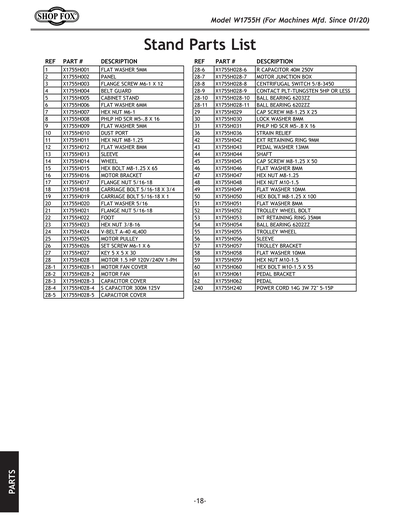

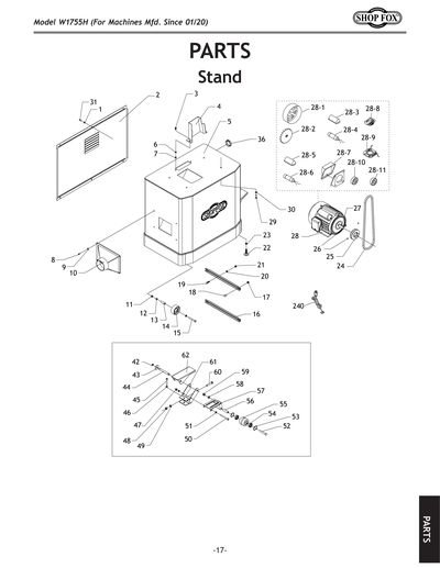

Parts List for Parts for W1755H 6" Parallelogram Jointer with Helical Cutterhead
Now: PW02M
FLAT WASHER 5MM
PANEL
FLANGE SCREW M6-1 X 12
BELT GUARD
CABINET STAND
Now: PW03M
FLAT WASHER 6MM
Now: PN01M
HEX NUT M6-1
Now: PS40M
PHLP HD SCR M5-.8 X 16
Now: PW02M
FLAT WASHER 5MM
DUST PORT
Now: PN03M
HEX NUT M8-1.25
Now: PW01M
FLAT WASHER 8MM
SLEEVE
WHEEL
Now: PB86M
HEX BOLT M8-1.25 X 65
MOTOR BRACKET
Now: PFN02
FLANGE NUT 5/16-18
Now: PCB05
CARRIAGE BOLT 5/16-18 X 3/4
Now: PCB11
CARRIAGE BOLT 5/16-18 X 1
Now: PW07
FLAT WASHER 5/16
Now: PFN02
FLANGE NUT 5/16-18
FOOT
Now: PN08
HEX NUT 3/8-16
Now: PVA40
V-BELT A40
MOTOR PULLEY
SET SCREW M6-1 X 6
Now: PK12M
KEY 5 X 5 X 30
MOTOR 1.5HP 120V/240V 1-PH
28-1
MOTOR FAN COVER
28-10
BALL BEARING 6203ZZ
28-11
BALL BEARING 6202ZZ
28-2
MOTOR FAN
28-3
CAPACITOR COVER
28-4
S CAPACITOR 300M 125V
28-5
CAPACITOR COVER
28-6
R CAPACITOR 40M 250V
28-7
MOTOR JUNCTION BOX
28-8
CENT SWITCH 5/8-3450
28-9
CONTACT PLT-TUNGSTEN 5HP OR LESS
CAP SCREW M8-1.25 X 25
LOCK WASHER 8MM
Now: PS40M
STRAIN RELIEF
Now: PR16M
EXT RETAINING RING 9MM
PEDAL WASHER 13MM
SHAFT

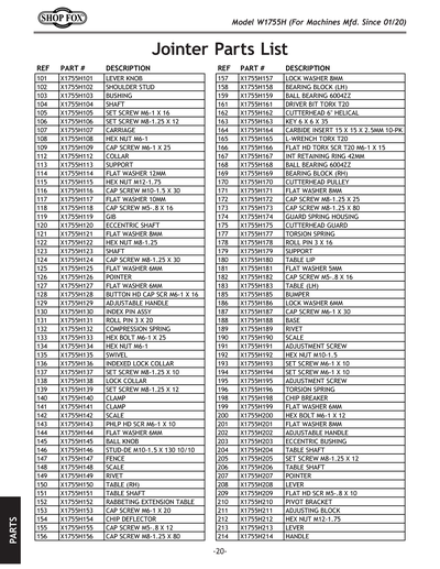

PEDAL
LEVER KNOB
SHOULDER STUD
BUSHING
SHAFT
SET SCREW M6-1 X 16
106
SET SCREW M8-1.25 X 12
107
CARRIAGE
108
Now: PN01M
HEX NUT M6-1
109
CAP SCREW M6-1 X 25
112
COLLAR
113
SUPPORT
114
Now: PW06M
FLAT WASHER 12MM
115
Now: PN09M
HEX NUT M12-1.75
116
CAP SCREW M10-1.5 X 30
117
Now: PW04M
FLAT WASHER 10MM
118
CAP SCREW M5-.8 X 16
119
GIB
120
ECCENTRIC SHAFT
121
Now: PW01M
FLAT WASHER 8MM
122
Now: PN03M
HEX NUT M8-1.25
123
SHAFT
124
CAP SCREW M8-1.25 X 30
125
Now: PW03M
FLAT WASHER 6MM
126
POINTER
127
Now: PW03M
FLAT WASHER 6MM
128
BUTTON HD CAP SCR M6-1 X 16
129
ADJUSTABLE HANDLE
130
INDEX PIN ASSY
131
ROLL PIN 3 X 20
132
COMPRESSION SPRING
133
Now: PB10M
HEX BOLT M6-1 X 25
134
Now: PN01M
HEX NUT M6-1
135
SWIVEL
136
INDEXED LOCK COLLAR
137
SET SCREW M8-1.25 X 10
138
LOCK COLLAR
139
140
CLAMP
141
CLAMP
142
SCALE
143
Now: PS68M
PHLP HD SCR M6-1 X 10
144
Now: PW03M
FLAT WASHER 6MM
145
BALL KNOB
146
STUD-DE M10-1.5 X 130 10/10
147
FENCE
148
SCALE
149
RIVET
150
TABLE RH
151
TABLE SHAFT
152
RABBETING EXTENSION TABLE
153
CAP SCREW M6-1 X 20
154
CHIP DEFLECTOR
155
CAP SCREW M5-.8 X 12
156
CAP SCREW M8-1.25 X 80
157
LOCK WASHER 8MM
158
BEARING BLOCK LEFT
159
BALL BEARING 6004ZZ
161
DRIVER BIT TORX T20
162
CUTTERHEAD 6" HELICAL
163
Now: PK74M
KEY 6 X 6 X 35
164
Now: D4655
Replacement Inserts for Helical Cutterheads - 15 x 15 x 2.5mm, 10 Pk.
165
L-WRENCH TORX T20
166
FLAT HD TORX T20 M6-1 X 15
167
Now: PR24M
INT RETAINING RING 42MM
168
BALL BEARING 6004ZZ
169
BEARING BLOCK RIGHT
170
CUTTERHEAD PULLEY
171
Now: PW01M
FLAT WASHER 8MM
172
173
174
GUARD SPRING HOUSING
175
CUTTERHEAD GUARD
177
TORSION SPRING
178
ROLL PIN 3 X 16
179
SUPPORT
180
TABLE LIP
181
Now: PW02M
FLAT WASHER 5MM
182
183
TABLE LH
185
BUMPER
186
LOCK WASHER 6MM
187
CAP SCREW M6-1 X 30
188
BASE
189
RIVET
190
SCALE
191
ADJUSTMENT SCREW
192
Now: PN02M
HEX NUT M10-1.5
193
SET SCREW M6-1 X 10
194
SET SCREW M6-1 X 10
195
ADJUSTMENT SCREW
196
TORSION SPRING
198
CHIPBREAKER
199
Now: PW03M
FLAT WASHER 6MM
200
Now: PB02M
HEX BOLT M6-1 X 12
201
Now: PW01M
FLAT WASHER 8MM
202
*DISCD*ADJUSTABLE HANDLE
203
ECCENTRIC BUSHING
204
TABLE SHAFT
205
206
TABLE SHAFT
207
POINTER
208
LEVER
209
FLAT HD SCR M5-.8 X 10
210
PIVOT BRACKET
211
ADJUSTING BLOCK
212
Now: PN09M
HEX NUT M12-1.75
213
LEVER
214
*DISCD*HANDLE
215

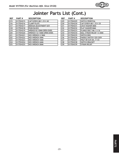

CAP SCREW M8-1.25 X 40
216
CLAMP PLATE
217
MEDIUM ADJUSTMENT SCR
218
PUSH BLOCK
219
WRENCH 8 X 10MM OPEN-ENDS
220
WRENCH 12 X 14MM OPEN-ENDS
221
HEX WRENCH 2.5MM
222
HEX WRENCH 4MM
223
HEX WRENCH 5MM
224
HEX WRENCH 6MM
225
HEX WRENCH 8MM
229
SWITCH PEDESTAL
230
231
LOCK WASHER 8MM
232
Now: PW01M
FLAT WASHER 8MM
233
FLANGE BOLT M6-1 X 16
234
BALL STRAIN RELIEF 13.5MM
235
SWITCH BOX
236
Now: D4151
Paddle Switch 120/230V
237
Now: PS07M
PHLP HD SCR M4-.7 X 8
238
SWITCH BRACKET
239
STRAIN RELIEF
240
POWER CORD
