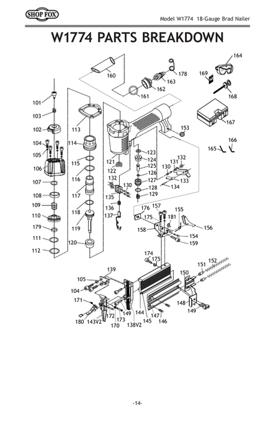

Parts Diagrams for W1774 - 18 Gauge Brad Nailer Kit

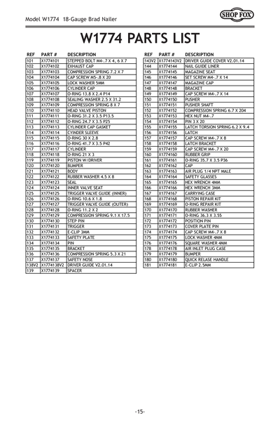

Parts List for Parts for W1774 18 Gauge Brad Nailer Kit
STEPPED BOLT M4-.7 X 4, 6 X 7
$1.49
EXHAUST CAP
$1.49
COMPRESSION SPRING 7.2 X 7
$1.49
106
CYLINDER CAP
$1.49
108
SEALING WASHER 2.5 X 31.2
109
COMPRESSION SPRING 8 X 7
110
HEAD VALVE PISTON
111
O-RING 31.2 X 3.5 P13.5
113
CYLINDER CAP GASKET
$1.49
114
CYINDER SLEEVE
115
O-RING 30 X 2.8
116
O-RING 41.7 X 3.5 P42
117
CYLINDER
118
O-RING 21 X 3
119
PISTON W/DRIVER
$1.49
120
BUMPER
121
BODY
122
RUBBER WASHER 4.5 X 8
123
SEAL
124
INNER VALVE SEAT
125
TRIGGER VALVE GUIDE (INNER)
126
O-RING 10.6 X 1.8
127
TRIGGER VALVE GUIDE
128
O-RING 10.6 X 1.8
129
COMPRESSION SPRING 9.1 X 17.5
130
STEP PIN
131
TRIGGER
133
SAFETY PLATE
134
PIN
135
BRACKET
136
COMPRESSION SPRING 5.3 X 21
137
SAFETY NOSE
138
DRIVER GUIDE V1
138V2
DRIVER GUIDE V2.01.14
139
SPACER
143
DRIVER GUIDE COVER V1
143V2
DRIVER GUIDE COVER V2.01.14
144
NAIL GUIDE LINER
145
MAGAZINE SEAT
147
MAGAZINE CAP
148
BRACKET
150
PUSHER
151
PUSHER SHAFT
152
COMPRESSION SPRING 6.7 X 204
154
PIN
155
LATCH TORSION SPRING 6.2 X 9.4
156
LATCH
158
LATCH BRACKET
160
RUBBER GRIP
161
O-RING 35.7 X 3.5 P36
$1.49
162
$1.49
163
AIR PLUG 1/4 NPT MALE
164
*DISCD* SAFETY GLASSES
$3.45
167
CARRYING CASE
168
PISTON REPAIR KIT
$1.49
169
O-RING REPAIR KIT
$1.49
170
RUBBER WASHER
171
O-RING 36.3 X 3.55
172
POSITION PIN
173
COVER PLATE PIN
174
CAP SCREW M4-.7 X 8
176
SQUARE WASHER 4MM
178
AIR INLET PLUG CASE
179
BUMPER
180
QUICK RELASE HANDLE
