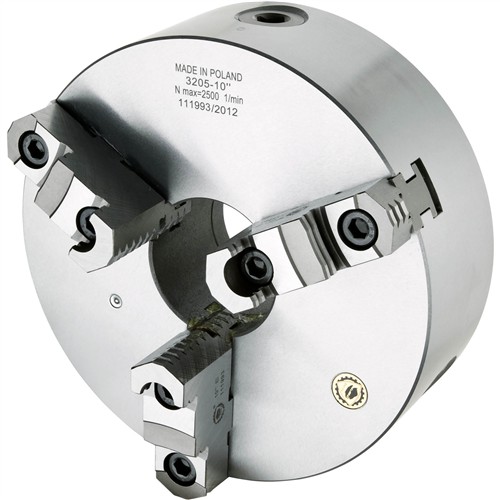

T10395 Bison 10" Plain Back 3-Jaw Self-Centering Scroll Chuck
Bison lathe chucks deliver precision and accuracy you can count on, making them a trusted choice for professionals.
This plain back 3-jaw chuck is made with a cast-iron body, 2-piece, hardened jaws, and come complete with a chuck wrench.
Check out the Bison back plates for mounting to your lathe.
  • Chuck diameter: 10"
  • Mount: Plain back
  • Maximum speed: 2000 RPM
  • Jaw type: 2-Piece jaws
  • Jaw style: Hard 2-piece jaws
  • Number of jaws: 3
  • Adapter mounting bolt thread: M12x1.75
  • Adapter mounting bolt length: 1.18"
  • Adapter mounting bolt quantity: 6
  • Precision class: Standard accuracy chuck
  • Body material: Cast iron
  • Hole diameter D: 2.9921"
  • F: 8.8189"
  • E: 7.874"
  • C: 0.1969"
  • H: 3.347"
  • h: 2.087"
  • h1: 1.339"
  • Clamping range d1 (min-max): 0.197"–4.65"
  • Clamping range d2 (min-max): 3.39–7.76"
  • Clamping range d3 (min-max): 6.30"–9.84"
  • Clamping range d4 (min-max): 2.28"–6.50"
  • Clamping range d5 (min-max): 4.92–9.25"
  • Approximate shipping weight: 56 lbs.
