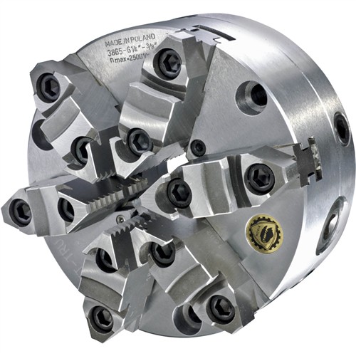

T10420 Bison 6-1/4" 6-Jaw Self-Centering SET-TRU Chuck
We are proud to offer Bison Lathe chucks.
Bison lathe chucks deliver precision and accuracy you can count on, making them a trusted choice for professionals.
This is a 6" self-centering chuck with fine adjustment offering 0.0004" concentricity. The plain back mounted 6-jaw chuck has forged steel bodies for durability.
Achieve maximum grip with minimal distortion with this 6-jaw chuck with 2-piece, hardened jaws.
This chuck requires a backplate for installation.
  • Chuck diameter: 8"
  • Mount: Plain back
  • Maximum speed: 3200 RPM
  • Jaw type: 2-Piece jaws
  • Jaw style: Hard 2-piece jaws
  • Number of jaws: 6
  • M bolt thread: M10x1.5
  • M bolt quantity: 3
  • N bolt thread: M18x1
  • N bolt quantity: 4
  • Precision class: Precision Chuck with Fine Adjustment
  • Body material: Steel
  • Hole diameter D: 1.654"
  • F: 5.5118"
  • E: 3.385"
  • H: 2.677"
  • h: 1.71"
  • C: 0.67"
  • Approximate shipping weight: 25 lbs.
Compatible Bison Backplates:
