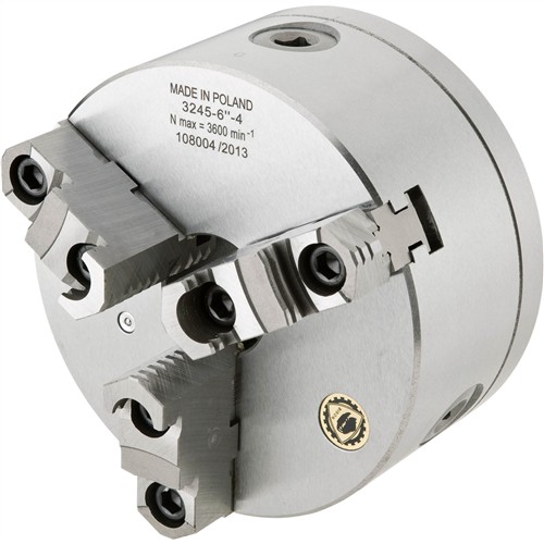

Bison T10397 - 6-1/4" D1-4 3 Jaw Chuck
T10397 Bison 6" D1-4 3-Jaw Self-Centering Scroll Chuck
Bison lathe chucks deliver precision and accuracy you can count on, making them a trusted choice for professionals.
This D1-4 camlock direct mount 3-jaw chuck is made with a cast-iron body, 2-piece, hardened jaws, and come complete with a chuck wrench.
  • Chuck diameter: 6"
  • Mount: D1-4
  • Maximum speed: 3000 RPM
  • Jaw type: 2-Piece jaws
  • Jaw style: Hard 2-piece jaws
  • Number of jaws: 3
  • Bolt thread: M10x1
  • Bolt quantity: 3
  • Camlock stud diameter: 5/8"
  • Precision class: Standard accuracy chuck
  • Body material: Cast iron
  • Hole diameter D: 1.6535"
  • B: 3.2520"
  • G: 1.6535"
  • C: 0.5118"
  • H: 3.2087"
  • h: 1.693"
  • Clamping range d1 (min-max): 0.118"–2.52"
  • Clamping range d2 (min-max): 2.44"–4.76"
  • Clamping range d3 (min-max): 4.53"–6.30"
  • Clamping range d4 (min-max): 1.65"–3.81"
  • Clamping range d5 (min-max): 3.46"–5.75
  • Approximate shipping weight: 25 lbs.
