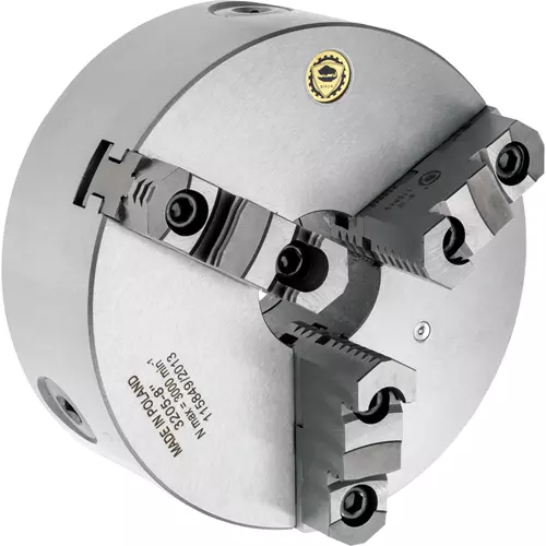

                        T10394 Bison 8" Plain Back 3-Jaw Self-Centering Scroll Chuck
Bison lathe chucks deliver precision and accuracy you can count on, making them a trusted choice for professionals.
This plain back 3-jaw chuck is made with a cast-iron body, 2-piece, hardened jaws, and come complete with a chuck wrench.
Check out the Bison back plates for mounting to your lathe.
- Chuck diameter: 8"
- Mount: Plain back
- Maximum speed: 2500 RPM
- Jaw type: 2-Piece jaws
- Jaw style: Hard 2-piece jaws
- Number of jaws: 3
- Adapter mounting bolt thread: M10x1.5
- Adapter mounting bolt length: 0.98"
- Adapter mounting bolt quantity: 6
- Precision class: Standard accuracy chuck
- Body material: Cast iron
- Hole diameter D: 2.1654"
- F: 6.9291"
- E: 6.2992"
- C: 0.1575"
- H: 2.953"
- h: 1.772"
- h1: 1.142"
- Clamping range d1 (min-max): 0.157"–3.54"
- Clamping range d2 (min-max): 2.83"–6.14"
- Clamping range d3 (min-max): 5.24"–7.87"
- Clamping range d4 (min-max): 1.97"–5.12"
- Clamping range d5 (min-max): 4.13"–7.48
- Approximate shipping weight: 35 lbs.
