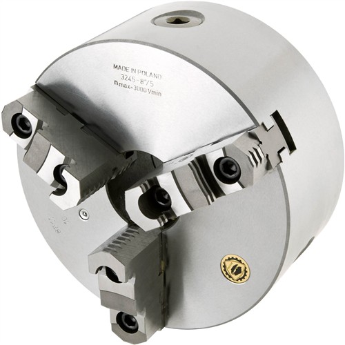

T10399 Bison 8" D1-5 3-Jaw Self-Centering Scroll Chuck
Bison lathe chucks deliver precision and accuracy you can count on, making them a trusted choice for professionals.
This D1-5 camlock 3-jaw chuck is made with a cast-iron body, 2-piece, hardened jaws, and come complete with a chuck wrench.
  • Chuck diameter: 8"
  • Mount: D1-5
  • Maximum speed: 2500 RPM
  • Jaw type: 2-Piece jaws
  • Jaw style: Hard 2-piece jaws
  • Number of jaws: 3
  • Bolt thread: M10x1.5
  • Bolt quantity: 6
  • Camlock stud diameter: 3/4"
  • Precision class: Standard accuracy chuck
  • Body material: Cast iron
  • Hole diameter D: 2.1653"
  • B: 4.1260"
  • G: 3.2505"
  • C: 0.5629"
  • H: 3.5827"
  • h: 1.772"
  • Clamping range d1 (min-max): 0.157"–3.54"
  • Clamping range d2 (min-max): 2.83"–6.14"
  • Clamping range d3 (min-max): 5.24"–7.87"
  • Clamping range d4 (min-max): 1.97"–5.12"
  • Clamping range d5 (min-max): 4.13"–7.48
  • Approximate shipping weight: 42 lbs.
