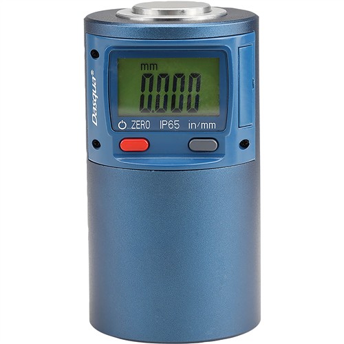

Dasqua T33206 4" Electronic Z-Axis Setter
The 100mm height is ideal for larger machines where extra height is required.
This Z-Axis setting device features a plastic body and LCD screen and is rated to IP65.
It features an indicator light to inform the user that absolute zero is reached. It can achieve a repeatability of 3 microns and is accurate to ± 0.002 mm.
A built in magnetic base allows the tool setter to be secured to a steel machining bed or fixture.
This Z-Axis Setter comes in a high-quality fitted aluminum protective case.
It is not designed to be wired directly into your CNC controller. It operates independently as a tool position indication device for manual setting offsets in your system.
Dasqua takes responsibility for of all its products by providing a 2-year warranty.
Parts found to be defective may be replaced or repaired by Dasqua.
Contact Dasqua regarding warranties on their products and technical support.
  • Resolution: .0005"/0.01mm
  • Graduation: 0.001mm/0.0005"
  • Height of spring mounted contact face: 52.5mm
  • Diameter: 55mm
  • Overall height: 100mm
  • Approximate shipping weight: 2 lbs.
  • Easy to set "0" point with LCD screen
  • Positioning accuracy & repeatability is 0.001"/0.01mm
  • Magnetic base
  • Supplied in a fitted metal case
  • Includes 1 SR44 battery
