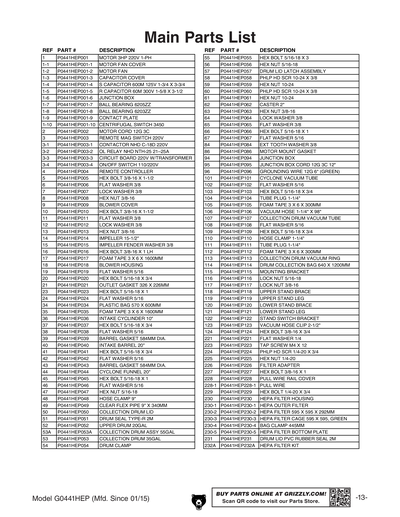

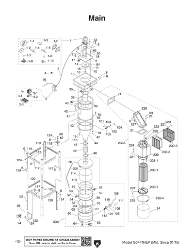

MOTOR 3HP 220V 1-PH
1-1
MOTOR FAN COVER
1-10
CENT SWITCH 3450
1-2
MOTOR FAN
1-3
CAPACITOR COVER
1-4
Now: PC600
S CAPACITOR 600M 125V 1-3/4 X 3-1/2
1-5
R CAPACITOR 60M 300V 1-5/8 X 3-1/2
1-6
JUNCTION BOX
1-7
BALL BEARING 6205ZZ
1-8
BALL BEARING 6203ZZ
1-9
CONTACT PLATE
MOTOR CORD 10G 3W
REMOTE MAG SWITCH 220V V3.01.12
3-1
CONTACTOR NHD C-18D 220V
3-2
OL RELAY NHD NTH-25 21-25A
3-3
CIRCUIT BOARD 220V W/TRANSFORMER
3-4
ON/OFF SWITCH 220V
REMOTE CONTROLLER
Now: PB16
HEX BOLT 3/8-16 X 1-1/2
Now: PW02
FLAT WASHER 3/8
Now: PLW04
LOCK WASHER 3/8
Now: PN08
HEX NUT 3/8-16
BLOWER COVER V1
9V2
BLOWER COVER V2.09.20
Now: PB16
Now: PW02
FLAT WASHER 3/8
Now: PLW04
LOCK WASHER 3/8
Now: PN08
HEX NUT 3/8-16
IMPELLER 15-1/2" V2.02.06
FENDER WASHER 8MM
Now: PB103
HEX BOLT 3/8-16 X 1 LH
FOAM TAPE 3 X 6 X 1600MM
BLOWER HOUSING 15-1/2" IMP V2.02.06
Now: PW07
FLAT WASHER 5/16
Now: PB07
HEX BOLT 5/16-18 X 3/4
OUTLET GASKET 326 X 226MM
Now: PB03
HEX BOLT 5/16-18 X 1
Now: PW07
FLAT WASHER 5/16
RIVET
COLLECTION DRUM HANDLE PLASTIC
Now: PS35
PHLP HD SCR 5/16-18 X 3/4
***USE PN40***
$1.49
Now: PCB05
CARRIAGE BOLT 5/16-18 X 3/4
HANDLE HOOK BASE
$10.90
AIR HOSE 1145MM
$6.90
STRAIN RELIEF TYPE-3 M16-2
$3.45
FOAM TAPE 5 X 50MM
Collection Bag 570 x 600mm
INTAKE CYCLINDER 10"
Now: PB07
Now: PW07
FLAT WASHER 5/16
BARREL GASKET 584MM DIA.
INTAKE BARREL 20" V1
40V2
INTAKE BARREL 20" V2.09.20
Now: PB07
Now: PW07
FLAT WASHER 5/16
CYCLONE FUNNEL 20" V2.08.10
44V2
CYCLONE FUNNEL 20" V3.09.20
45
Now: PB03
46
Now: PW07
FLAT WASHER 5/16
Now: PN02
HEX NUT 5/16-18
48
HOSE CLAMP 9"
49
CLEAR FLEX PIPE 9" X 340MM
50
COLLECTION DRUM LID V2.08.06
50V2
COLLECTION DRUM LID V2.09.20
51
DRUM SEAL TYPE-R 2M V3.01.12
52
UPPER DRUM 25GAL V1
52V2
UPPER DRUM 25GAL V2.09.20
53
COLLECTION DRUM 35GAL V2.08.10
53A
COLLCTON DRUM ASSY 55GAL V2.11.09
53AV2
COLLECTION DRUM ASSY 55GAL V2.12.20
53V2
COLLECTION DRUM 35GAL V3.09.20
54
DRUM CLAMP
55
Now: PB04
56
Now: PN02
HEX NUT 5/16-18
57
DRUM LID LATCH ASSEMBLY
58
Now: PS06
PHLP HD SCR 10-24 X 3/8
59
Now: PN07
HEX NUT 10-24
60
Now: PS06
61
Now: PN07
HEX NUT 10-24
62
CASTER 2"
63
Now: PN08
HEX NUT 3/8-16
64
Now: PLW04
LOCK WASHER 3/8
65
Now: PW02
FLAT WASHER 3/8
66
Now: PB03
67
Now: PW07
FLAT WASHER 5/16
68
SWITCH MOUNTING BRACKET V2.01.12
69
Now: PN07M
HEX NUT M3-.5
84
EXT TOOTH WASHER 3/8
86
MOTOR MOUNT GASKET
87
HEX BOLT 3/8-16 X 11
88
HANDLE HOOK
$10.35
89
DRUM LID SPRING
90
CYCLONE FUNNEL ADAPTER
92
FLAT WASHER 3/8 THIN
93
PRESSURE GAUGE W/MOUNTING BRACKET
94
JUNCTION BOX
95
JUNCTION BOX CORD 12G 3C 12"
96
GROUNDING WIRE 12G 6" (GREEN)
97
COLLECTION LID HANDLE
98
DRUM LID CONNECTING PLATE
99
DRUM WINDOW
CYCLONE VACUUM TUBE
Now: PW07
FLAT WASHER 5/16
Now: PB07
TUBE PLUG 1-1/4"
FOAM TAPE 3 X 6 X 300MM
106
VACUUM HOSE 1-1/4" X 98"
107
COLLECTION DRUM VACUUM TUBE
108
Now: PW07
FLAT WASHER 5/16
109
Now: PB07
110
HOSE CLAMP 1-1/4"
111
TUBE PLUG 1-1/4"
112
113
COLLECTION DRUM VACUUM RING
114
DRUM COLLECTION BAG 640 X 1200MM
115
MOUNTING BRACKET V1
$36.25
115V2
MOUNTING BRACKET V2.12.20
116
Now: PLN03
LOCK NUT 5/16-18
117
Now: PLN01
LOCK NUT 3/8-16
118
UPPER STAND BRACE
118V2
UPPER STAND BRACE V2.12.20
119
UPPER STAND LEG V2.07.10
119V2
UPPER STAND LEG V2.12.20
$89.70
120
LOWER BRACKET BRACE V2.03.12
120V2
LOWER BRACKET BRACE V2.12.20
121
LOWER STAND LEG V2.07.12
121V2
LOWER STAND LEG V2.12.20
122
STAND SWITCH BRACKET V2.03.12
122V2
STAND SWITCH BRACKET V2.12.20
123
VACUUM HOSE CLIP 2-1/2"
124
Now: PB21
HEX BOLT 3/8-16 X 3/4

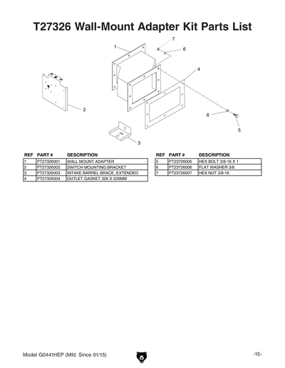

220
INTAKE BARREL BRACE, EXTENDED
221
Now: PW06
FLAT WASHER 1/4
222
WALL MOUNT ADAPTER
223
TAP SCREW M4 X 12
224
Now: PS02
PHLP HD SCR 1/4-20 X 3/4
225
Now: PN05
HEX NUT 1/4-20
226
FILTER ADAPTER
227
Now: PB18
HEX BOLT 3/8-16 X 1
228
PULL WIRE RAIL COVER
$58.00
228-1
WIRE/CORD/CORD COVER W/HANDLES
$57.10
229
Now: PB05
HEX BOLT 1/4-20 X 3/4
230
HEPA FILTER HOUSING
230-1
HEPA FILTER OUTER
230-2
HEPA Filter for G0441
230-3
HEPA FILTER CAGE 595 X 595, GREEN
$362.25
230-4
BAG CLAMP 545MM V2.11.09
230-5
HEPA FILTER BOTTOM PLATE
231
DRUM LID PVC RUBBER SEAL 2M
232A
HEPA Filter Kit for G0441 Dust Collector
301

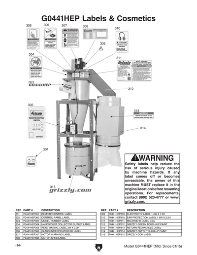

REMOTE CONTROL LABEL
302
CONTROL PANEL LABEL
303
MODEL NUMBER LABEL
304
HANDS/DUST COLLECTOR OUTLET 2W X 3.3H
305
306
GLASSES/RESPIRATOR DC 2W X 3.3H
307
MOTOR WARNING LABEL
308
MOTOR SPEC LABEL
309
ELECTRICITY 1.4W X 1.2H
310
EAR PROTECTION 1.5W X 2.5H
311
MACHINE ID LABEL CSA
312
N/S GRIZZLY GREEN G1023S
313
RETURN RED HANDLE LABEL
314
GREY PUTTY REF G0504
315
GRIZZLY.COM LABEL
