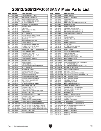

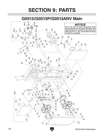

LIFTING EYE BOLT M10-1.5
*DISCD*MACHINE BODY
SET SCREW M5-.8 X 5
Now: PW03M
FLAT WASHER 6MM
POWER CORD 14G 3W 72"
Now: PN01M
HEX NUT M6-1
POINTER
11-1
BLADE TENSION SCALE LABEL
STEP SCREW M4-.7 X 5
HINGE SHAFT
ROLL PIN 5 X 36
UPPER WHEEL SHAFT HINGE
UPPER WHEEL SHAFT
BUSHING
BALL BEARING 6204-2RS
UPPER WHEEL 17"
Now: PR25M
INT RETAINING RING 47MM
WHEEL FLAT WASHER 8MM
Now: PB26M
HEX BOLT M8-1.25 X 30
SAW BLADE 131.5" X 1/2" 6TPI HOOK
LOCK WASHER 8MM
Now: PB29M
HEX BOLT M6-1 X 30
Urethane Tire for 17" Bandsaws (Pair)
LOWER WHEEL 17"
LOWER WHEEL PULLEY
Now: PN32
HEX NUT 1-14
Now: PLW09
LOCK WASHER 1"
MOTOR CORD 14G 3W
COMPRESSION SPRING 7 X 8 X 90
ROLL PIN 3 X 16
ALIGNMENT PLATE
THRUST BEARING 51201
2-BUTTON POWER SWITCH
HANDWHEEL TYPE-17 137D X 10B-S
***USE P0640X038***
FLANGE SCREW M5-.8 X 10
EXT TOOTH WASHER 5MM
Now: PN06M
HEX NUT M5-.8
FLANGE SCREW M5-.8 X 16
SWITCH BACK PLATE
Now: PB03M
HEX BOLT M8-1.25 X 16
45
Now: PW01M
FLAT WASHER 8MM
46
UPPER WHEEL SLIDING BRACKET
Now: PB10M
HEX BOLT M6-1 X 25
48
CONTACT PLT-TUNGSTEN 5HP OR LESS
49
CENT SWITCH 5/8-1725
50
CLEAR WINDOW
55A
UPPER WHEEL COVER ASSY
56
Now: PB04M
HEX BOLT M6-1 X 10
57
Now: PW03M
FLAT WASHER 6MM
58
***USE P0566B032***
59
Now: PB10M
HEX BOLT M6-1 X 25
60
STAR KNOB
61
LOCK NUT M6-1
62
STRAIN RELIEF TYPE-1 5/8
63
HEIGHT POINTER
64
Now: PN03M
HEX NUT M8-1.25
65
Now: PB45M
HEX BOLT M8-1.25 X 100
66
STAR KNOB BOLT M10-1.5 X 20
67
***USE P0566007***
68
THREADED HANDLE M10-1.5
69
CAM
70
PILLOW BLOCK
71
HANDLE M12-1.75
72
LEVER
73
Now: PN09M
HEX NUT M12-1.75
74
LEVER HUB
75
CAP SCREW M8-1.25 X 20
76
LOCK WASHER 8MM
77
LOCK WASHER 8MM
78
SHAFT COVER
79
SET SCREW M8-1.25 X 20
80
Now: PN03M
HEX NUT M8-1.25
81
LOWER WHEEL SHAFT
82
MOTOR 2HP 110/220V 1-PH V1
82-1
MOTOR FAN COVER V1
82-10
BALL BEARING 6203ZZ
82-11
BALL BEARING 6205ZZ
82-2
MOTOR FAN V1
82-3V2
S CAPACITOR 300M 250V 1-1/2 X 2-3/8
82-4
S CAPACITOR COVER V1.07.02
82-5V2
R CAPACITOR 40M 250V 1-1/2 X 2-3/4
82-6
R CAPACITOR COVER V1
82-7
MOTOR JUNCTION BOX V1
82-8
CENTRIFUGAL SWITCH W/CONT PLATE
82-9
82-9A
83
Now: PB95M
HEX BOLT M5-.8 X 16
84
LOCK WASHER 5MM
85
MOTOR MOUNT BRACKET
86
87
STRAIN RELIEF PLATE 2-HOLE
88
89
PILLOW BLOCK
90
Now: PK15M
KEY 5 X 5 X 35
91
Now: PB81M
HEX BOLT M8-1.25 X 20 LH
92
MOTOR PULLEY TYPE-A 3.5"
93
Now: PVA42
V-BELT A42
94
Now: PB04M
HEX BOLT M6-1 X 10
95
LOWER WHEEL COVER
$86.30
96
Now: PW01M
FLAT WASHER 8MM
97
Now: PW01M
FLAT WASHER 8MM
98
CAP SCREW M10-1.5 X 35
99
Now: PN02M
HEX NUT M10-1.5

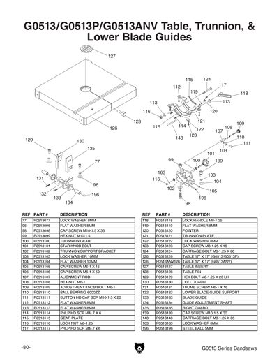

100
TRUNNION GEAR
STAR KNOB BOLT
TRUNNION SUPPORT BRACKET
LOCK WASHER 10MM
Now: PW04M
FLAT WASHER 10MM
CAP SCREW M6-1 X 15
106
CAP SCREW M6-1 X 50
107
ALIGNMENT ROD
108
Now: PN01M
HEX NUT M6-1
109
ADJUSTMENT KNOB BOLT M6-1
110
BALL BEARING 6000ZZ
111
BUTTON HD CAP SCR M10-1.5 X 20
112
Now: PW01M
FLAT WASHER 8MM
113
Now: PW01M
FLAT WASHER 8MM
114
Now: PS17M
PHLP HD SCR M4-.7 X 6
115
GEAR PLATE
116
LOCK NUT M8-1.25
117
Now: PS17M
118
LOCK HANDLE M8-1.25
119
Now: PW01M
FLAT WASHER 8MM
120
POINTER
121
***USE P0513X051***
122
LOCK WASHER 8MM
123
CAP SCREW M8-1.25 X 16
124

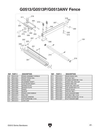

CARRIAGE BOLT M8-1.25 X 80
125
FENCE ASSEMBLY W/RAILS
126
TABLE 17" X 17"
127
Table Insert for G0555X, G0457, G0513 Series, G0514 Series and G0640X
128
TABLE PIN
129
Now: PB81M
130
LEFT GUARD
131
THUMB SCREW M6-1 X 16
132
LOWER BLADE GUIDE SUPPORT
133
BLADE GUIDE
134
GUIDE ADJUSTMENT SHAFT
135
RIGHT GUARD
136
CAP SCREW M8-1.25 X 80
137
Now: PW01M
FLAT WASHER 8MM
138
UPPER BLADE GUARD

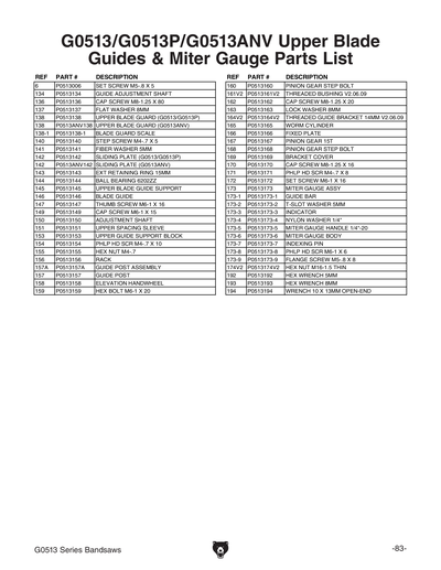

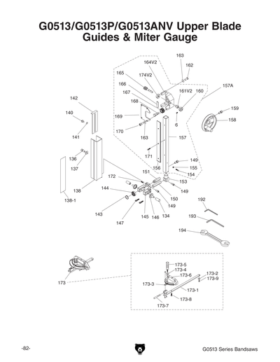

138-1
BLADE GUARD SCALE
139
CAP SCREW M10-1.5 X 30
140
141
FIBER WASHER 5MM
142
SLIDING PLATE
143
Now: PR05M
EXT RETAINING RING 15MM
144
BALL BEARING 6202ZZ
145
UPPER BLADE GUIDE SUPPORT
146
BLADE GUIDE
147
148
CARRIAGE BOLT M8-1.25 X 85
149
CAP SCREW M6-1 X 15
150
ADJUSTMENT SHAFT
151
UPPER SPACING SLEEVE
152
Now: PB08M
HEX BOLT M6-1 X 20
153
UPPER GUIDE SUPPORT BLOCK
154
Now: PS38M
PHLP HD SCR M4-.7 X 10
155
Now: PN04M
HEX NUT M4-.7
156
RACK
157
GUIDE POST
157A
GUIDE POST ASSEMBLY
158
HANDWHEEL TYPE-17 137D X 10B-S X M10-1.5
159
Now: PB08M
HEX BOLT M6-1 X 20
160
***USE P0640X129***
161V2
THREADED BUSHING V2.06.09
162
163
LOCK WASHER 8MM
164V2
GUIDE BRACKET 16MM V2.06.09
165
***USE P0566196***
166
FIXED PLATE
167
PINION GEAR 15T
168
***USE P0568239***
169
BRACKET COVER
170
171
Now: PS07M
PHLP HD SCR M4-.7 X 8
172
SET SCREW M6-1 X 16
173
***USE P0513X152***
173-1
GUIDE BAR
173-2
*DISCD*T-SLOT WASHER 8MM BLACK
173-3
*DISCD*INDICATOR
173-4
***USE P0513X152***
173-5
MITER GAUGE HANDLE 1/4"-20
173-6
MITER GAUGE BODY
173-7
***USE P0513X152***
173-8
Now: PS37M
PHLP HD SCR M6-1 X 6
173-9
FLANGE SCREW M5-.8 X 8
174
BUSHING W/ HEX NUT V2.04.19
174V2
175
Now: PB08M
HEX BOLT M6-1 X 20
176
BUSHING

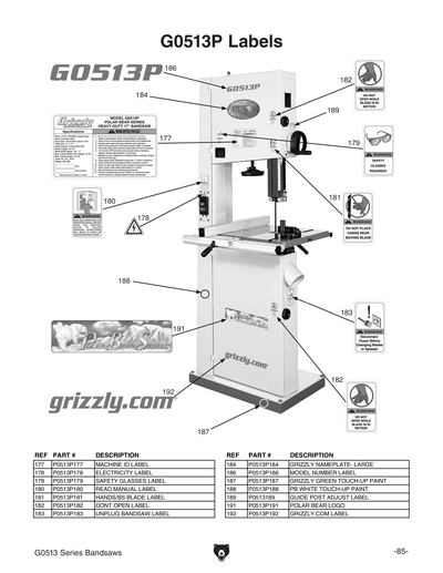

177
MACHINE ID LABEL
178
ELECTRICITY 1.4W X 1.2H
179
180
181
***USE PLABEL-19A***
182
DONT OPEN 2W X 3.3H
183
UNPLUG BANDSAW 2W X 3.3H
184
Now: G8588
Nameplate - Small
185
SAW TENSION LABEL
186
MODEL NUMBER LABEL
$5.55
187
N/S GRIZZLY GREEN G1023S
188
POLAR BEAR WHITE TOUCH-UP PAINT
189
GUARD ADJ LABEL
190
BS BLADE ENCLOSURE LABEL
191
POLAR BEAR LOGO-LARGE 9.5W X 2.5H
192
GRIZZLY.COM LABEL
$5.25
193
HEX WRENCH 8MM
194
WRENCH 10 X 13MM OPEN-ENDS
195
PATENT LABEL 1-3/16 X 1-3/4"W
201
FRONT FENCE RAIL
202
***USE P0555302***
203
ALIGNMENT SHAFT
204
***USE P0555304***
205
SPRING PLATE
206
SPACER PLATE
207
FENCE
208
SLEEVE
209
***USE P0817121-9***
210
***USE P0640X121-10***
211
CONVEX WINDOW
212
CAP SCREW M6-1 X 55
213
LOCK CAM
214
REAR FENCE RAIL
215
Now: PN01M
HEX NUT M6-1
216
FLANGE SCREW M4-.7 X 6
217
***USE P0555XH217***
218
FENCE END CAP
219
REAR RAIL END CAP
220
TAP SCREW M3.5 X 8
221
FENCE SCALE
222
Now: PN01M
HEX NUT M6-1
223
LOCK WASHER 6MM
225
Now: PB08M
HEX BOLT M6-1 X 20
226
FLANGE SCREW M4-.7 X 10
227
Now: PW03M
FLAT WASHER 6MM
