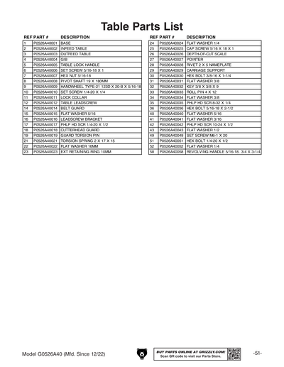

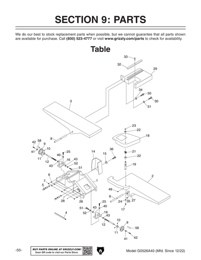

OUTFEED/ INFEED TABLE/ BASE ASSY
$1,612.05
GIB
TABLE LOCK HANDLE
$10.30
Now: PSS01
SET SCREW 5/16-18 X 1
Now: PN02
HEX NUT 5/16-18
PIVOT SHAFT 19 X 178MM
HANDWHEEL TYPE-21 123D X 20-B X 5/16-18
Now: PSS11
SET SCREW 1/4-20 X 1/4
LOCK COLLAR
OUTFEED TABLE LEADSCREW
BELT GUARD
Now: PW07
FLAT WASHER 5/16
LEADSCREW BRACKET
Now: PS04
PHLP HD SCR 1/4-20 X 1/2
CUTTERHEAD GUARD V2.12.22
GUARD SHAFT V2.12.22
TORSION SPRING 2 X 17 X 15 V2.12.22
Now: PW04M
FLAT WASHER 10MM
Now: PR01M
EXT RETAINING RING 10MM
Now: PW06
FLAT WASHER 1/4
CAP SCREW 5/16-18 X 1
DEPTH-OF-CUT SCALE
POINTER
RIVET 2 X 5 NAMEPLATE
$1.60
CARRIAGE SUPPORT
Now: PB24
HEX BOLT 3/8-16 X 1-1/4
Now: PW02
FLAT WASHER 3/8
KEY 3/8 X 3/8 X 9 W/HOLE
ROLL PIN 4 X 12
Now: PW02
FLAT WASHER 3/8
Now: PS23
PHLP HD SCR 8-32 X 1/4
Now: PB23
HEX BOLT 5/16-18 X 2-1/2
Now: PW07
FLAT WASHER 5/16
Now: PW03
FLAT WASHER #10
Now: PS01
PHLP HD SCR 10-24 X 1/2
Now: PW01
FLAT WASHER 1/2
49
SET SCREW M6-1 X 20
51
Now: PB19
HEX BOLT 1/4-20 X 1/2
52
Now: PW06
FLAT WASHER 1/4
58
REVOLVING HANDLE 5/16-18, 3/4 X 3-1/4

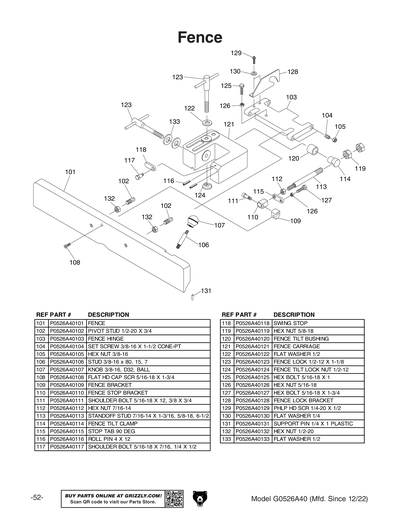

FENCE
PIVOT STUD 1/2-20 X 5/8
FENCE HINGE
SET SCREW 3/8-16 X 1-1/2 CONE-PT
Now: PN08
HEX NUT 3/8-16
106
TILT LEVER
107
KNOB
108
FLAT HD CAP SCR 5/16-18 X 1-5/8
109
FENCE BRACKET
110
FENCE STOP BRACKET
111
SHOULDER BOLT 5/16-18 X 112, 3/8 X 3/4
112
Now: PN19
HEX NUT 7/16-14
113
STANDOFF STUD 7/16-14 X 1-1/4, 5/8-18,
114
FENCE TILT CLAMP
115
STOP TAB-90 DEG
116
ROLL PIN 4 X 12
117
SHOULDER BOLT 5/16-18 X 3/8, 1/4 X 3/8
118
SWING STOP
119
Now: PN09
HEX NUT 5/8-18
120
FENCE TILT BUSHING
121
FENCE CARRIAGE
122
Now: PW01
FLAT WASHER 1/2
123
FENCE LOCK 1/2-12 X 1-1/8
124
FENCE TILT LOCK NUT 1/2-12
125
Now: PB03
HEX BOLT 5/16-18 X 1
126
Now: PN02
HEX NUT 5/16-18
127
Now: PB22
HEX BOLT 5/16-18 X 1-3/4
128
FENCE LOCK BRACKET
129
Now: PS04
130
Now: PW06
FLAT WASHER 1/4
131
SUPPORT PIN 1/4 X 1/2 (PLASTIC)
132
Now: PN01
HEX NUT 1/2-20
133
Now: PW01
FLAT WASHER 1/2

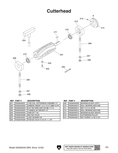

201
V-HELICAL CUTTERHEAD ASSEMBLY 6"
202
Now: H9893
Indexable Carbide Insert - 15 x 15 x 2.5mm, 10-Pk.
203
FLAT HD TORX T20 M6-1 X 15
204
T-HANDLE BIT DRIVER 1/4"
205
Now: PBT01
TORX BIT T-20
206
Now: PN11
HEX NUT 3/8-24
207
Now: PLW04
LOCK WASHER 3/8
208
STUD-SE 3/18-16 X 3-1/2, 3/4"
209
BEARING BLOCK (LEFT)
210
BALL BEARING 6202-2RS
211
KEY 5 X 5 X 30 RE
212
BALL BEARING 6203-2RS
213
BEARING BLOCK (RIGHT)
214
CUTTERHEAD PULLEY
215
Now: PSS03
SET SCREW 1/4-20 X 3/8

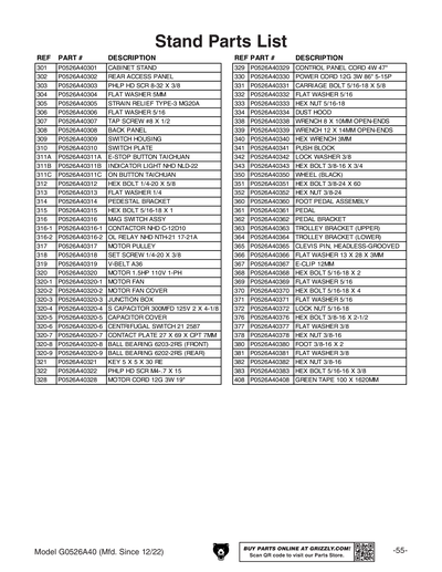

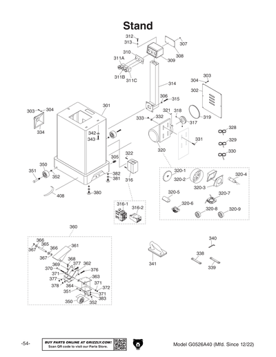

301
CABINET STAND
$360.50
302
REAR ACCESS PANEL
$49.25
303
Now: PS24
PHLP HD SCR 8-32 X 3/8
304
Now: PW02M
FLAT WASHER 5MM
305
STRAIN RELIEF TYPE-3 MG20A
$6.40
306
Now: PW07
FLAT WASHER 5/16
307
TAP SCREW #8 X 1/2
308
BACK PANEL
$11.50
309
SWITCH HOUSING
310
SWITCH PLATE
$5.90
311A
E-STOP BUTTON TAICHUAN
$101.45
311B
INDICATOR LIGHT NHD NLD-22 110/220V
$15.45
311C
ON BUTTON TAICHUAN 110/220V
$71.60
312
Now: PB02
HEX BOLT 1/4-20 X 5/8
313
Now: PW06
FLAT WASHER 1/4
314
PEDESTAL BRACKET
$85.20
315
Now: PB03
316
MAG SWITCH ASSY 110V
$244.55
316-1
CONTACTOR NHD C-09D 220V
316-2
OL RELAY NHD NTH-21 17-21A
$69.15
316X
MAG SWITCH ASSY 220V
$155.80
316X-1
316X-2
OL RELAY NHD NTH-11 8-11A
$60.20
317
MOTOR PULLEY
318
Now: PSS03
319
Now: PVA36
V-BELT A36
320
MOTOR 1.5HP 110/220V 1-PH
$539.80
320-1
MOTOR FAN
$14.25
320-2
MOTOR FAN COVER
$19.35
320-3
JUNCTION BOX
$10.90
320-4
S CAPACITOR 300MFD 125V 2 X 4-1/8
$18.15
320-5
CAPACITOR COVER
$9.10
320-6
CENTRIFUGAL SWITCH 21 2587
$10.90
320-7
CONTACT PLATE 27 X 69 X CPT 7MM
$12.10
320-8
320-9
321
KEY 5 X 5 X 30 RE
322
Now: PS01
323
MOTOR MOUNT PLATE
$22.40
328
MOTOR CORD 12G 3W 19" V1
$73.40
328V2
MOTOR CORD 14G 3W 19" V2.03.23
$18.15
329
CONTROL PANEL CORD 4W 47"
$68.85
330
POWER CORD 12G 3W 86" 5-15P V1
$37.75
330V2
POWER CORD 14G 3W 86" 5-15P V2.03.23
$46.65
331
Now: PCB01
CARRIAGE BOLT 5/16-18 X 5/8
332
Now: PW07
FLAT WASHER 5/16
333
Now: PN02
HEX NUT 5/16-18
334
Now: W1001
Jointer Dust Hood
338
WRENCH 8 X 10MM OPEN-ENDS
339
WRENCH 12 X 14MM OPEN-ENDS
340
HEX WRENCH 3MM
341
PUSH BLOCK
342
Now: PLW04
LOCK WASHER 3/8
343
Now: PB21
HEX BOLT 3/8-16 X 3/4
350
WHEEL (BLACK) V2.03.19
351
HEX BOLT 3/8-24 X 60
$3.40
352
Now: PN11
HEX NUT 3/8-24
360
FOOT PEDAL ASSEMBLY V2.03.19
361
PEDAL
362
PEDAL BRACKET
363

366
*DISCD*FLAT WASHER 13 X 27 X 3MM
367
E-CLIP 12MM
368
Now: PB06
369
Now: PW07
FLAT WASHER 5/16
370
Now: PB121
HEX BOLT 5/16-18 X 4
371
Now: PW07
FLAT WASHER 5/16
372
Now: PLN03
LOCK NUT 5/16-18
376
Now: PB35
HEX BOLT 3/8-16 X 2-1/2
377
Now: PW02
FLAT WASHER 3/8
378
Now: PN08
HEX NUT 3/8-16
380
FOOT 3/8-16 X 2
$2.45
381
Now: PW02
FLAT WASHER 3/8
382
Now: PN08
HEX NUT 3/8-16
383
Now: PB15
HEX BOLT 5/16-18 X 3/8
408
GREEN TAPE 100 X 1620MM
$15.20

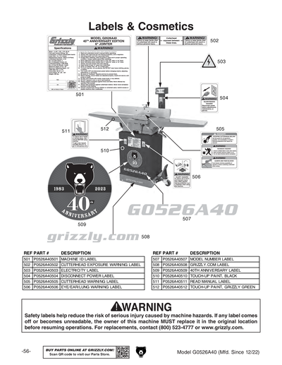

501
MACHINE ID LABEL V1
$16.40
501V2
MACHINE ID LABEL V2.03.23
$6.95
502
CUTTERHEAD EXPOSURE WARNING LABEL
503
ELECTRICITY 1.4W X 1.2H
504
DISCONNECT 110V 1.5W X 2.5H
505
CUTTERHEAD WARNING LABEL
$2.90
506
EYE/EAR/LUNG 1.5W X 2.5H
507
MODEL NUMBER LABEL
$16.40
508
GRIZZLY.COM LABEL 6",GOLD
509
40TH ANNIVERSARY LABEL
$7.60
510
ANNIV EDITION BLACK REF G0555LANV
511
READ MANUAL 1.5W X 2.5H
512
N/S GRIZZLY GREEN G1023S
