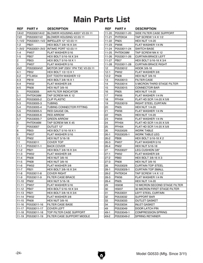

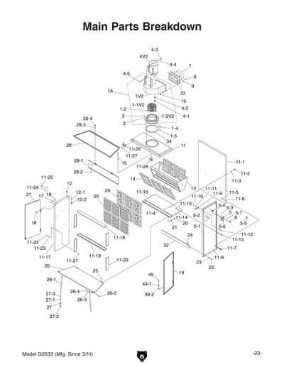

EXHAUST FAN HOUSING V1
1-1
*DISCD*IMPELLER 12" V1
1-1V2
*DISCD*IMPELLER 12" V2.03.11
1-2
Now: PB21
HEX BOLT 3/8-16 X 3/4
1-3
INTAKE PORT V1
1-3V2
INTAKE PORT V2.03.11
1-4
Now: PW07
FLAT WASHER 5/16
1-5
Now: PB07
HEX BOLT 5/16-18 X 3/4
1AV2
BLOWER HOUSING ASSY V2.03.11
$845.25
1V2
BLOWER HOUSING V2.03.11
Now: PB03
HEX BOLT 5/16-18 X 1
Now: PW07
FLAT WASHER 5/16
*DISCD*MOTOR E81J1409M-GG V1
4-1
Now: PB52
HEX BOLT 1/2-13 X 1
4-2
EXT TOOTH WASHER 1/2
4-3
Now: PB18
HEX BOLT 3/8-16 X 1
4-4
Now: PW02
FLAT WASHER 3/8
4V2
EXPLOSION PROOF MOTOR 3HP 230V 1-PH
$2,288.25
AIR FILTER INDICATOR
5-1
TAP SCREW M4 X 12
5-2
5-3
5-4
5-5
5-6
5-7
TAP SCREW M4 X 45
OUTLET 12"
Now: PB07
Now: PW07
FLAT WASHER 5/16
Now: PN02
HEX NUT 5/16-18
COVER TOP
11-1
BACK COVER
11-10
Now: PN02
HEX NUT 5/16-18
11-11
Now: PW07
FLAT WASHER 5/16
11-12
Now: PB07
11-13
Now: PB21
11-14
Now: PW02
FLAT WASHER 3/8
11-15
Now: PN08
HEX NUT 3/8-16
11-16
FILTER CASE BASE
11-17
COVER LEFT
11-18
TOP FILTER CASE SUPPORT
11-19
FILTER CASE SUPPORT MIDDLE
11-2
Now: PB21
11-20
SIDE FILTER CASE SUPPORT
11-21
TAP SCREW 1/4 X 1/2
11-22
Now: PN05
HEX NUT 1/4-20
11-23
Now: PW06
FLAT WASHER 1/4
11-24
SWITCH BASE
11-25
TAP SCREW M4 X 12
11-26
CURTAIN BRACE LEFT
11-27
Now: PB07
11-28
CURTAIN BRACE RIGHT
11-3
Now: PW02
FLAT WASHER 3/8
11-4
Now: PN08
HEX NUT 3/8-16
11-5
Now: PN08
HEX NUT 3/8-16
11-6
Now: PW02
FLAT WASHER 3/8
11-7
Now: PB21
11-8
COVER RIGHT
11-9
FILTER CASE BRACE
HOOK 3/8 - 16
12-1
Now: PW02
FLAT WASHER 3/8
12-2
Now: PN08
HEX NUT 3/8-16
FILTER CASE
Now: H5839
5-Micron Third-Stage Filter
CONNECTOR BAR
$9.20
Now: PN05
HEX NUT 1/4-20
Now: PW06
FLAT WASHER 1/4
Now: PFH04
FLAT HD SCR 1/4-20 X 5/8
RIGHT STEEL CURTAIN
Now: PN05
HEX NUT 1/4-20
Now: PW06
FLAT WASHER 1/4
Now: PN05
HEX NUT 1/4-20
Now: PW06
FLAT WASHER 1/4
Now: PFH05
FLAT HD SCR 1/4-20 X 3/4
Now: PFH04
WORK TABLE
26-1
WORK TABLE LEG
26-2
Now: PB06
HEX BOLT 5/16-18 X 2
26-3
Now: PW07
FLAT WASHER 5/16
26-4
Now: PN02
HEX NUT 5/16-18
LEG CUSHION 3/8"
27-1
Now: PW02
FLAT WASHER 3/8
27-2
Now: PB60
HEX BOLT 3/8-16 X 3
27-3
Now: PN08
HEX NUT 3/8-16
CURTAIN TOP STEEL
28-1
CURTAIN TOP SMALL
28-2
TAP SCREW 1/4 X 1/2
28-3
Now: PW06
FLAT WASHER 1/4
28-4
Now: PN05
HEX NUT 1/4-20
Now: H5838
1-Micron Second-Stage Filter
Now: H5837
30-Micron First-Stage Filter
LEFT STEEL CURTAIN
SUPPORT BAR
OUTLET GASKET
$5.50
INLET GASKET

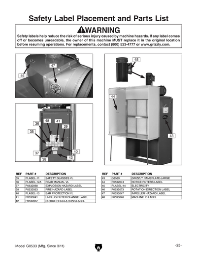

EXPLOSION HAZARD LABEL
FIRE HAZARD LABEL
EAR PROTECTION LABEL
EAR PROTECTION 2W X 3.3H V2.04.08
UNPLUG FILTER CHANGE LABEL
Now: G8589
Nameplate - Large
NOTICE FILTERS LABEL
45
ELECTRICITY 1.4W X 1.2H
46
ROTATION DIRECTION LABEL
IMPELLER HAZARD LABEL
48
MACHINE ID LABEL
49
DOOR LATCH PIN
49-1
COMPRESSION SPRING
49-2
SPRING RETAINER
60
61
62
63
64
