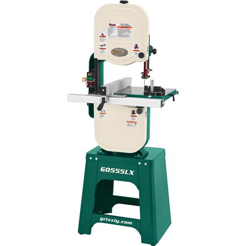

The G0555LX 14" 1 HP Deluxe Bandsaw is an upgraded version of the popular G0555 model, boasting several improvements for enhanced control and precision. Unlike the base model, the G0555LX offers an increased table tilting capacity of 15 degrees to the left for angled cuts. Cast-iron wheels maintain steadier blade speed under load than aluminum wheels do. The upgraded T-shaped fence on the LX model features rack-and-pinion guide post adjustment for smooth and accurate blade tracking, a significant improvement over the base model's fence system.
The bandsaw operates with minimal vibration for precision cutting thanks to the cast-iron frame and heavy-duty stand. The T25555 Riser Block Kit is available to increase the capacity of this bandsaw from 6" to 12". For a full range replacement and resaw blades for the G0555LX with and without the riser block, shop here.
For enhanced safety, the G0555LX has a lockable switch with padlock provision. Prewired for 110V, the G0555LX can plug into a standard 110V wall receptacle. This machine can be converted to run on 220V by referring to the voltage conversion instructions in the manual.
The easy-to-read G0555LX manual was written by our U.S.-based Technical Documentation Department and is packed with useful information.

- Motor: 1 HP, 110V/220V (prewired 110V), single-phase, 11A/5.5A
- Throat (max. width left of blade): 13-1/2"
- Resaw capacity: 6"
- Table size: 14" x 14"
- Table tilt: 10° left, 45° right
- Floor-to-table height: 43"
- Blade size: 93-1/2" (1/8"–3/4" wide)
- Blade speed: 1800, 3100 FPM
- Overall dimensions: 27" W x 30" D x 67-1/2" H
- Approximate shipping weight: 238 lbs.
- Precision-ground cast-iron table
- Cast-iron frame
- Computer-balanced cast-iron wheels with rubber tires
- Sturdy T-shape fence design
- Extruded-aluminum fence
- Lockable switch with padlock provision
- 3/8" 6-TPI hook blade
- Miter gauge
- 1-year limited warranty
