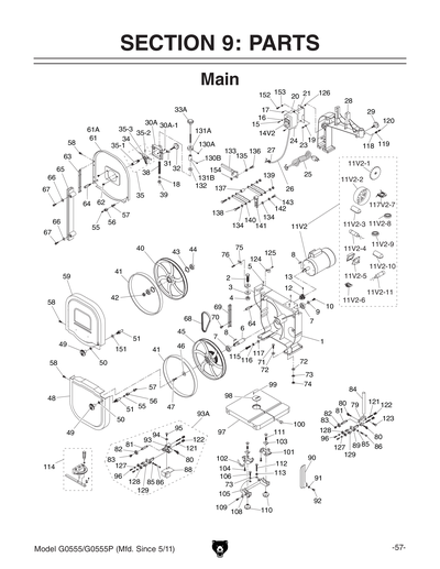

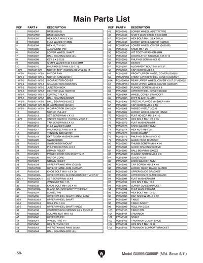

BASE
Now: PB80M
HEX BOLT M16-2 X 55
Now: PW08M
FLAT WASHER 16MM
Now: PN13M
HEX NUT M16-2
ALIGNMENT PIN
LOWER WHEEL SHAFT
BALL BEARING 6204-2RS
Now: PK23M
KEY 5 X 5 X 25
SHAFT WASHER 30 X 8 X 3MM
Now: PS16M
PHLP HD SCR M8-1.25 X 16
11V2
MOTOR 1HP 110V/220V 1-PH V2.05.11
11V2-1
MOTOR FAN V2.05.11
11V2-10
S CAPACITOR COVER V2.05.11
11V2-11
R CAPACITOR 20M 250V 1-1/2 X 1-1/4 V2.05
11V2-2
MOTOR FAN COVER V2.05.11
11V2-3
11V2-4
S CAPACITOR 200M 250V 1-1/2 X 2-3/4 V2.0
11V2-5
JUNCTION BOX V1
11V2-6
CENTRIFUGAL SWITCH W/CONTACT PLATE V2.05.11
11V2-7
***USE P0555011V2-7***
11V2-8
BALL BEARING 6202ZZ
11V2-9
BALL BEARING 6205ZZ
MOTOR PULLEY 5/8" BORE
SET SCREW M6-1 X 12
14V2
ON/OFF SWITCH 110/220V V2.05.11
TAP SCREW M3.5 X 12
Now: PW05M
FLAT WASHER 4MM
Now: PS40M
PHLP HD SCR M5-.8 X 16
TENSION INDICATOR
EXT TOOTH WASHER 5MM
SWITCH BOX
SWITCH BOX MOUNT
Now: PS19M
PHLP HD SCR M5-.8 X 6
STRAIN RELIEF M15 TYPE-2
POWER CORD 16G 3C 6FT 5-15
25V2
MOTOR CORD
STRAIN RELIEF M13.5 TYPE-1 SNAP-IN
UPPER FRAME ARM
KNOB BOLT M10-1.5 X 30
30A
UPPER WHEEL SLIDING BRACKET V2.07.07
30A-1
SET SCREW M5-.8 X 8
WING NUT M8-1.25
KNOB BOLT M8-1.25 X 45
33A
ADJUSTMENT SCR ASSY 7" THREAD
STEEL PIN 8 X 23MM
UPPER WHEEL SHAFT HINGE ASSY
35-1
UPPER WHEEL SHAFT
35-2
ROLL PIN 4 X 24
35-3
COMPRESSION SPRING 3.8 X 13.5 X 81
SQUARE NUT M10-1.5
UPPER WHEEL ASSY.
Urethane Tire for 14" Bandsaws (Pair)
Now: PN24M
HEX NUT M12-1.25
Now: PR21M
INT RETAINING RING 35MM
BALL BEARING 6202-2RS
45
LOWER WHEEL ASSY W/TIRE
46
Now: PB81M
HEX BOLT M8-1.25 X 20 LH
48
LOWER WHEEL COVER
$46.30
49
***USE P0555X049***
50
INT TOOTH WASHER 8MM
51
***USE P0555X051***
55
Now: PS08M
PHLP HD SCR M5-.8 X 12
56
CATCH
57
ALIGNMENT BOLT M5-.8 X 27
58
TAP SCREW M4 X 8
59
*DISCD*FRONT UPPER WHEEL COVER
61
REAR UPPER WHEEL COVER
$37.10
62
FLANGE SCREW M5-.8 X 8
63
UPPER WHEEL COVER HINGE
64
WHEEL COVER STANDOFF-SE HEX
65
LEFT BLADE GUARD
66
Now: PW05M
FLAT WASHER 4MM
67
TAP SCREW M3.5 X 16
68
RIBBED V-BELT 200J5
69
LOWER WHEEL COVER HINGE
70
FLAT HD SCR M5-.8 X 10
71
Now: PB20M
HEX BOLT M8-1.25 X 35
72
Now: PW01M
FLAT WASHER 8MM
73
LOCK WASHER 8MM
74
Now: PN03M
HEX NUT M8-1.25
75
***USE P0555XH169***
76
Now: PS08M
79
GUIDE POST BRACKET
80
THUMB SCREW M6-1 X 16
81
GUIDE SPACING SLEEVE
82
BALL BEARING 6000ZZ
83
FLANGE SCREW M6-1 X 8
84
GUIDE POST
85
LOCK WASHER 5MM
86
CAP SCREW M5-.8 X 40
88
***USE P0580088***
89
UPPER GUIDE BRACKET
90
UPPER RIGHT BLADE GUARD
91
Now: PW03M
FLAT WASHER 6MM
92
Now: PB05M
HEX BOLT M6-1 X 8
93
LOWER GUIDE BRACKET
94
Now: PW03M
FLAT WASHER 6MM
95
Now: PB08M
HEX BOLT M6-1 X 20
96
CAP SCREW M5-.8 X 12
97

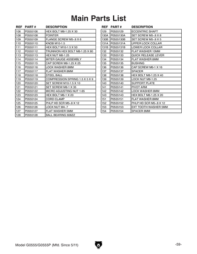

TABLE
98
Table Insert for G0580, G0555 and G0555P
99
ROLL PIN 3 X 8
100
TABLE PIN
TRUNNION
SCALE
TRUNNION CLAMP SHOE
Now: PB02M
HEX BOLT M6-1 X 12
TRUNNION SUPPORT BRACKET
106
Now: PB26M
HEX BOLT M8-1.25 X 30
108
***USE P0580108***
109
FLANGE SCREW M5-.8 X 6
110
KNOB M10-1.5
111
Now: PB73M
HEX BOLT M10-1.5 X 50
112
TRUNNION HEX BOLT M8-1.25 X 80
113
Now: PN03M
HEX NUT M8-1.25
114
MITER GAUGE ASSEMBLY
115
CAP SCREW M8-1.25 X 25
116
LOCK WASHER 8MM
117
Now: PW01M
FLAT WASHER 8MM
118
STEEL BALL 8MM
119
COMPRESSION SPRING 1.5 X 5 X 9
120
SET SCREW M10-1.5 X 10
121
SET SCREW M8-1 X 35
122
MICRO ADJUSTING NUT 1.65
123
Now: PB08M
HEX BOLT M6-1 X 20
124
CORD CLAMP
125
Now: PS08M
126
LOCK NUT M4-.7
127
Now: PW02M
FLAT WASHER 5MM
128
Now: G3845
Bearing - 22mm x 8mm
129
ECCENTRIC SHAFT
130A
SET SCREW M5-.8 X 8
130B
SET SCREW M5-.8 X 5
131A
UPPER LOCK COLLAR
131B
LOWER LOCK COLLAR
132
Now: PW04M
FLAT WASHER 10MM
133
***USE P0555X133***
134
Now: PW01M
FLAT WASHER 8MM
135
BUSHING
136
CAP SCREW M6-1 X 16
137
SPACER
138
Now: PB15M
HEX BOLT M8-1.25 X 40
139
LOCK NUT M8-1.25
140
SUPPORT PLATE
141
PIVOT ARM
142
LOCK WASHER 8MM
143
Now: PB09M
144
MACHINE ID LABEL V1
144V2

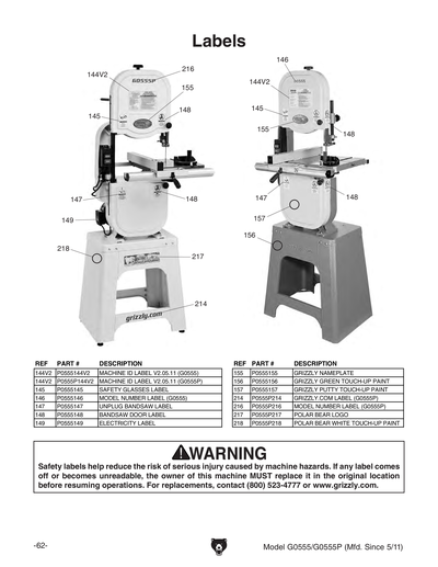

MACHINE ID LABEL V2.05.11 CSA
145
147
UNPLUG BANDSAW 2W X 3.3H
148
BANDSAW DOOR 2W X 3.3H
149
ELECTRICITY 1.4W X 1.2H
151
Now: PW01M
FLAT WASHER 8MM
152
Now: PS08M
153
154
SPACER 8MM
155
Now: G9987
Nameplate - Mini

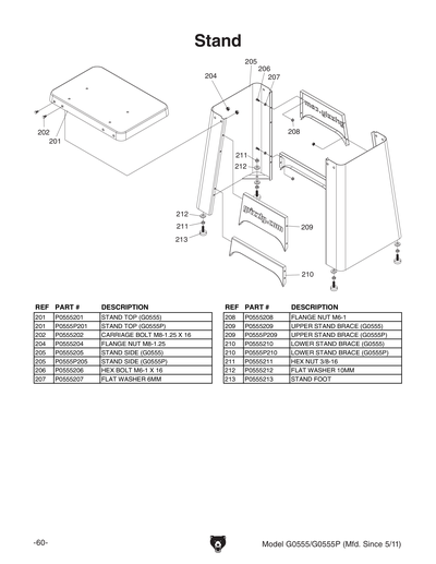

201
STAND TOP
202
CARRIAGE BOLT M8-1.25 X 16
204
FLANGE NUT M8-1.25
205
STAND SIDE
$133.10
206
Now: PB83M
HEX BOLT M6-1 X 16
207
Now: PW03M
FLAT WASHER 6MM
208
FLANGE NUT M6-1
209
UPPER STAND BRACE
$34.80
210
LOWER STAND BRACE
$26.75
211
Now: PN08
HEX NUT 3/8-16
212
Now: PW04M
FLAT WASHER 10MM
213
STAND FOOT
214
Now: G9987
Nameplate - Mini

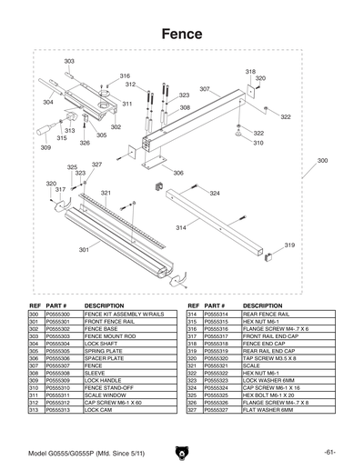

300
FENCE KIT ASSEMBLY W/RAILS
301
***USE P0555X201***
302
FENCE BASE
303
FENCE MOUNT ROD
304
LOCK SHAFT
305
SPRING PLATE
306
SPACER PLATE
307
FENCE
308
SLEEVE
309
***USE P0817121-9***
310
FENCE STAND-OFF
311
***USE P0640X121-11***
312
CAP SCREW M6-1 X 60
313
LOCK CAM
314
REAR FENCE RAIL
315
Now: PN01M
HEX NUT M6-1
316
FLANGE SCREW M4-.7 X 6
317
***USE P0555XH217***
318
FENCE END CAP
319
REAR RAIL END CAP
320
TAP SCREW M3.5 X 8
321
SCALE
322
Now: PN01M
HEX NUT M6-1
323
LOCK WASHER 6MM
324
CAP SCREW M6-1 X 16
325
Now: PB08M
HEX BOLT M6-1 X 20
326
FLANGE SCREW M4-.7 X 8
327
Now: PW03M
FLAT WASHER 6MM
